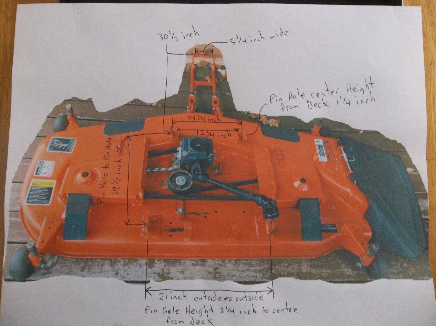

Anyone have a 60 inch mid mount mower deck for a B2601 they can take a few measurments off of?
My dealer, nor Kubota Canada can answer my question. I want to know if the RCK60-29 from my 2013 B2620 will fit on a B2601.
I know the deck model number and part number are different, and that they have changed the design of the anti-scalp wheels and how they adjust.
But to me, I don't see any major changes to the B2601 mechanically over the B2620.
The big "technical" answer I got from Kubota was "the RCK60-32 is compatible with the B2601 and the RCK60-29 is compatible with the B2620."
Thanks.

For anyone wondering, a member on the other Kubota forum went and measured his for me. He said it is the same other than the anti-scalp wheel design.
