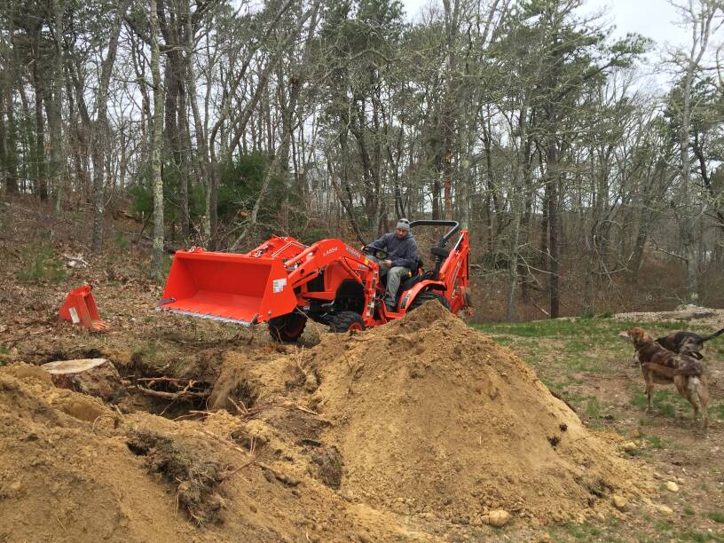

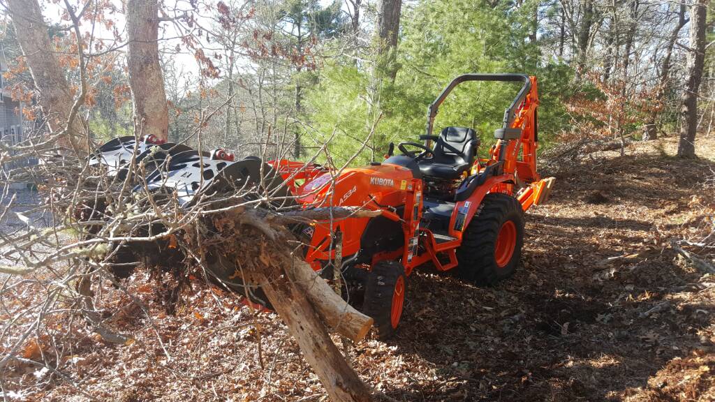

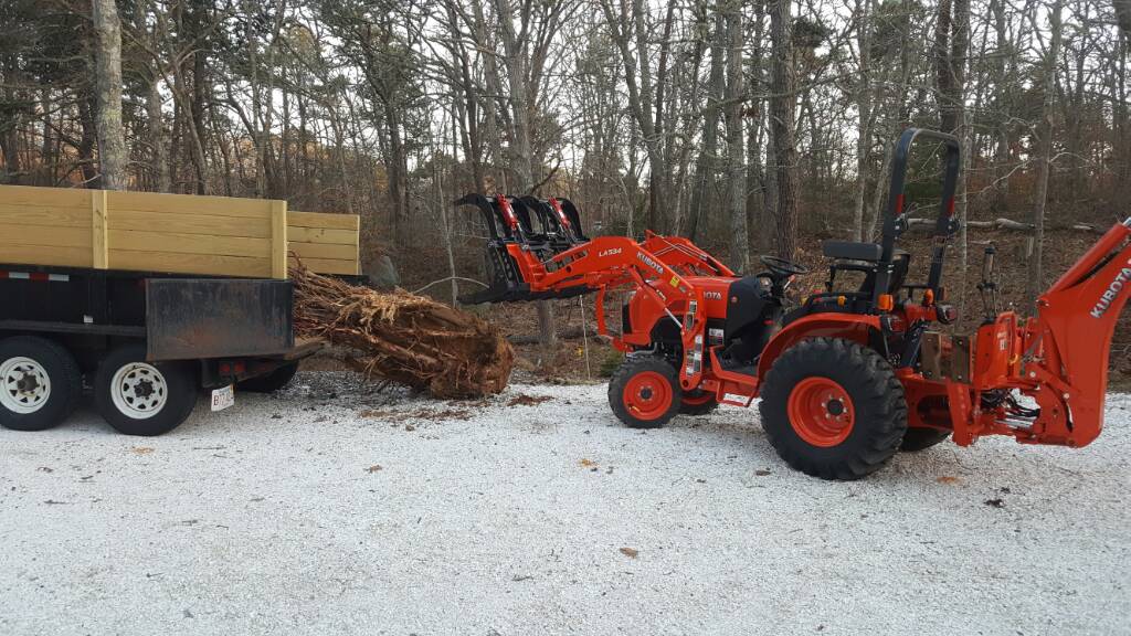

I bought a B2650 two weeks ago with FEL and BH. Its my first 4-wheel tractor (I have a BCS walking tractor). I was extremely impressed how maneuverable is is in the woods. I have been using it to move logs and brush and remove stumps. I had the tires loaded and i can't speak to mowing, but I'm very happy to have it. uploadfromtaptalk1461542609093.jpguploadfromtaptalk1461542631239.jpguploadfromtaptalk1461542651271.jpg
