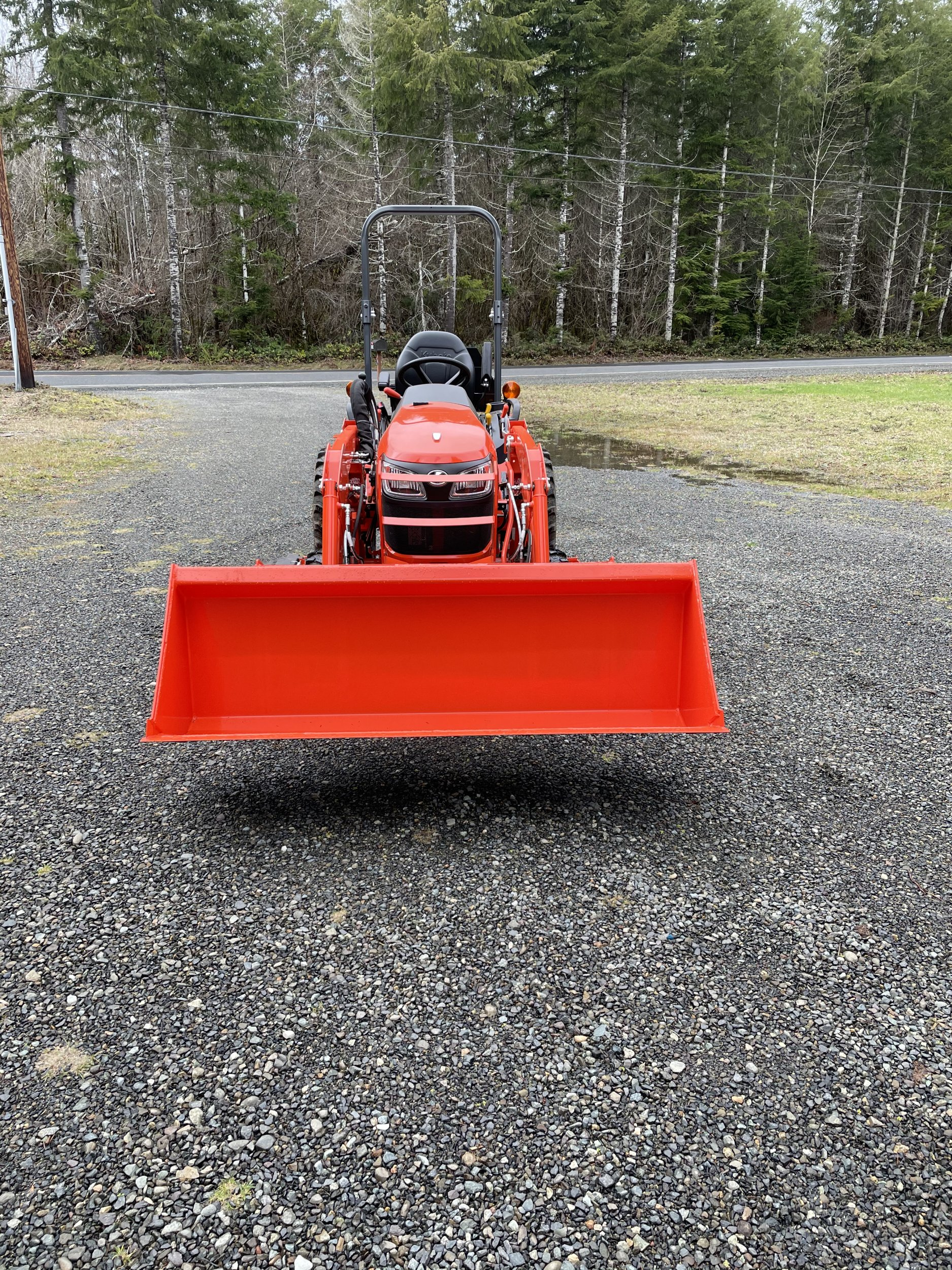

The bucket from the L won't fit on the B?
I’m assuming it will. Both my B2601 and L2501 have the Quick Attach Loader/Bucket. However, I would like the ability to use both Buckets on the L2501. I can’t do that if I have to store the B2601 Loader with a Bucket attached to the loader.
Mike

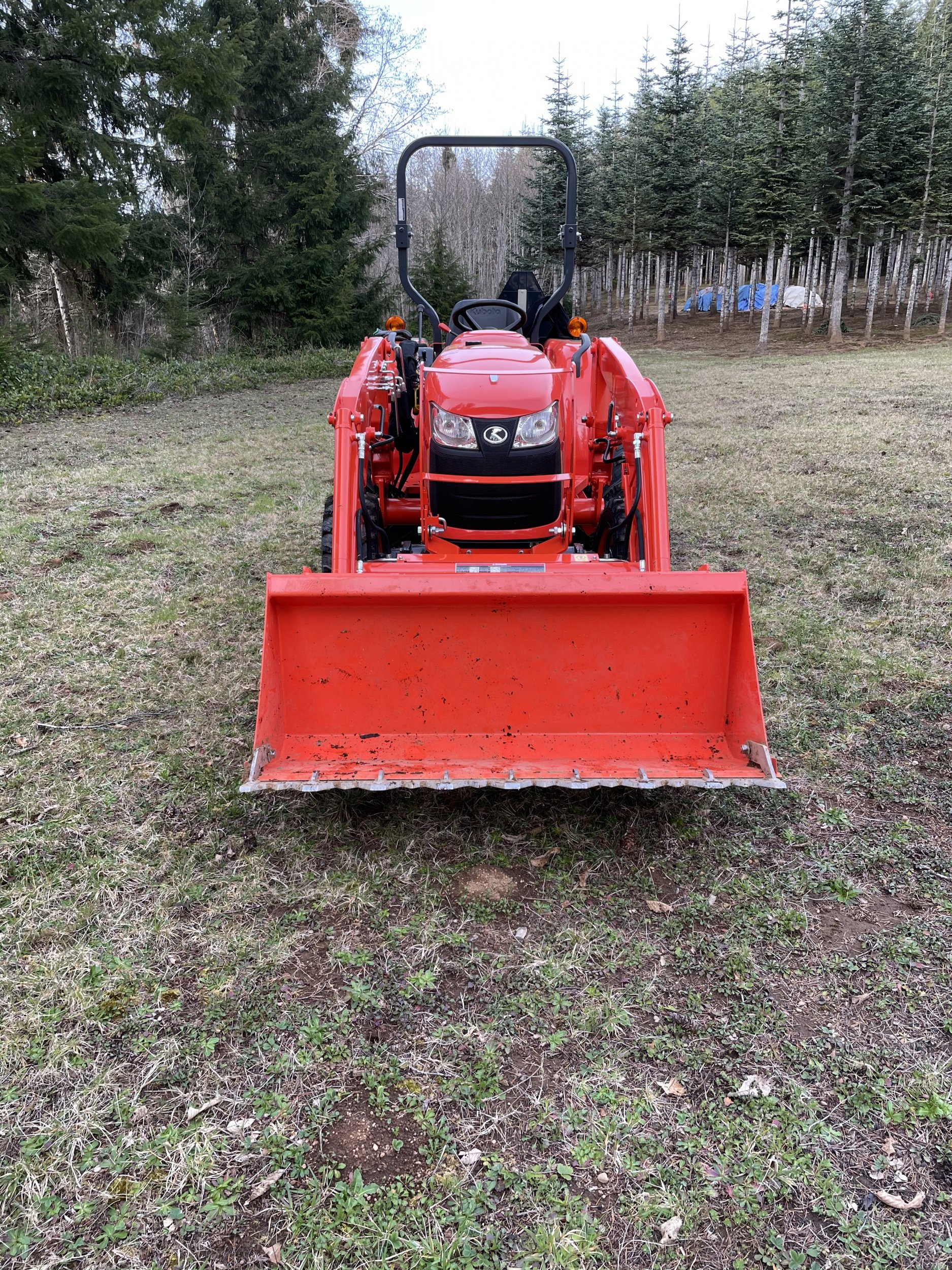

#12
I doubt it. The OP has a B. I have a BX, but I did forget to mention, I tried the same thing with my B2620.
I believe both Buckets will fit on either tractor. Both have the Quick Attach and I measured them at the dealership and they appear to be the same.
Mike

I'm curious to learn if it is possible to remove the Front End Loader without the Bucket attached and if the Loader assembly will remain stable if stored without the Bucket?
The reason I'm considering this, is because I don't plan on storing my B2601 with the Loader attached and I may want to use the smaller Bucket (with BX piranha tooth bar) on my L2501 for some tasks where a smaller Bucket might prove useful.
So, out of curiosity, has anyone successfully removed their Front End Loader without the Bucket attached and what was your experience?
Thanks,
Mike
Many things can be done with enough time and/or effort and this will require some of both because the bucket curl function is used to lift/lower the rear of the FEL frame during removal/installation.
SDT

   / B2601: Removing Front End Loader without the Bucket attached? #17
I tried this - without the bucket i could not move the loader into position and it was a disaster Lol
   / B2601: Removing Front End Loader without the Bucket attached? #18
B/L SSQA buckets are all but certain to interchange. That's why they call it "universal".
to the OP.
curl your SSQA plate out and position it flat on the ground before you dismount your loader. Throw a cement block on it and dismount the loader.
