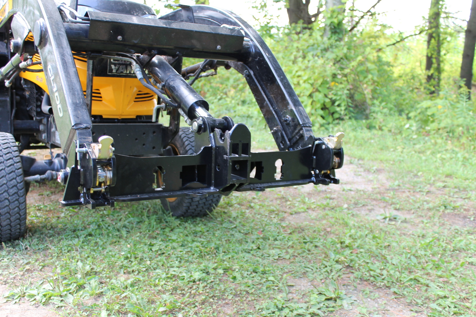

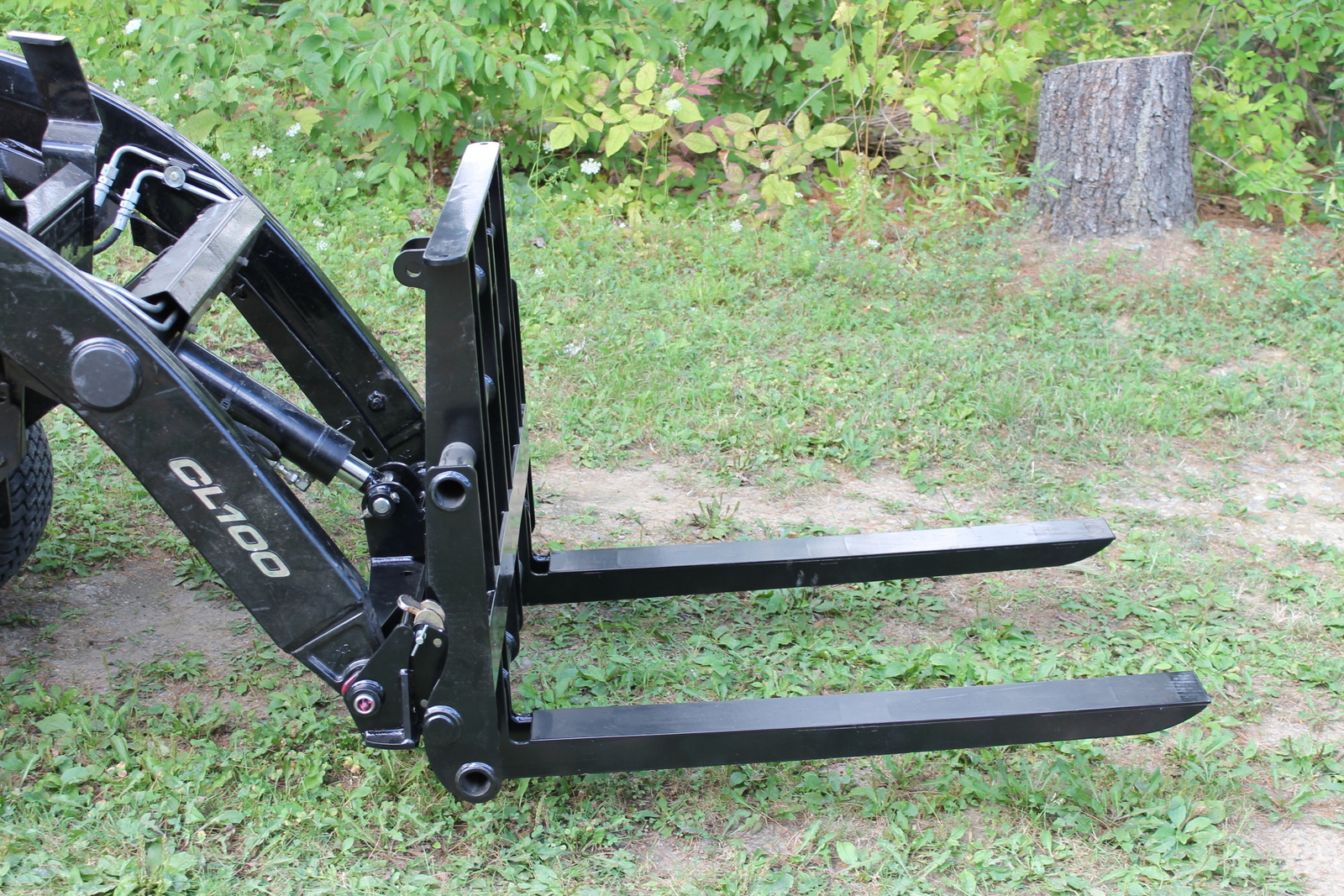

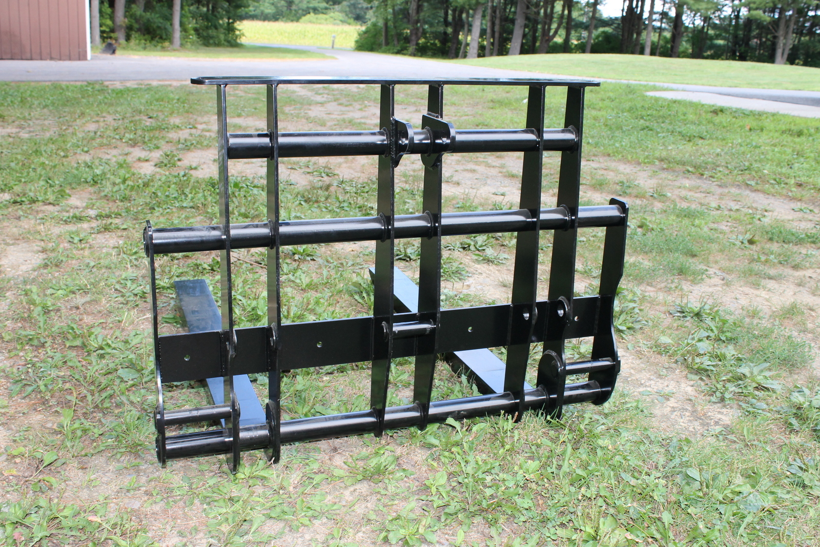

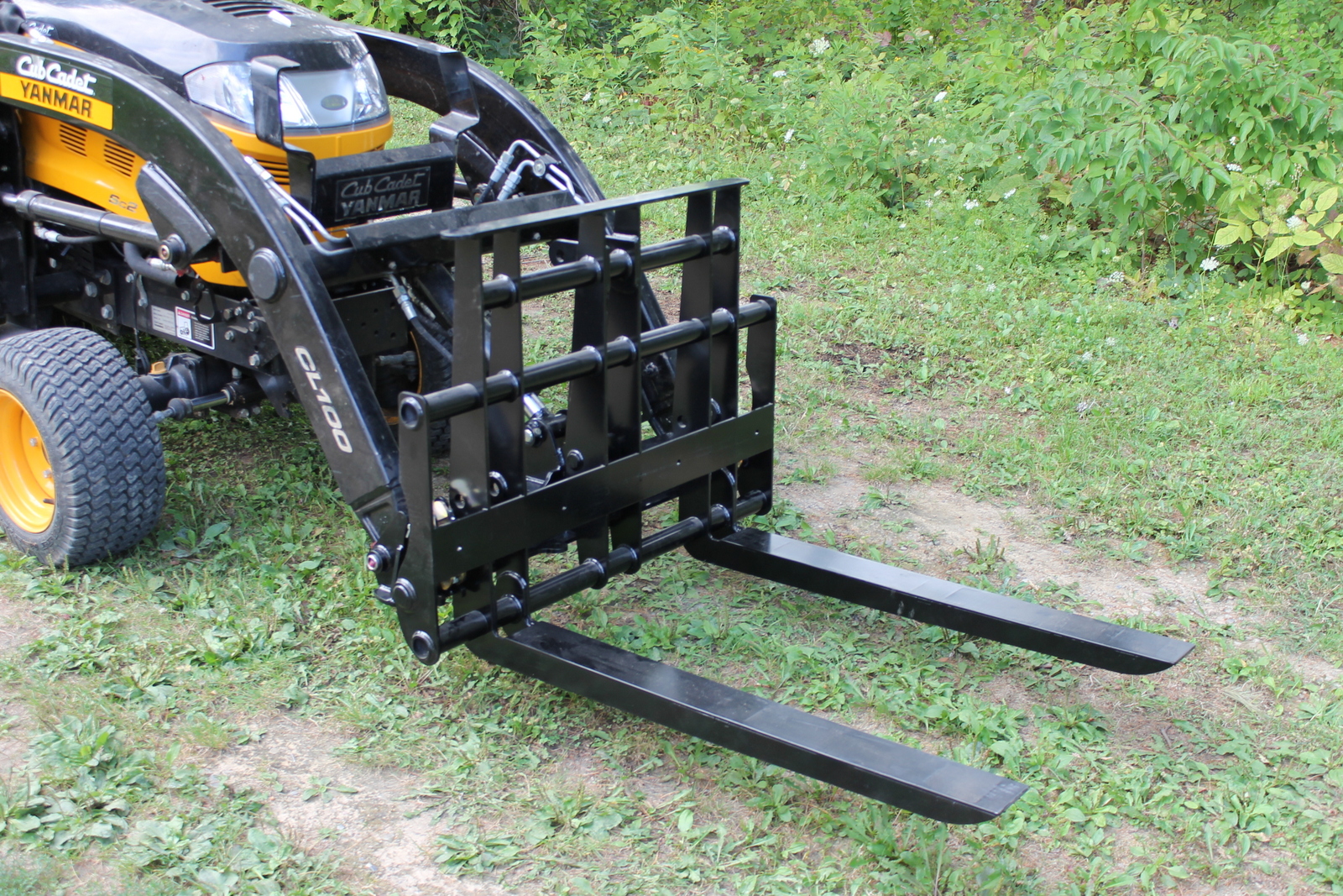

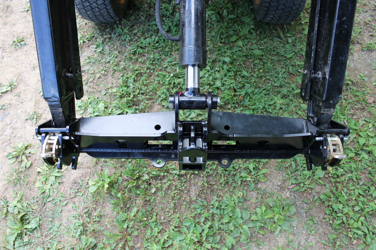

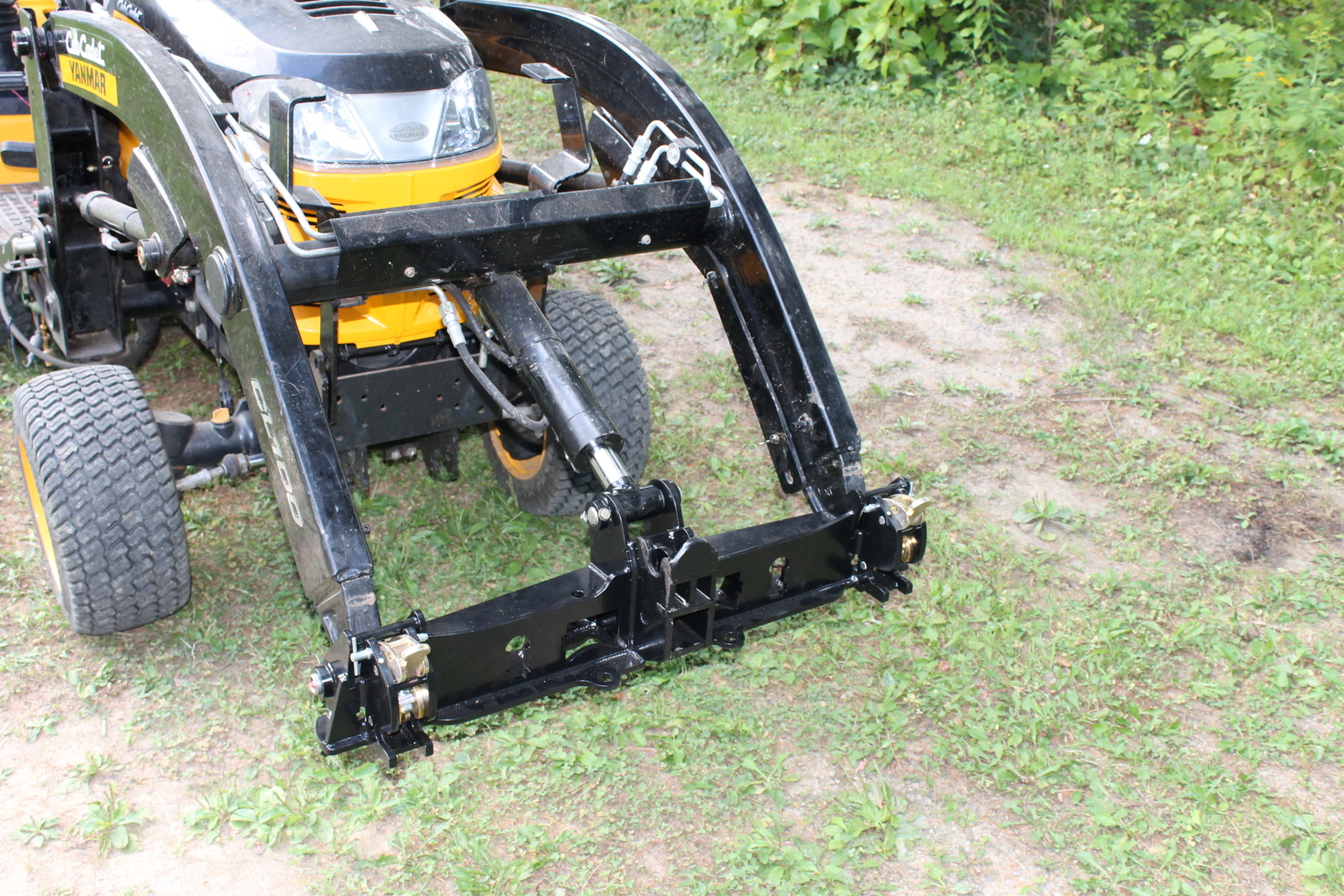

Take a look at this web site:TACH-N-GO QUICK ATTACH
I have there tach-n-go for Cub Cadet/Yanmar along with there pallet forks.
The pallet forks can also be used on your 3 point hitch
Here are pictures of what I bought:
Very simple to go between the bucket and the forks. He offers alot of different attachments.
If you email him he gets right back to you.
The Tach-n-go weighs about 50 pounds the folks weigh 110 pounds.
View attachment 459428View attachment 459429View attachment 459430View attachment 459431View attachment 459432View attachment 459433
This is a neat system, but the forks are fixed and don't slide sideways.
They are still very useful and I like that they fit front or rear. :thumbsup:
