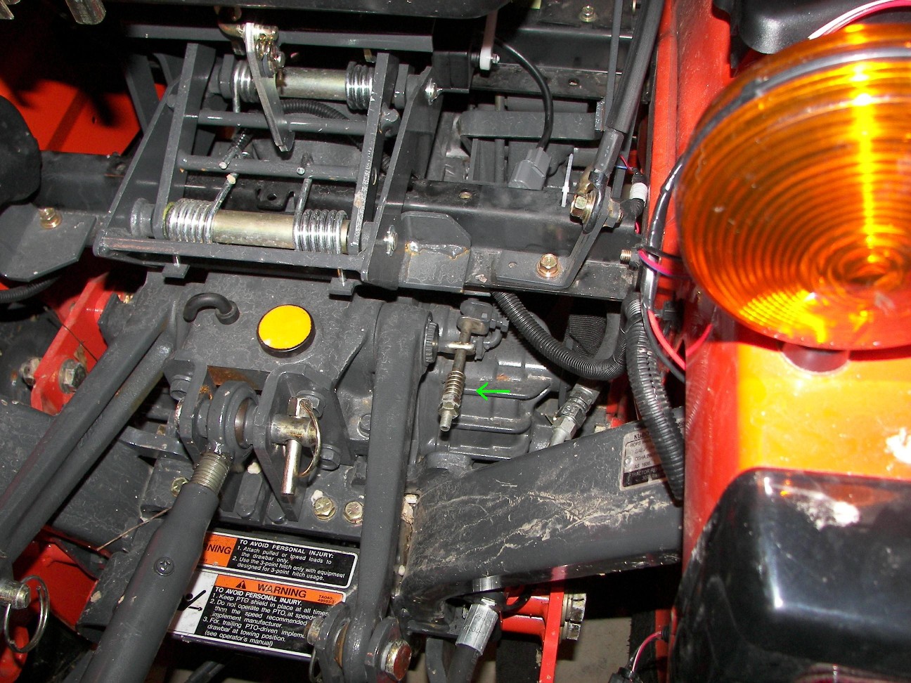

On a B2620 when you pull the 3PH lever to the top (fast lift position) should it stay there or drop back to the centre position when fully lifted? Mine stays up unless I manually put it back to the centre postion. When fully up the loader can't get hydraulic power as it seems to be in constant use by 3PH lift pump. My old BX the 3PH lift lever dropped back to neutral once the 3PH reached full height. Thanks!

My B2320 returns to the center and I think that's the way it should work. I've read there's is a adjustment for this. Check your owner manual, I think I recall seeing something about the adjustment there.
   / B2620 question? #3
You do need to make an adjustment on your hitch as it should come back to center.

I did notice that mine does NOT return to the center when Llowering. Should it return to center when lowering?
   / B2620 question? #7
Looking at your tractor from the back you will see the adjustment for the 3pt travel on the right side (green arrow in pic.). The jamb nuts and spring is the adjustment for the return or stop on the raise and the adjustable block towards the front is the adjustment for the stop for lowering. You may want to take your attachment off and move your 3pt arms by hand to see where you want it set. Setting the raise position takes some trying to get it where you want it with the spring on it.
It does not need to. When you lower the 3pt you are just relieving the 3pt cylinder and not holding the cylinder under pressure. You can adjust it so that it does return to center if you want. It depends on what you are doing with your 3pt. Sometimes you want it to stop a set height and sometimes you want it to lower all the way and float on the ground.

I couldn't find it in the maual. If anyone can direct me to the page that'd be great. Thanks for the picture and directions to fix the problem jbrier.
Bill
   / B2620 question?
I used your directions jbrier and the lever works perfectly now. Thanks!
