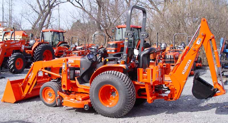

Howdy,
I find it very hard to understand how this can happen. I would expect this from some bofo brothers manufacturing fly by night tractor company but not Kubota. /forums/images/graemlins/mad.gif The web site has a picture of a 3030HSDC with a mower and Turf tires. What changed between then and now? I guess I won't expect to see my HSDC till late May. Putting a spacer on puts additional torsion force on the axle shafts. Hopefully the gearbox will put up with that for a lot of years. The thing that is really disturbing is that the end user is making the discovery. Didn't the dealer notice that things are on the wee bit side of tight /forums/images/graemlins/confused.gif.

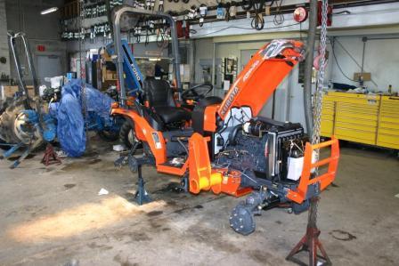

Here is a pic of it on the rack before the tires went on.
   / B2630 B3030 Turf tire #17
I may have to return my B3030 with the turf tires and consider putting R-4's on instead. I'm quite bummed out about this design glitch, and I don't think I am going to accept adding spacers to allow more room for the turfs. This seems like a jury rig on a new tractor! My hope is that there is another turf tire out there with a narrower profile.

Here is a repost of the B3030 on stands with no tires.

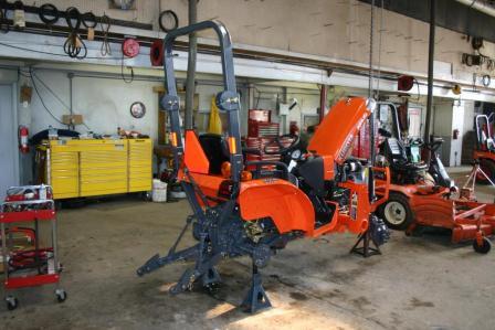

B3030 on jacks, shows rear, no tires yet
