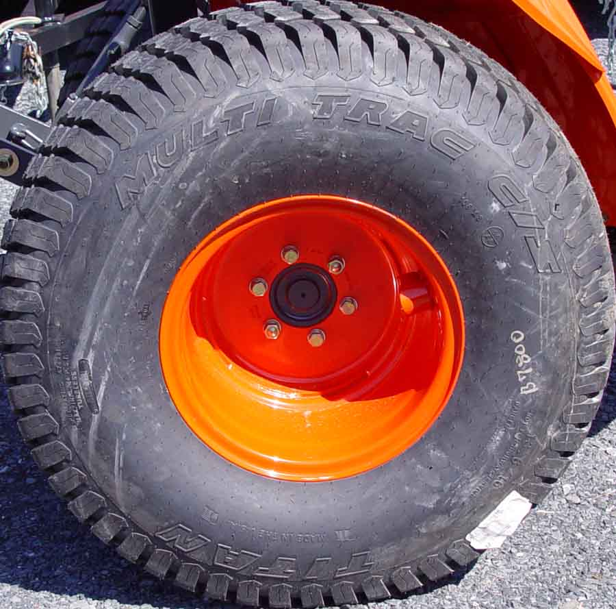

I'm not sure we're talking about the same tires. This is impossible that the same tractor with the same tires are so different.
Here's a close up of my turf tires: Multi Trac CIZ Titan 13.6-16.
   / B2630 B3030 Turf tire #22
Here's another view. If the "round" profile doesn't look like that on yours, it means you don't have the right tires.
   / B2630 B3030 Turf tire #23
Stef,
I have the same tires as you do. Are yours filled? Mine are, might that make a difference? Again, at rest my tires are hard against the fender. With a load in the rear, thats when the real rubbing begins.
   / B2630 B3030 Turf tire #24
Stef,
Now that I look again at your photo and at my tires, my sidewalls bulge out much more than yours do. Maybe overinflated? Can I check the tire pressure with the tires filled? When I tried, the Ballast Star material came shooting out.
   / B2630 B3030 Turf tire #25
My tire are not filled and the pressure is 14 PSI. The mechanic at my dealer told me to stay at 14, no more.
I have no experience with filled tires. sorry
   / B2630 B3030 Turf tire #26
Stef,
Thanks for the info. I'll call the dealer tomorrow and check on the inflation/filled issue.
   / B2630 B3030 Turf tire #28
Stef,
No backhoe. I have a finish mower on the back.
You have the backhoe?
   / B2630 B3030 Turf tire #29
Yes I have one
With rear tires at 14 PSI and I have 3/16" space. (not filled)
