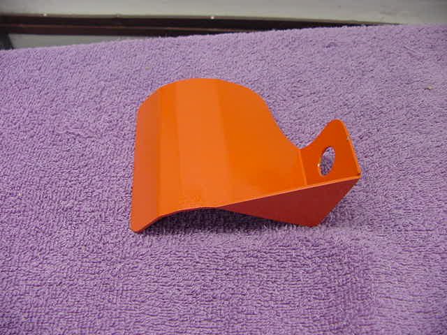

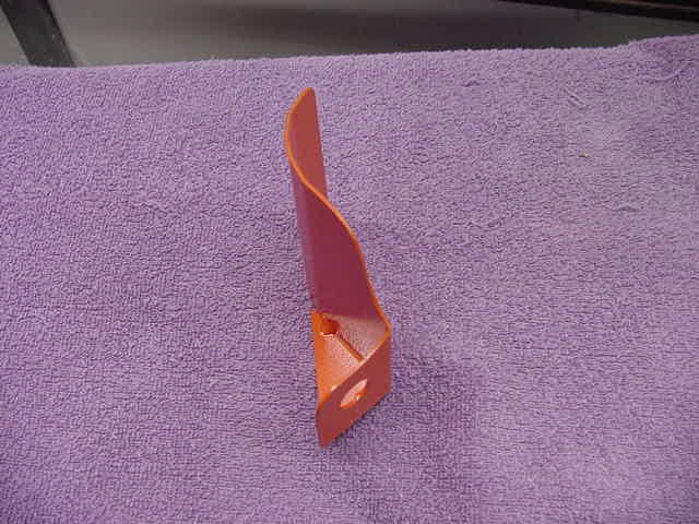

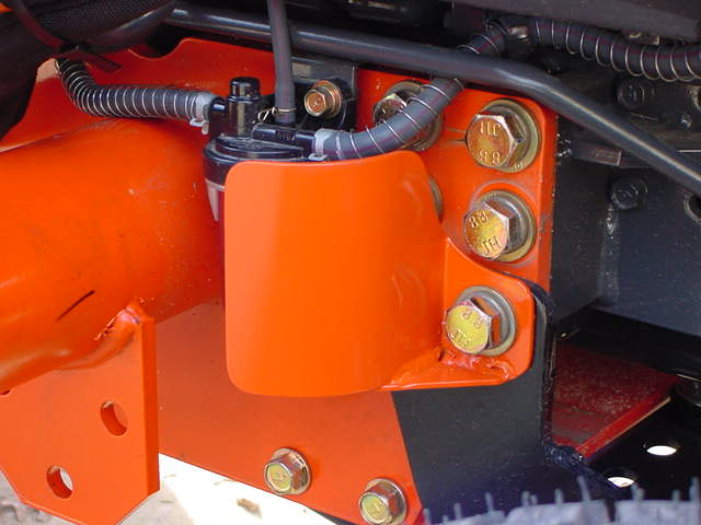

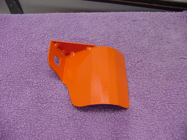

Here are some pics of the finished product. Welded them up yesterday, sanded the rough edges then bead blasted them before painting. The rounded part is done by bump breaking which is several small bends (you can see in pics). Because the metal is coated to except paint and resist rust I couldn't heat them and I didn't have a roller.

I received the guard today and am very pleased with it. The 1/2" impact gun would not break the bolt loose. Finally got a breaker bar on it and pushed it with my foot to break it loose. Looks good. Thanks
