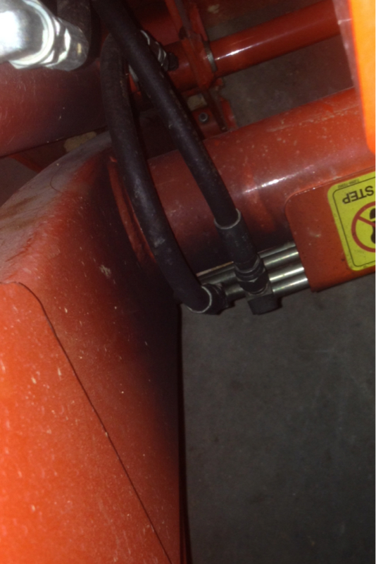

I notice I'm getting quite a bit of exhaust residue on the left side FEL hydraulic lines on my B 2650. I have about 50 hours on the tractor. The exhaust pipe is about 13 inches to the lines in a direct shot. I can't imagine this is good from a design perspective. The lines will definitely dry out faster. Any ideas on what I can do to minimize the exhaust and heat on the lines?

I wouldn't worry about it. See it a lot with all kinds of different brands

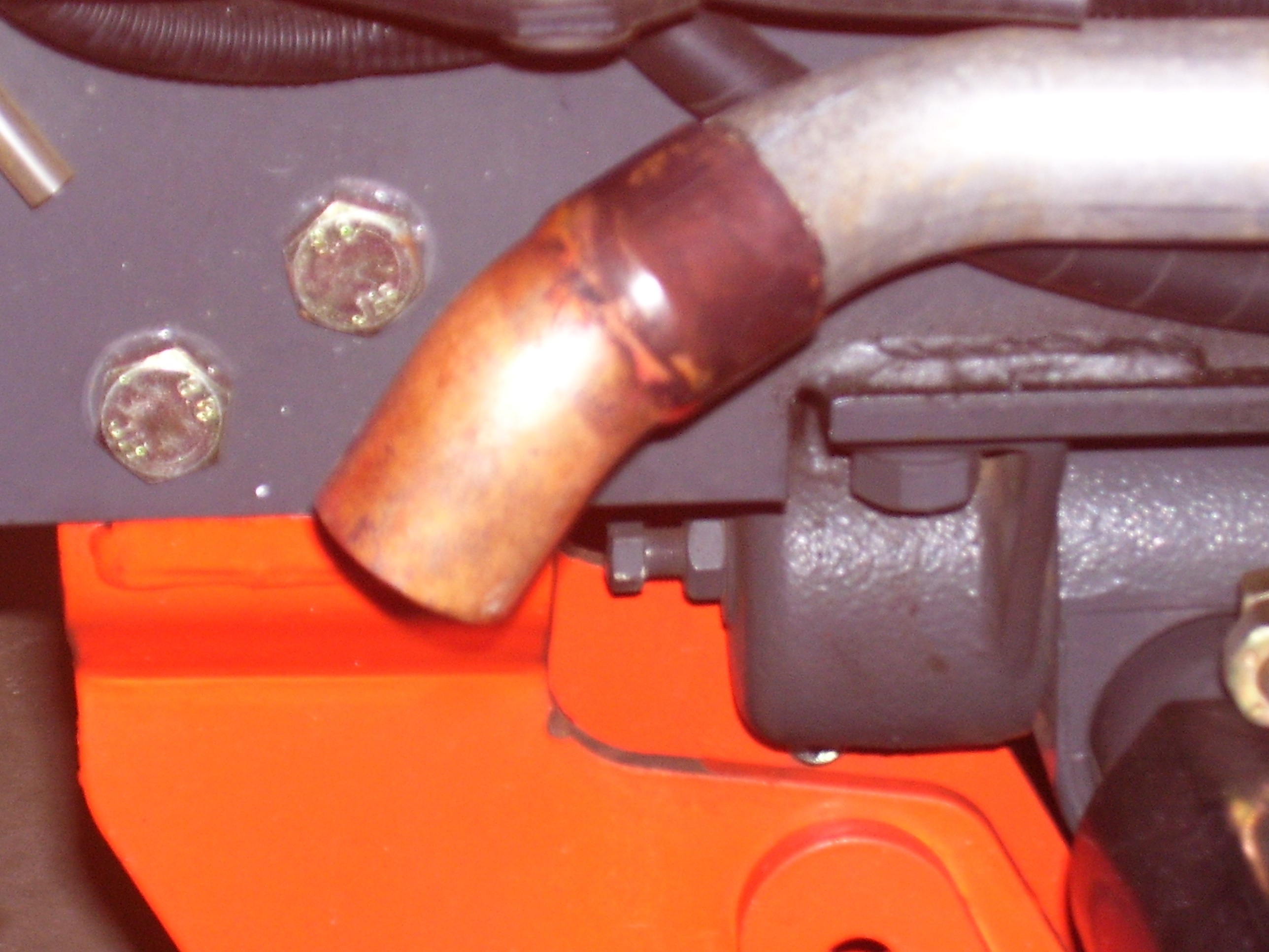

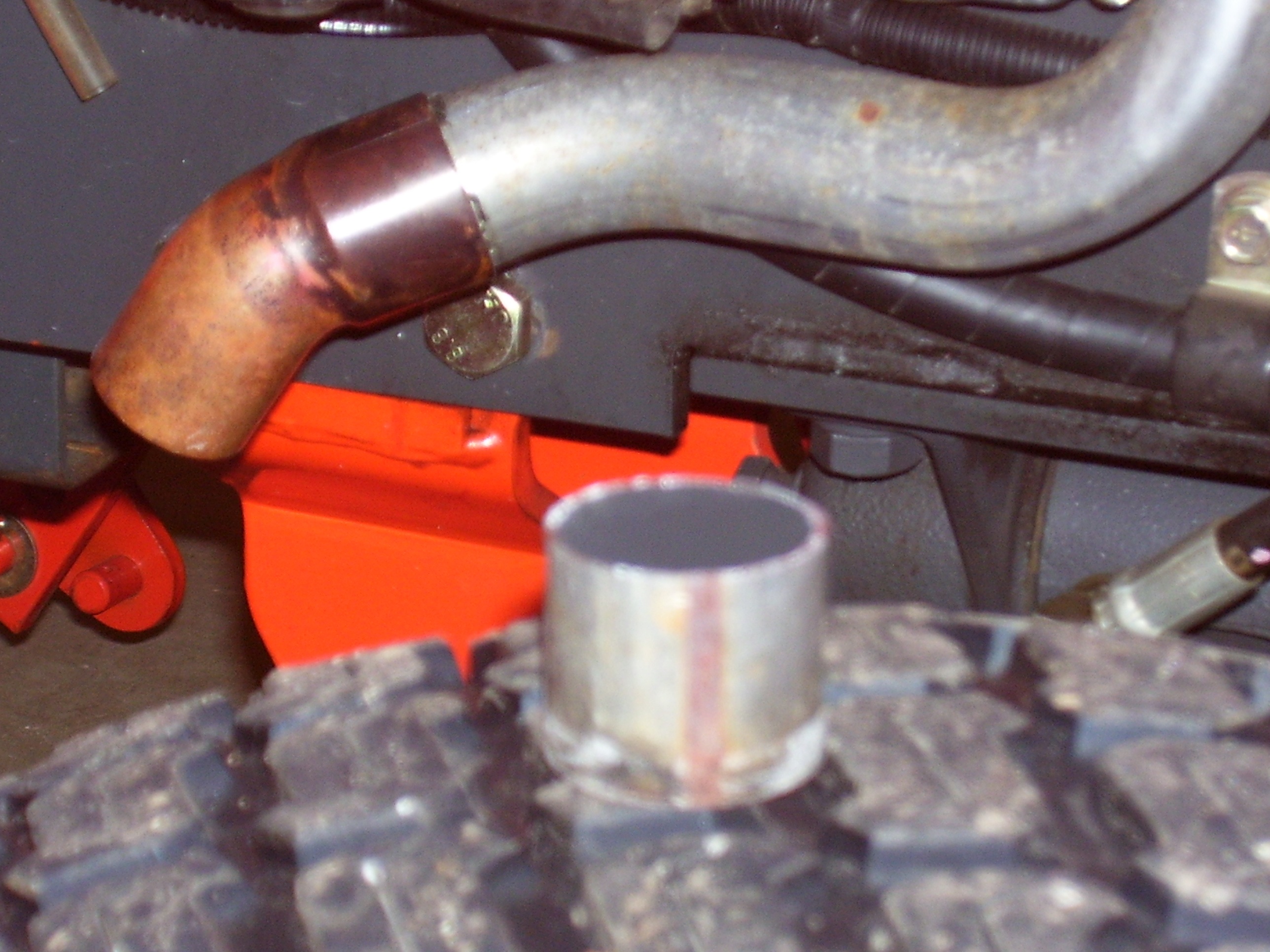

Here is what I did to correct the problem on my B3030. I went to a plumbing supply distributor and bought a copper fitting, can't remember the exact size but you won't find it at Home Depot or Lowes. I heated it up to expand it using pliers to hold it then slipped it over the Kubota pipe. When it cooled it fit super tight. I thought I might have to tack weld it but never had too. Been on for several years now and corrected the problem. I think the piece was about $10.00 +/-. I trimmed a little of the Kubota pipe so I could get the correct angle for the new copper piece. The pipe has turned quite dark so there was no need to repaint the exhaust. Hope this helps.
