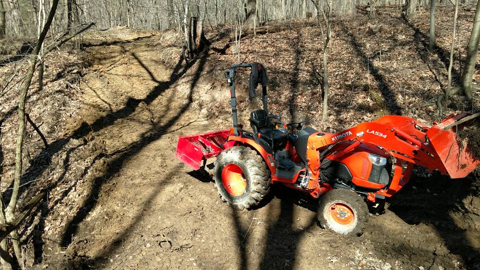

The B2650 handles a 60" box blade and 72" rear blade very well. IMG_20180318_160150183.jpgIMG_20180316_122711564_HDR.jpg
