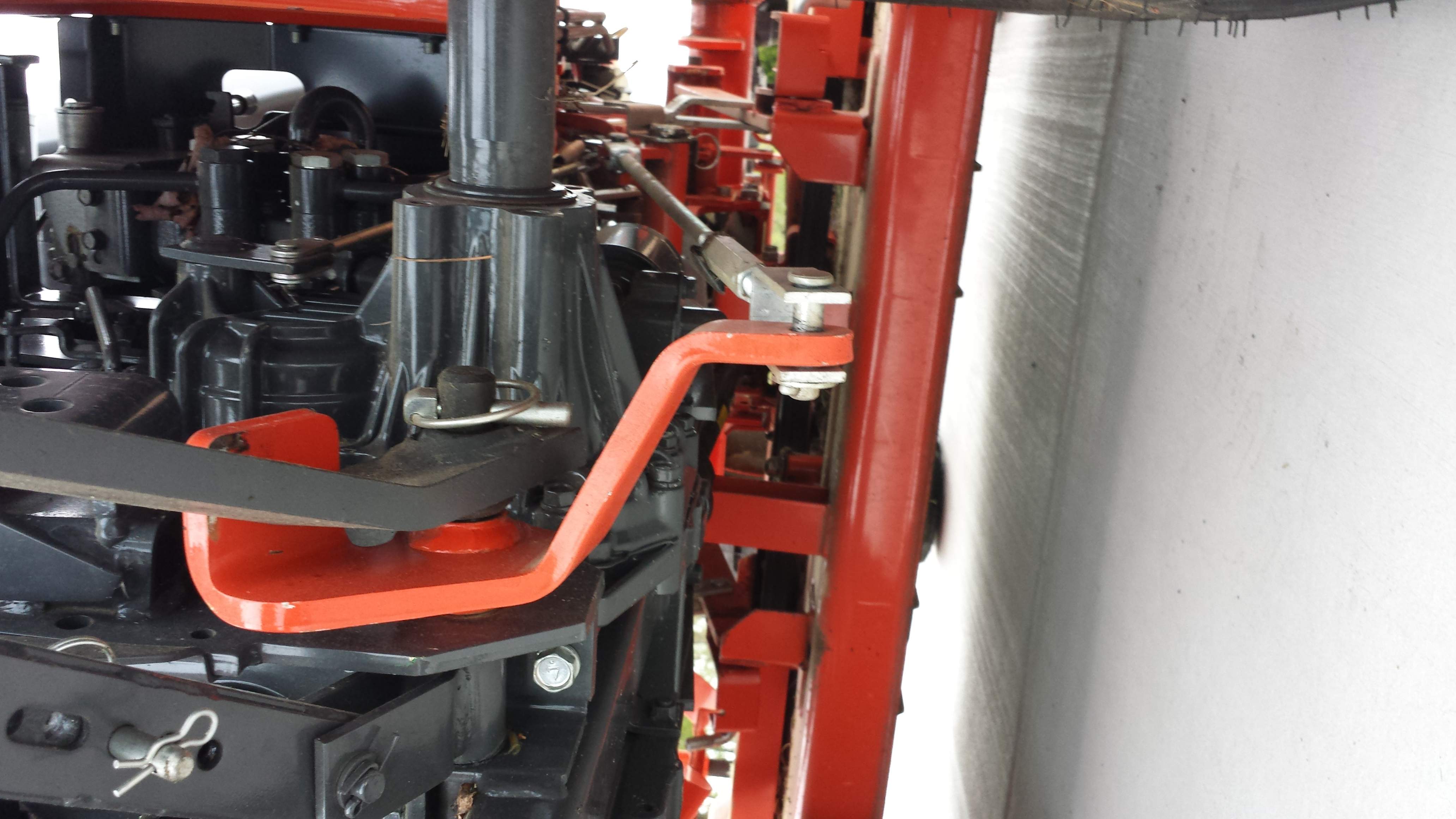

Hi 2fast916,
I received your PM while I was at work today and I just got home. I was able to snap a couple of pictures of my B2650 with the 72 inch mmm. My brackets look similar to your brackets. They appear to be offset to line up with the lifting points on the mower as far as I can tell. It does look a little strange but has not caused a problem for me since I don't have the sub-frame mounting for the backhoe to worry about. The only issue I have, is when I put the 72 inch grader scraper on the back to do some road work. I don't want to have to take the mmm off. I have to raise the mower to the highest position to insert the pins that hold the mower up, but still allow me to raise and lower the grader scraper on the 3-pt. One side of the mower hangs down a bit and the holes don't line up. Not a huge issue, I just use a 2x4 to lever the mower deck up a bit until I can insert the pin. Glad your dealer contacted you with the good news that a different bracket should fix your problem. I will try to attach the pics for your enjoyment anyway!
Jeff

Thank you very much, Jeff! I'm assuming when the backhoe sub-frame goes on, you need a different bracket. Will be interesting to see because I don't know why there wouldn't be one setup that works with all configurations.

Right now I don t have the mower hooked up as I am using the backhoe. But the dealer did not make up any new brackets. The mower linkage is hooked up to two brackets that are moved by your 3 point lift arms. I havent had any problems with interference fit . There is a pin that has a locking bolt that the lift arms are attached to. I would make sure that the sliding pin for the lift arms are is centered with the locking bolt in the detent of the pin otherwise it could make the lift arms offset creating a problem.
