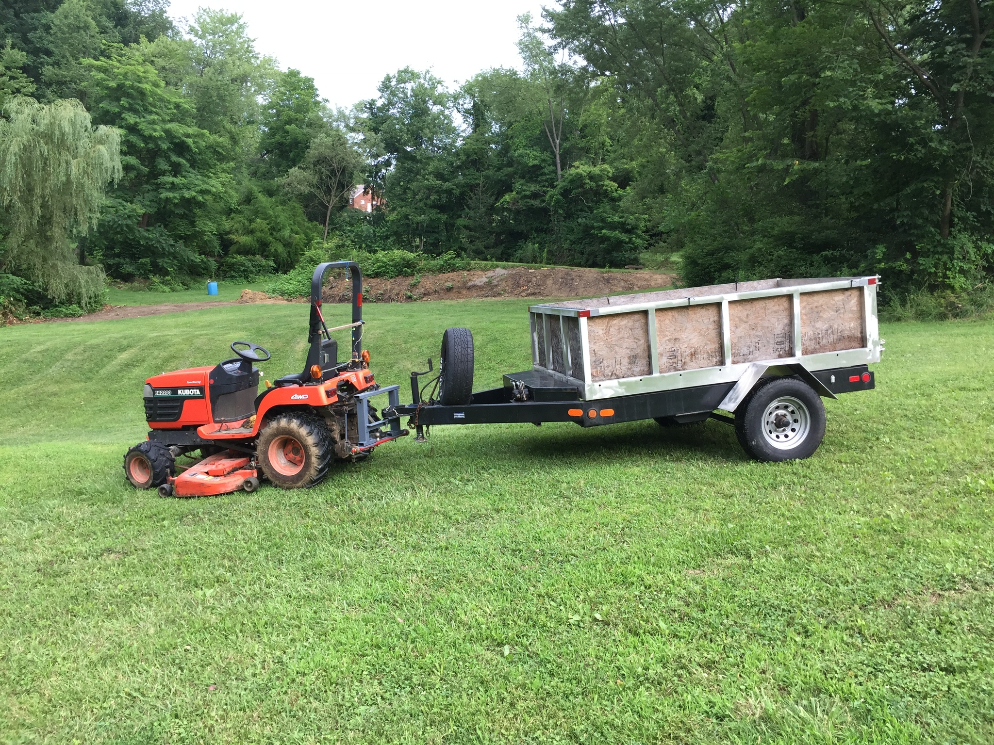

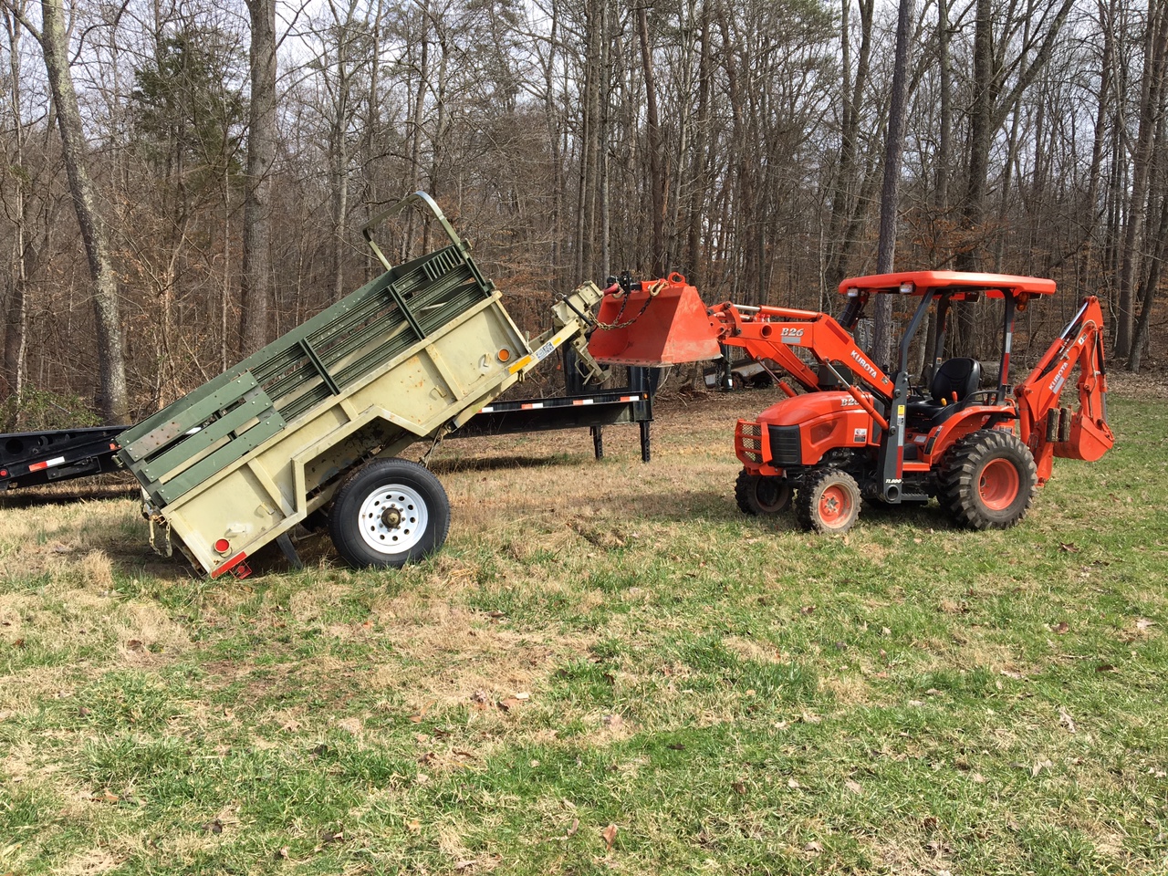

Last summer I pulled a few hundred loads of fill in my 5x8 dump trailer with my BX.
The combined trailer/load weight was close to 4000 pounds many times. The slopes were about what you describe or steeper.
If you scale my experience up a bit, it indicates what you want to do should work fine. My BX has four foam filled tires and I kept the MMM on for extra weight, but still the trailer weight was probably double the tractor weigh (or more) a lot of the time. My only issue was losing traction if the grass was damp going up slope. Also would lift the front wheels if the 3ph was up too high.
Here is a picture of the combination:
I also have a B2910, and agree if I were buying today I would likely purchase a L2501...:thumbsup:
I'm assuming the Bs & BXes have a drawbar. If so you REALLY should use them instead of the 3pt. A 3pt with a heavy trailer can lift the 3pt & roll the tractor when the center of gravity suddenly changes. Not a big deal for a light trailer or on flat ground. But if there are any hills or unexpected dips it can get dangerous quickly.

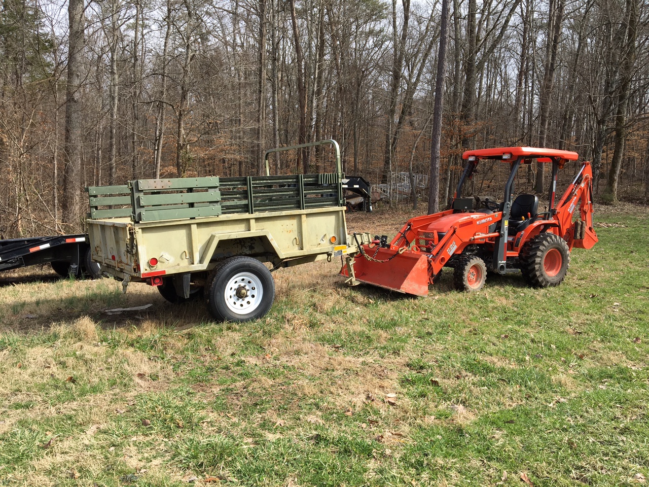

Pintle hitch military trailer with B26.
Sometimes with heavy load of mulch or fire wood. Trailers should not be attached to 3pt hitch. Drawbar only.
I can drag the bucket for brake or control.
Could maybe move your TT but go slow.
