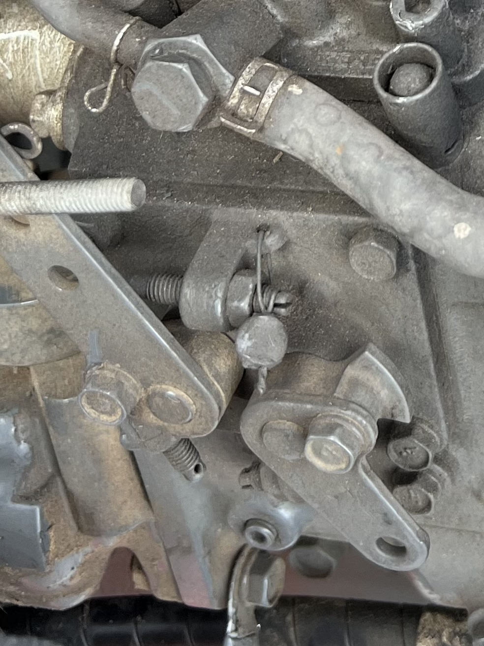

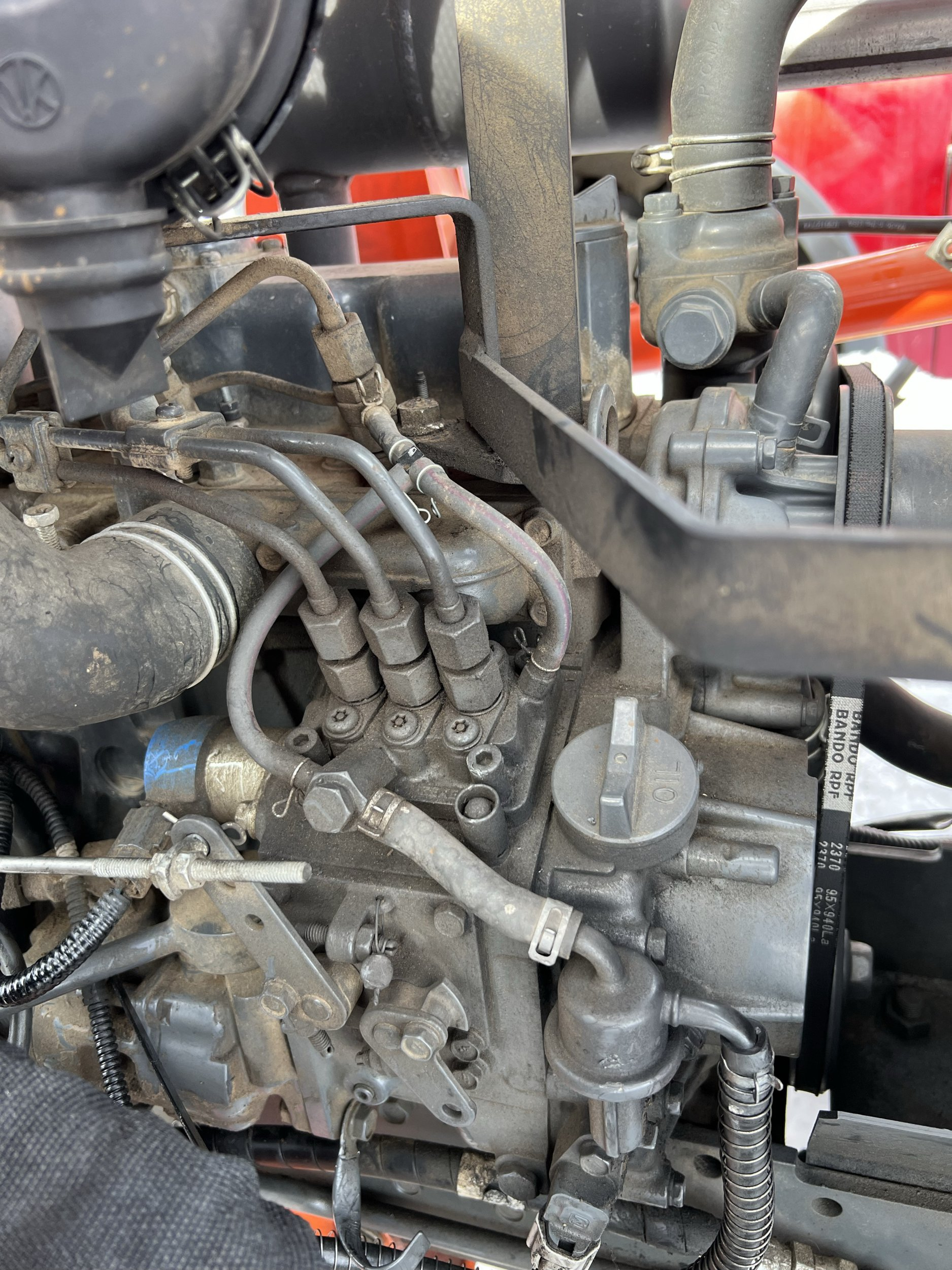

Does it have an electric fuel pump under the frame?
   / B2650 stopped and won’t start
Does that help?
Is this cabling correct?
   / B2650 stopped and won’t start #8
Trace the fuel line from the tank and see if there is an in line pump. Make sure it has voltage. Just because it makes noise means absolutely nothing. Check also for a mechanical pump on side of engine before the injection pump. Fuel shut off solenoid should be checked also. Make sure it is getting voltage. You can take the plunger off it and install back in position to eliminate it. All that cranking burns starters up, so fix the fuel delivery problem. If you keep doing the same thing and expecting a different result, what is that a definition of?
   / B2650 stopped and won’t start #9
Check all of those fuel hoses for a leak. My B7500 had a very small split in the hose between the lift pump and injector pump which caused it to suck air into the injectors. Your B2650 has a bit different fuel line setup, but a leak anywhere in those hoses can cause problems.
