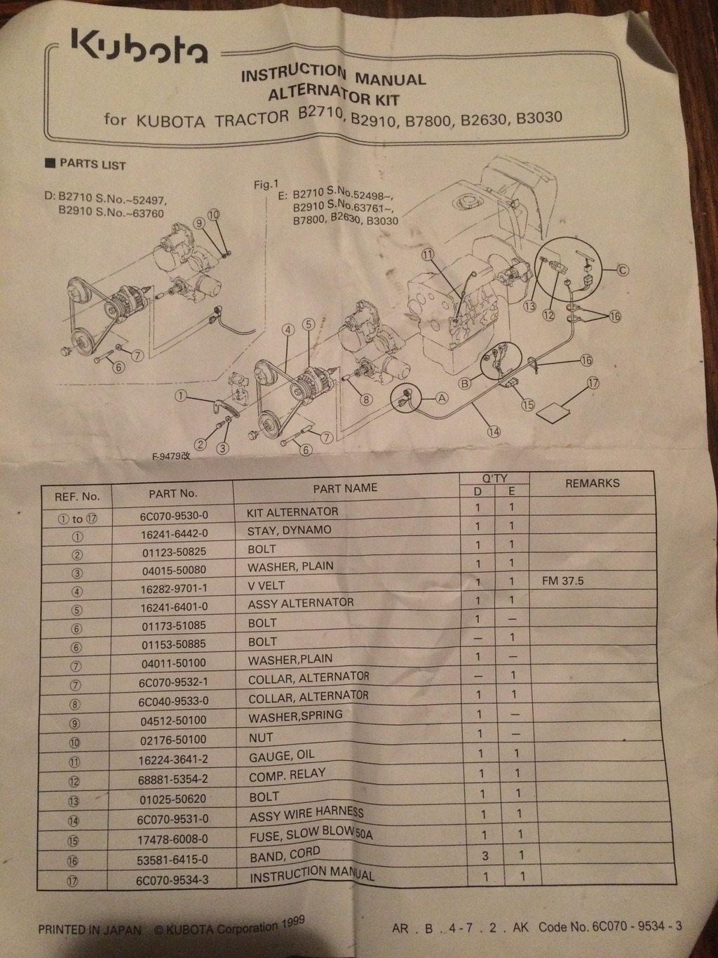

mecan,
I have a concurrent thread to yours about upgrading to an alternator. I saw you posted to it but I don't know if you checked it lately. KyleH posted a kit with PN that is made for the B2630 (as well as some older models) and he says it fits perfectly. That PN is K7324. I have my dealer here getting me price and availability but I'm pretty excited to find a ready made kit.
John
   / b2650 upgrade alternator? #17
Yup, the kit (B7324) from Kubota for the B2630 will fit the B2650 just as well.
   / b2650 upgrade alternator? #18

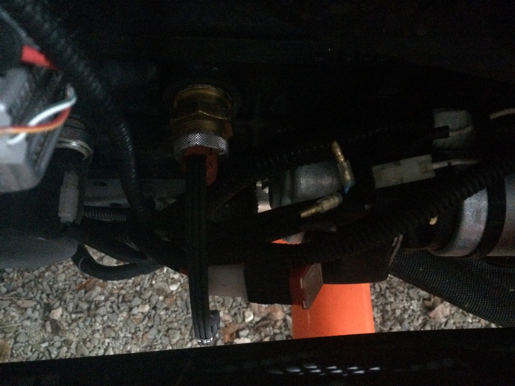

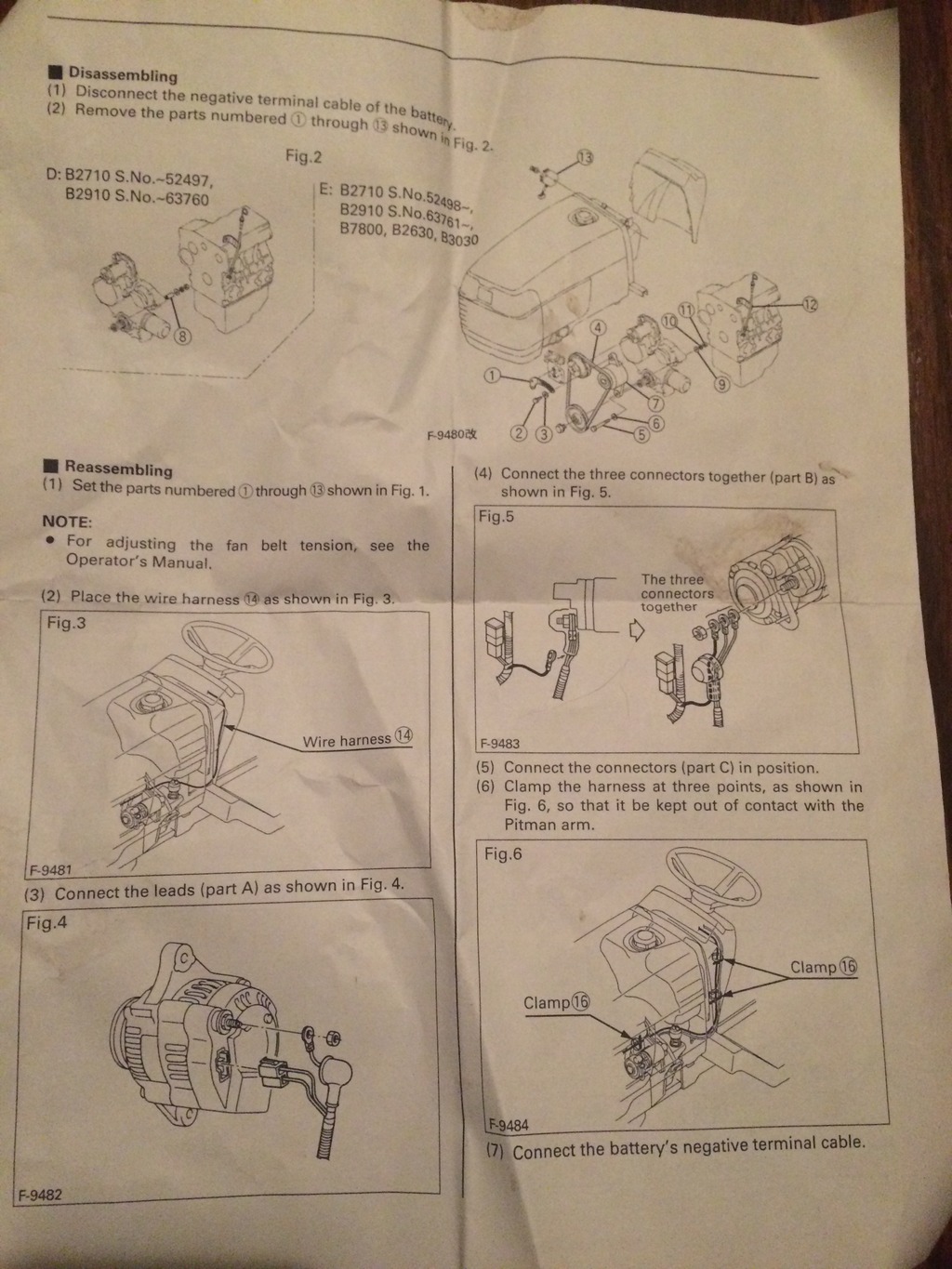

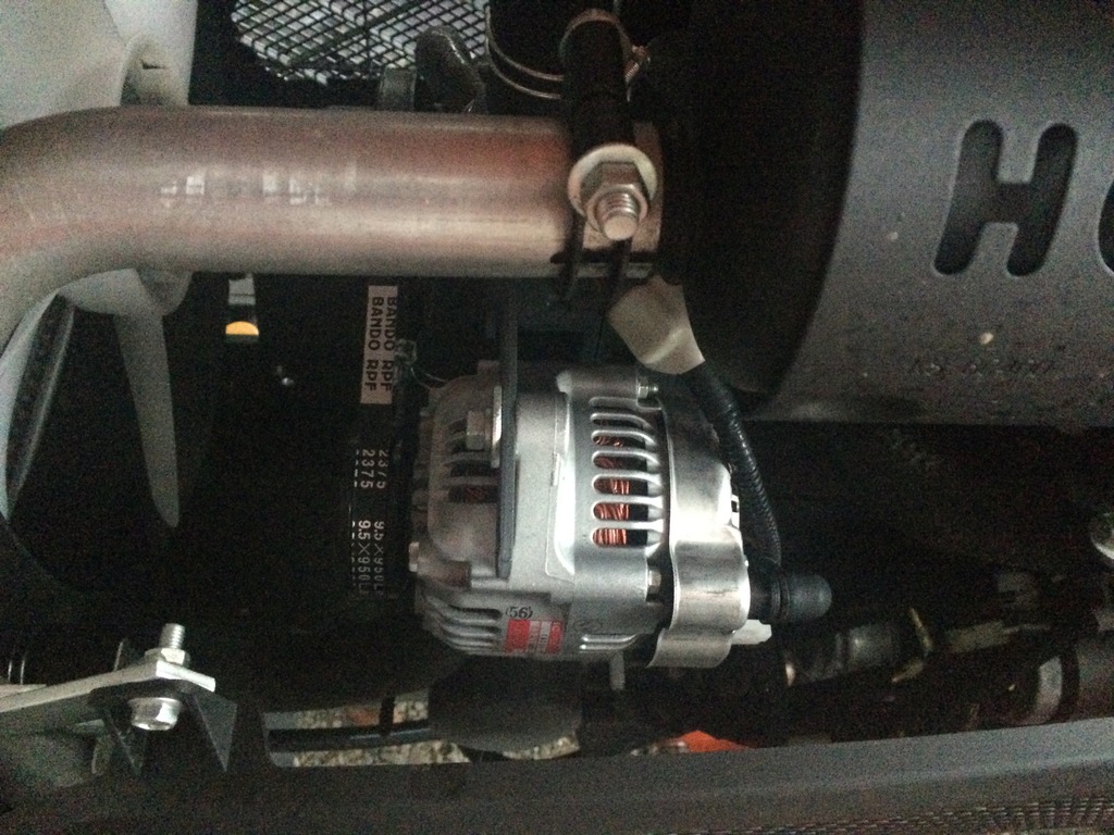

Any chance someone could post pictures of this kit, please? Or maybe the instructions it came with...
   / b2650 upgrade alternator? #19
   / b2650 upgrade alternator? #20
It's pouring rain out today, so a bit dark but figured this would give an idea of what it looks like without pulling the tractor out and pulling the panels off in the rain. If there's something specific anybody wants a picture of just let me know and I'll see what I can do.
