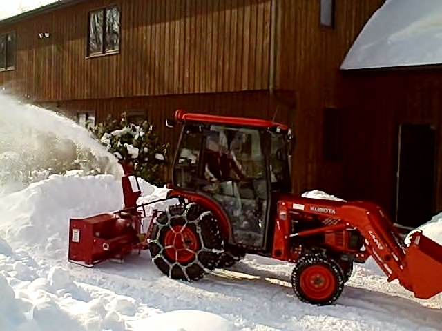

There is something to be said for, "Go big or go back." However, nothing beats a cab in the wintertime. I would also look at the spacing between the wheels and frame/fenders. It's would be nice to be able to chain up the rear tires and not need spacers.
I love my cabbed 3030 in the wintertime, especially when you get those pesky storms that change from snow to rain or rain to snow.
