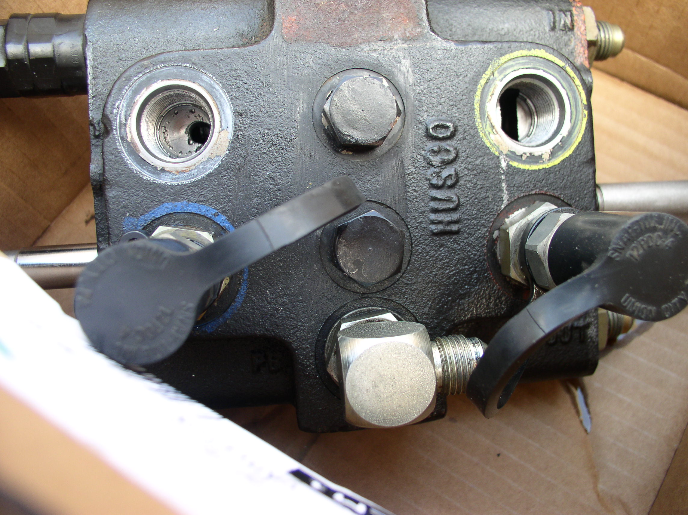

What I did discover when taking out the quick couplers was that the top port in which the coupler screws on the lift side has no holes in it. It's a dead port. I'm wondering if this is normal? If so that would only leave one port for raising and lowering. Since there is no hole for oil travel I suspect this to be normal or the bucket wouldn't work at all. I would love to see a hydraulic schematic showing the fluid flow during lift and drop activity.

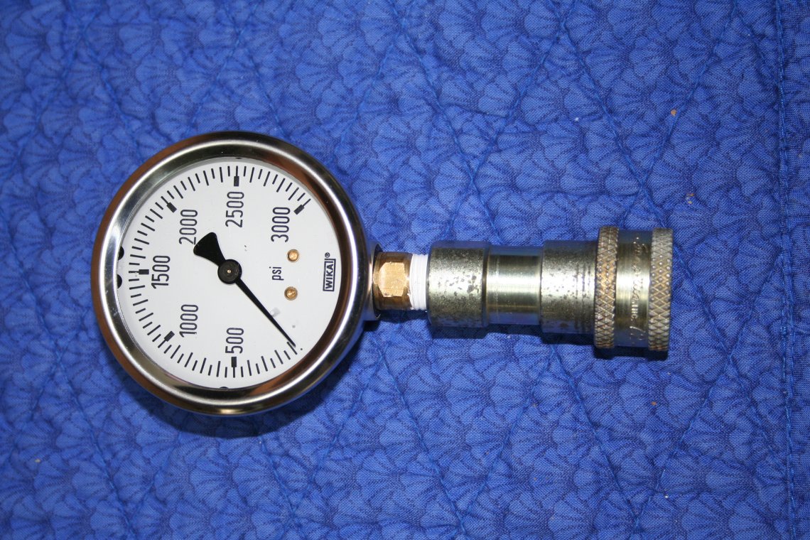

You can install the hyd gage at the IN port with a tee and it will indicate pressure, or if there are QD's, just plug the gage into the QD and engage the lever for a moment.
If the fluid was being blocked, you should have heard the relief going off.

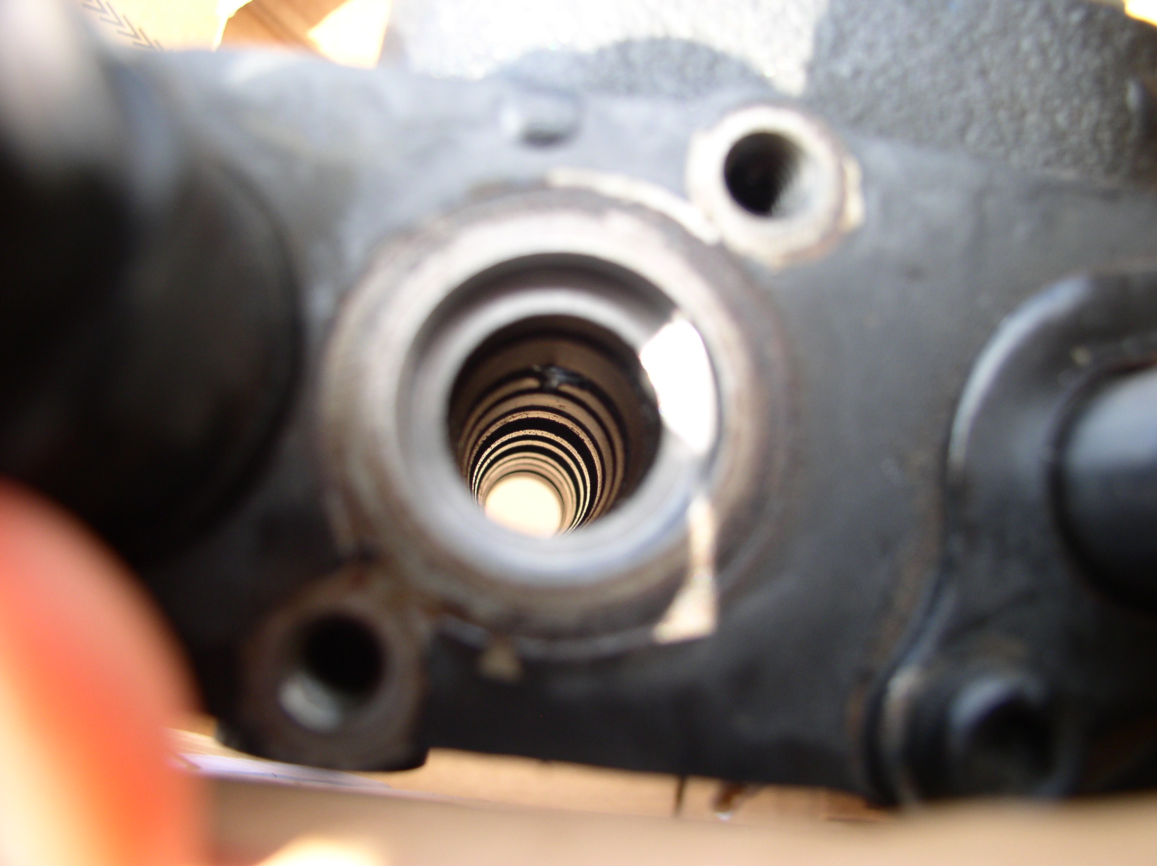

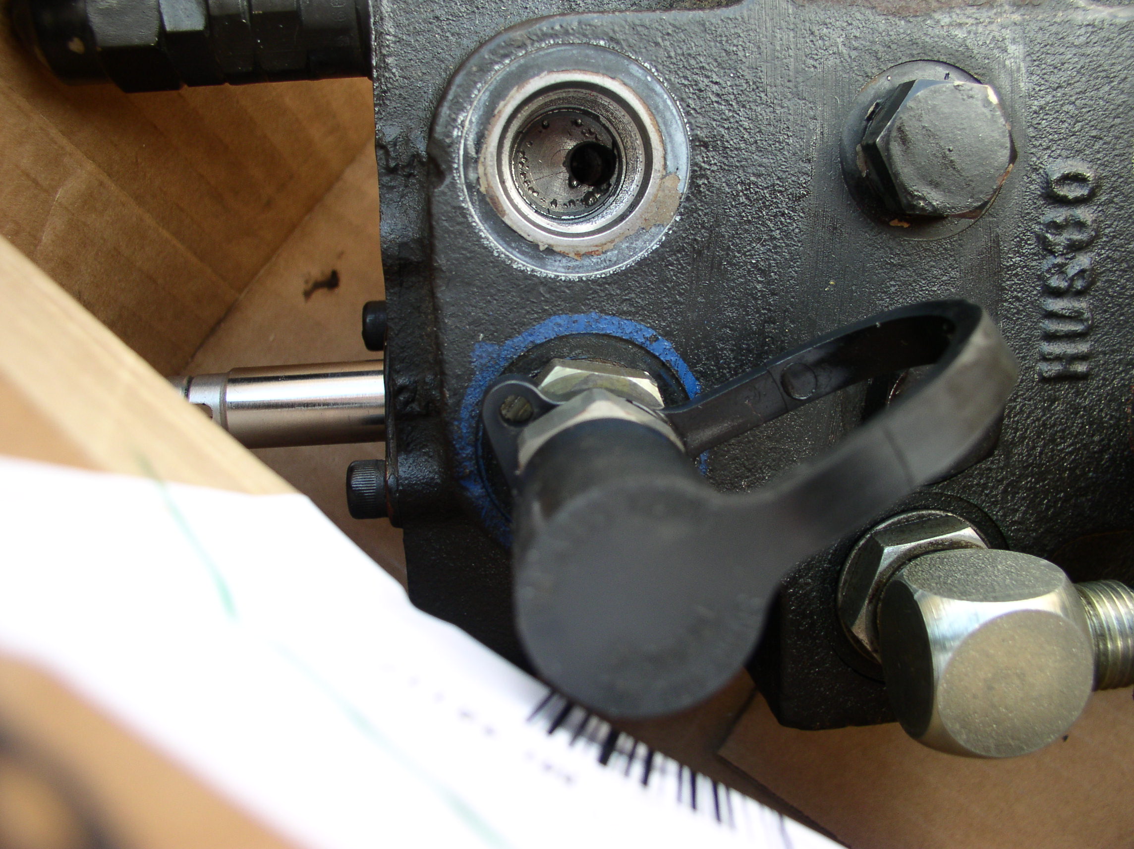

JJ. There is no technical service bulletin on this issue. According to my dealer support guy, Jim from Kubota told them to drill a hole..apparently anywhere in the port. I suspected this might be an issue since inside the valve body are several "dividers" I got the valve body back from the dealer today. They drilled a hole in the port and as I suspected, left a burr in the bore where the spool goes. Also it turns out the hole was drilled right in the middle of one of the "dividers". After removing the burr, I inserted the spool and had to "tap" it in where before it would slide in with little effort. I expected to have problems and I do. Right now the spool is too tight and will not return to "neutral" position with the spring pressure. I have to manually center it. The lift seems to work really slow but it does go all the way up. I am going to fashion a note to kubota asking for an explanation and advice for resolution....

Nice pictures. They should have cleaned it out more and smoothed the edges. You might also run a small magnet in the bore and see if you pick up any more bits of metal.
Is that hole too deep for a Dremal tool and a small ball grinder, or a curved file?

I did run a magnet through it and did not pickup anything until after I filed off the burr. The hole is a bit on the small side but likely not too small for a dremel stone. However I've already reassembled the unit which brought me to the conclusion of the bore being distorted enough to restrict the smooth operation and return of the spool to neutral when I let go of the lever. Ironically I finally received a response from Kubota technical assistance on the issue of whether or not there were any TSB's on the valve. They didn't answer my question, only suggested that I take it to my dealer. After seeing them prick punch the bottom of the bore thinking that it was a stuck check valve rather than the lack of a hole in the port, I don't think much of the dealerships' understanding of how the system works. Not that I understand completely. In my response to Kubota, I further explained the symptoms and the subsequent suggestion of their tech person to "drill a hole" in the port. Also the tech person was quoted as saying "every so often a valve may be missing a hole".
While I do believe the hole was needed, I don't believe it was done in the correct location now that it's reassembled and I have to utilize the lift/curl motion of the control stick to get it to raise with any speed. If I only use the lift motion it goes up all the way but it takes about a minute to go from the ground to 6' height. Stay tuned...this one's not over...
