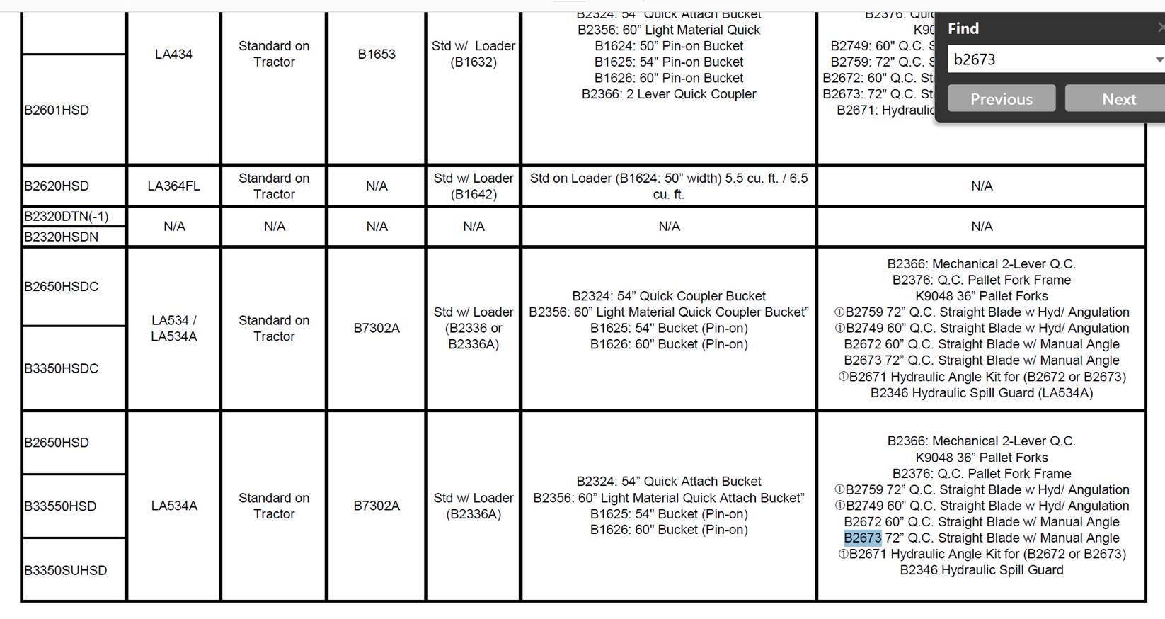

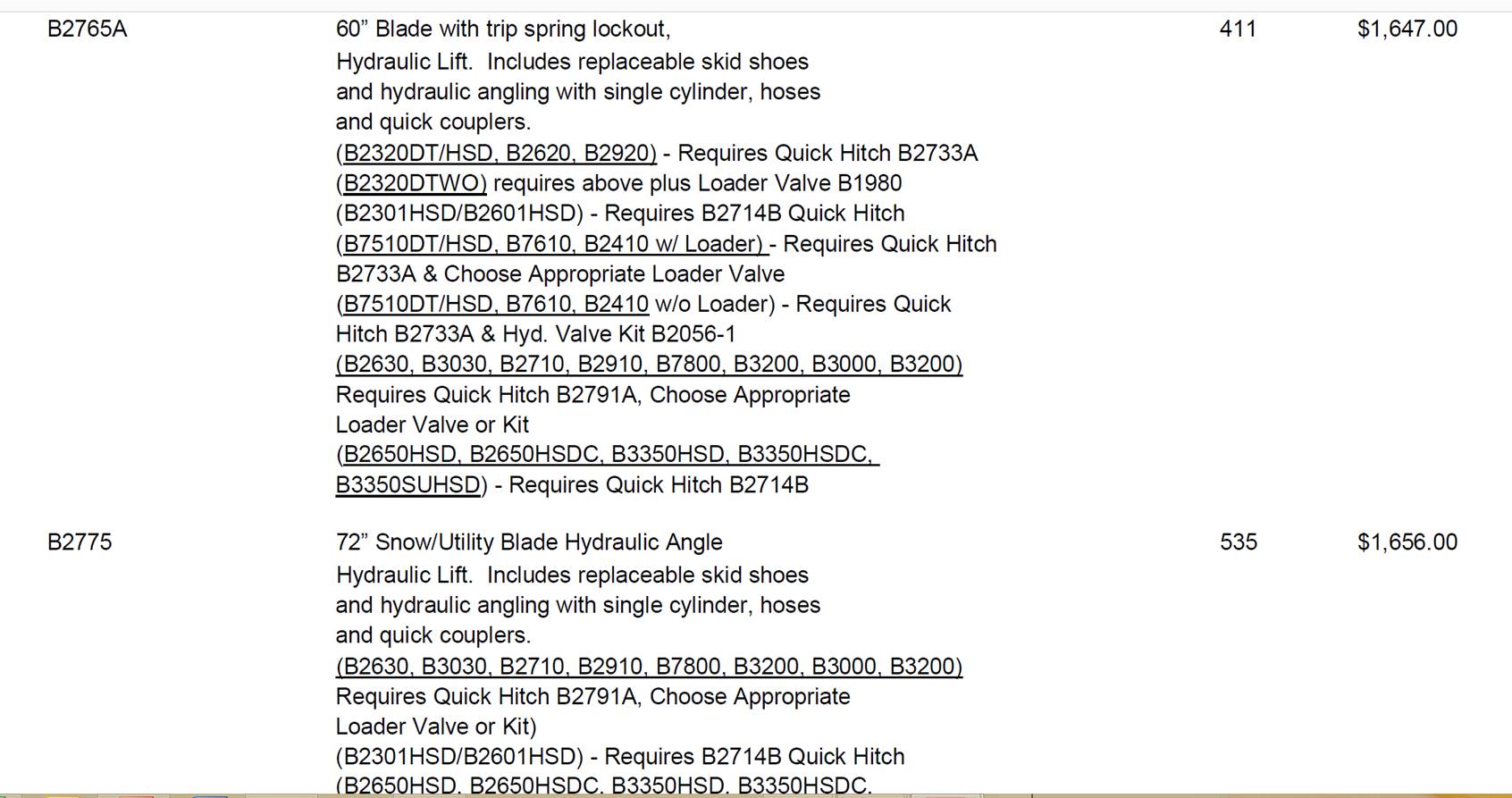

My price sheet is a couple of years old, but should give you an idea what you're getting into.
B2673 72" Q.C. Straight Blade with Manual Angulation $1,779.00
B2671 Hydraulic Angulation Kit (B2672 or B2673) $483.00
If I'm reading the wholegood price list correctly, B2673 is used with the 2-lever FEL quick hitch, not the subframe mounted duckbill style as used with your snow blower. Perhaps someone that owes one can confirm. (See attachments)
B765A (60") and B2775 (72") are listed to work with the B2791A quick hitch.
B2775 includes hydraulic angle and costs $1,656.00

/ B2763 Front Blade
Hi Moship.
Thanks a lot for that info, but there seems to be a difference in the model number I mentioned and the sheet you posted.
I am speaking of the B2763, but the sheet posted is for the B2673.
It's a different model so the front mount may be different as well. The second pic posted shows the quick hitsh I have, the B27itit91A.
Thanks again..... I appreciate it.

/ B2763 Front Blade #10
Correct.
I have a B3350 with FEL mounted (skid steer type mounting) B2673 72" blade. B2672 is a similar 60" blade, B2671 is the hydraulic angling option, and B2776 is the optional 72" hard rubber cutting edge.

/ B2763 Front Blade
#11
After even more research, I believe the blade that will work with the quick attach subframe sled model B2791A, is blade model B2775.
It's a 72".....Very few of them around.
/ B2763 Front Blade
#12
I confirmed with a local Kubota dealer that the correct front mount blade fro my mount is what had. It's a B2775.
I asked for a price quote and he quoted me $2,200 Plus Tax for the blade with the Hydraulic adjustment and female receiver.
I found a used one for $1,600 in real good condition, but it's a 10 hours drive one-way from me. An informal transportation/shipping quote was $1000.
So it would actually more expensive than buying a brand new one from my local dealer.
I'm not desperate for one, so maybe I'll have to bide my time for a used one closer to me.
If I had plenty of time on my hands, I'd grab my little 4x8 utility trailer and go.
