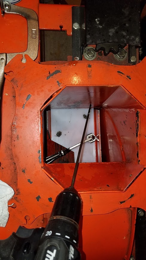

Still thinking about the augers, that's a toughie. 2nd picture in post one of this thread shows the chute ends of the blower housing liner. The housing liner was the most difficult part of the job. It failed the other day, tearing at the acute angle where it goes from chute to housing. It had been impacted by some stones or debris, hard enough to slightly dent the steel underneath. This area should have been protected by steel lip or?
When it came loose, impeller blades wrapped it up and sent the loose end up the chute. Snow then pushed in alongside it and bogged the machine down. I abandoned the idea, figuring making impeller blade liners would seal to the housing just as well, which improves throw distance - as does the failed liner. But the paddle liners would have some advantages. No more sticking snow building up on the blades and super easy to do (as compared to the liner)
After cutting out the liners, it took about an 1-1/2 hours to install. In the pic below, the holes have been drilled first in the liner, and then down through the blade. The black spots are the swarf from drilling. I was going to use 1/4-20 bolts, washers and nyloc nuts - I ended up using some 1/4" X 3/4" hex head sheet metal screws.
The pre-drilled liner is place on the blade, with the blade turned to the position where it has the least clearance from the housing. The blade is then pushed outward so it butts against housing and then clamped as shown. Not shown, the leading edge of the "wipe" has a slight 45* bevel. I chose only to line the "flat" of the blade, not the upturned edges. I figured if I bent the UHMW-PE to line the edge, debris would get jammed into the gap.
Ran it today for 4 hours - flawless!
