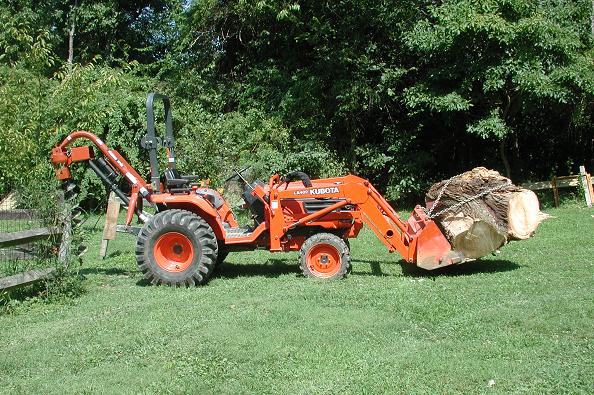

Chain hooks are the greatest! I used to struggle to chain something to my bucket...now with a couple grab hooks using chains is a piece of cake!
Man I love my toothbar/chain hook combination!
Attached is a pic to prove it! It was a willow tree, so not very heavy. My rear tires are loaded. I would rather have had more ballast, like a my boxblade or backhoe on, but even with jus the PHD on the back it was very solid.
The sooner you get those chain hooks on your bucket the better you're going to like it! /forums/images/graemlins/grin.gif
