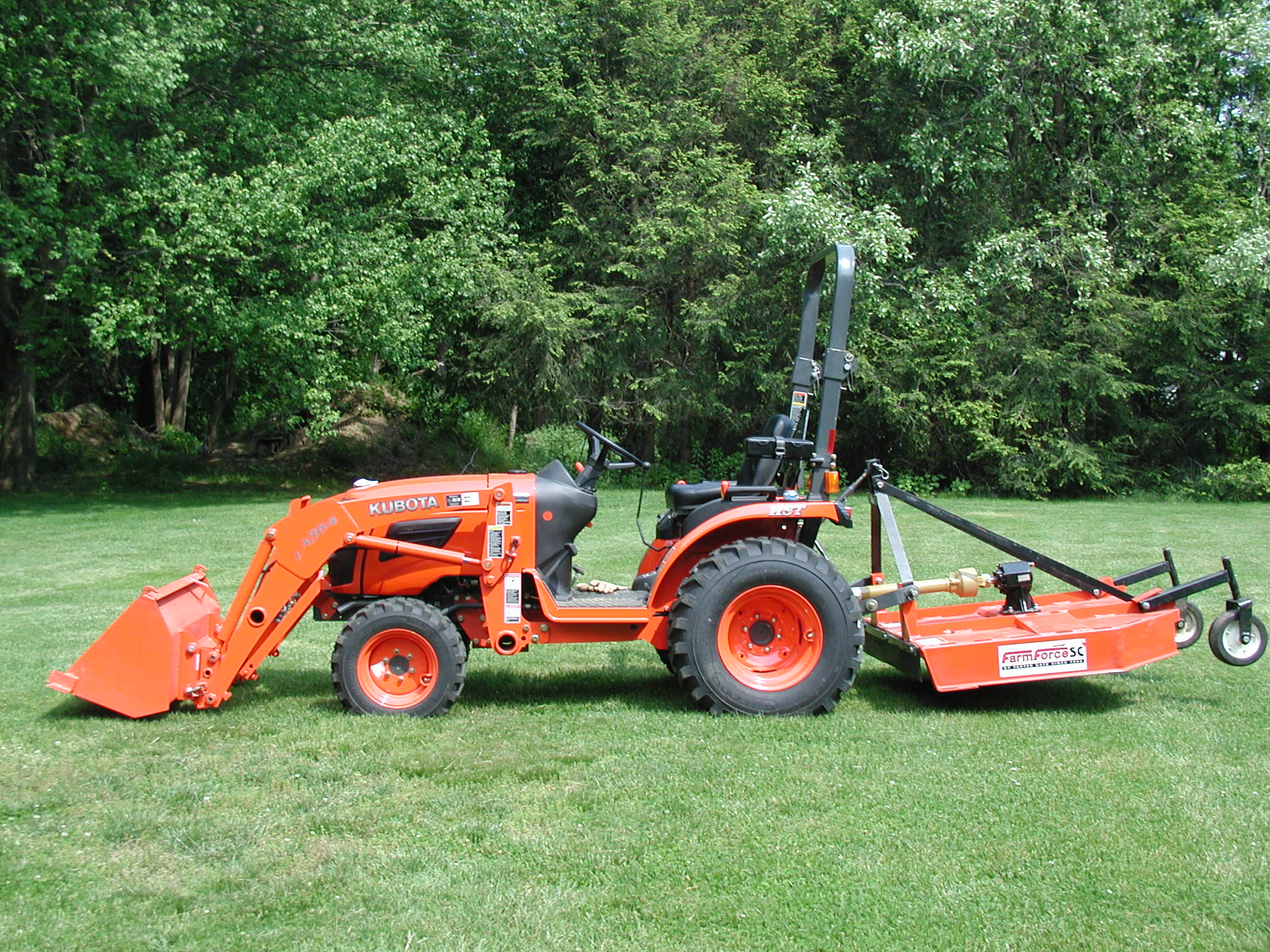

Every now and then you just got-ta run to the house and grab the camera for that Kodak Moment.
I was going up to my farm property to do a little hogging and thought I better snap a few pics before she gets all dirty!
The 4 foot Farm Force is far from the top of the line but it has yet to fail me every time I put it to use. It also helps that it is the right color too ;)

Those photos belong in a catalog!
It sounds like you are reasonably happy with the FarmForce bush hog. What diameter of material will it handle? I'm thinking of getting one, can I ask how much you paid?

Hi Guys,
At the time I bought the Farm Force Bush-hog TSC was handling these implements. Farm Force is made by a company called Tarter Gate.
Farm and Ranch Equipment - 4 ft. Rotary Cutter SC - By Tarter
The quality in my estimation is good - not great but good. It really comes down to the application. If I was hogging 20+ acres I would have opted for a much more stout unit (this one is ~365 lbs) but, for my application (tall grass, heavy brush etc) for an acre every now and then it is all I need. In fact when I purchased this unit I had a smaller BX22 which it seems to be a perfect size match - now that I have the B2920 I could go one step up but for what i do its works great.
I am not sure TSC even sells Tarter Gate anymore however I remember I was very happy with the $499 price I paid 2 years ago (I recall it was on special). It handles up to 1 inch material just fine.
The only weak link I can find is the clips that hold the rear wheel assembly together. If you back up into a bush the clips can be unclipped easily. Using a bolt in its place fixes this.
For less than $500 you will not find a better unit.
