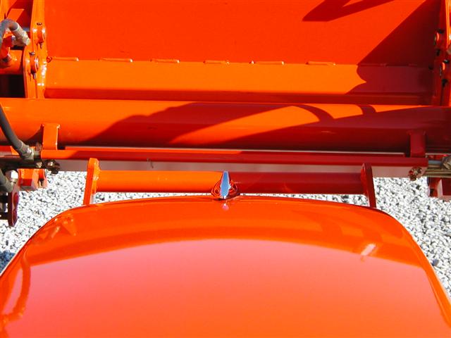

I really don't feel its the tractor frame causing the problem with the loader because the loader will follow the frame. So if you had a perfectly square loader you wouldn't notice it in reference to the frame itself.
When you look at the front of my 3030 at frame level with the loader in front of it the loader sits crooked in reference to the frame as seen in this picture loader pic
There are two holes drilled in the front frame you can reference off of in relation to the cross tube on the loader.
You would think if the side frame rails were twisted in any way the loader would have to follow due to the loader mounting directly to the frame rails themselves.

I think I understand what you mean. Your loader is "crooked" in relation to the frame. Mine is this way too, from the drivers seat I can see the loader is not level with my front guard. I always thought my loader, or loader brackets were off kilter. But how do you explain my blower being out as well? The blower doesn't use any of the FEL mounts.
My brain just isn't big enough to get this figured out.

I kept wanting to scroll up when viewing your photo to see the rest of the tractor. Would you post a "full frontal" view of the rig, maybe with the bucket down (like you wanted to back drag something)? I guess it's mostly curiosity about the twist between the frame and loader, but you did ask for help. Oh, and a photo with the bucket up about even with the hood and the camera very close to the floor would help too. Thanks.
- Just Gary
   / B3030 LA403 loader still crooked.... #19
Here's a picture of mine. Not what you asked for but you can eyeball with the brush guard to see the uneven loader.
