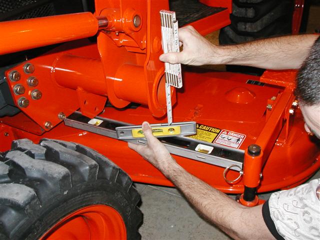

Ok I think ive finally found where the problem is. I have also suffered with a crooked loader and have measured every inch on this loader. I think I have narrowed it down to this. If you measure from the bottom of the cradle bracket to the inside of the pipe (see picture) I come up with a 3/8" difference. Check yours and see what you come up with. I'm calling my dealer tomorrow and getting the rep back out here to get his opinion.

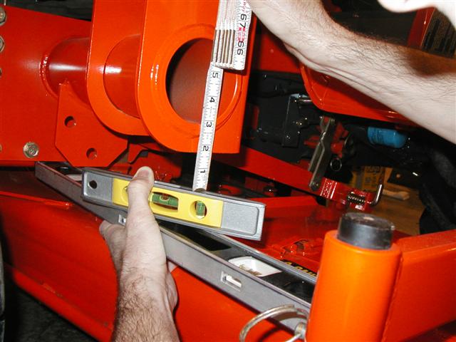

   / B3030 LA403 loader still crooked.... #43
Here's another picture. With the setup I used in the picture I measured 2 7/8" on the left side (sitting on the tractor) and 2 1/2" on the right. That would correspond to the offset of the loader. Maybe we just need a new cradle??

</font><font color="blue" class="small">( Here's another picture. With the setup I used in the picture I measured 2 7/8" on the left side (sitting on the tractor) and 2 1/2" on the right. That would correspond to the offset of the loader. Maybe we just need a new cradle?? )</font>
YEP! The bolt holes in the loader frame are out of position..!! And at 3/8's of an inch difference..ya cant SLOT the holes and use it...or you wont have any "meat" around the top set of holes in it. NEW loader frame!!

Barnboy,
I think you are on to something. I checked the measurements on my loader and it is just a tad over 3/8 difference. When I measured before in this area I measured from the bottom of the plate where your long level is sitting up to the bottom of the tube and it was exactly 4 inches on both sides. So what I think is wrong according to the measurements you found is that the tube is not welded in square to the mounting plate and its kicking the whole left side up and in at the top throwing the whole thing off.
I sure hope this is it.....it makes sense that it would be.
I didn't try to check the actual square of the tube in relation to the mounting plate but it has to be off.

Well thats good. Then the problem must be in the left side cradle. I gave my dealer a copy of this thread friday. He said he was going to take the copy with him to the service meeting this month. I'm going to ask for the rep to come out and request a new cradle.

The more I think about it I guess it's actually possible that the right side might be the culprit and not the left. There really is no way to tell just basing it off the measurement difference. I am guessing the left side is the problem.
I talked to my dealer this morning and he is going to get the service rep's approval to go ahead and replace both sides. /forums/images/graemlins/tongue.gif
