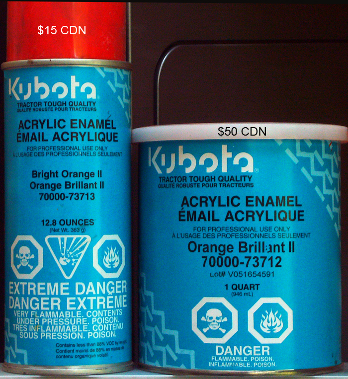

The paint is Kubota 1 qt acrylic enamel p# 70000-73712 ($50) from Island Tractor in Duncan. I had a local body shop spray the new 4N1 (disassembled) after I welded on the chain hooks. There were only a few ounces of paint left in the can.

For smaller projects, you can also try spray cans of Dupli-Color Engine Enamel, DE1620 Chevrolet Orange. I tried it on a small spot on my tractor, and it matched perfectly. It can be found at auto parts stores for at least half the price of the Kubota orange spray cans. I also used Rust-Oleum 7784 Charcoal Gray on my light brackets that I mounted to the ROPS.
I have a can of each of the Kubota orange and grey on hand just in case. I have a landscape rake that I need to repaint because it is painted Case red, so the Dupli-Color will be perfect for that. I hear the Kubota paint is very high quality, but it's too expensive to use on certain implements, so the cheaper paints should work fine for those.

Thanks guys.
I'll get some of the kubota paint for those touchups on the main tractor.
I'll use the cheaper paint for my implements once I find a store that carries those colors.
Right now my box blade is red/black, and my chipper is red/yellow. They will change to orange when my schedule frees up.
Coincidentally, when i painted my JD green ballast box orange, i had a couple cans of the Chevrolet engine orange hanging around, so i used them for the first couple coats. You are right..... the match is near perfect. I used the Kubota orance for the top coat or two....... saving on the overall cost of painting it.

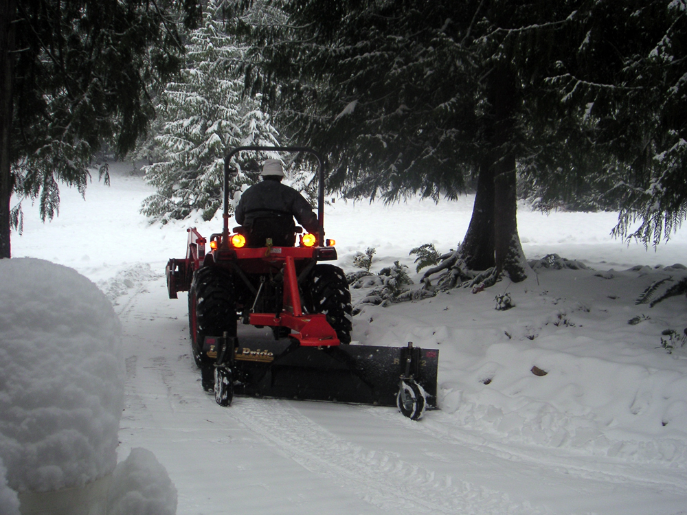

I just realized that I have neglected to post my results from this thread :eek:.
I purchased the Land Pride 2572 rear blade last winter and only got to use it once albeit with great success. Twice already this winter and it still works like a hot **** :thumbsup:.
I have "top and tilt" hydraulics on my 3 point with full float on the tilt. When I'm plowing I adjust the setup below using the top cylinder for gravel clearance of about 1" and lower the 3 point position control all the way to float and the tilt cylinder to float as well.

I am looking to add wheels to my blade. I have a set on my rake so I just need to add the mounts to the back of the blade. I bought skid shoes but they still tear up the ground. Maybe this will instill some urgency in my project!! Or, maybe not!!

In response to a PM that is worth sharing: "Saw your comment about wheels on a blade for snow removal. Where would I look to purchase something like that? I have a Land Pride RB15 blade."
Reply: "You'll have to make your own mounting bracket as I did but much simpler than mine since it doesn't need to be adjustable, just tilt your blade to adjust blade edge ground clearance. Weld on 2 horizontal plates with a vertical support struts to the back of the blade and you are done. Set the caster height to give 1" blade edge clearance with the blade vertical. The wheels (STY103-***-SS-T) came from Algood Casters in BC Canada, page 24. The original wheels and pneumatic tires eventually self destructed so I switched to rigid, sturdy steel wheels and they work."
Word of caution: raise the blade before backing up or you will bend the caster assembly. Alternatively, you could extend the mount rearward with a longer and stronger bracket so that the caster can make a full rotation without hitting the blade ;). The down side of this is there will be more scalping on uneven surfaces and changing grades as the distance between blade and wheel contact increases :confused2:.
