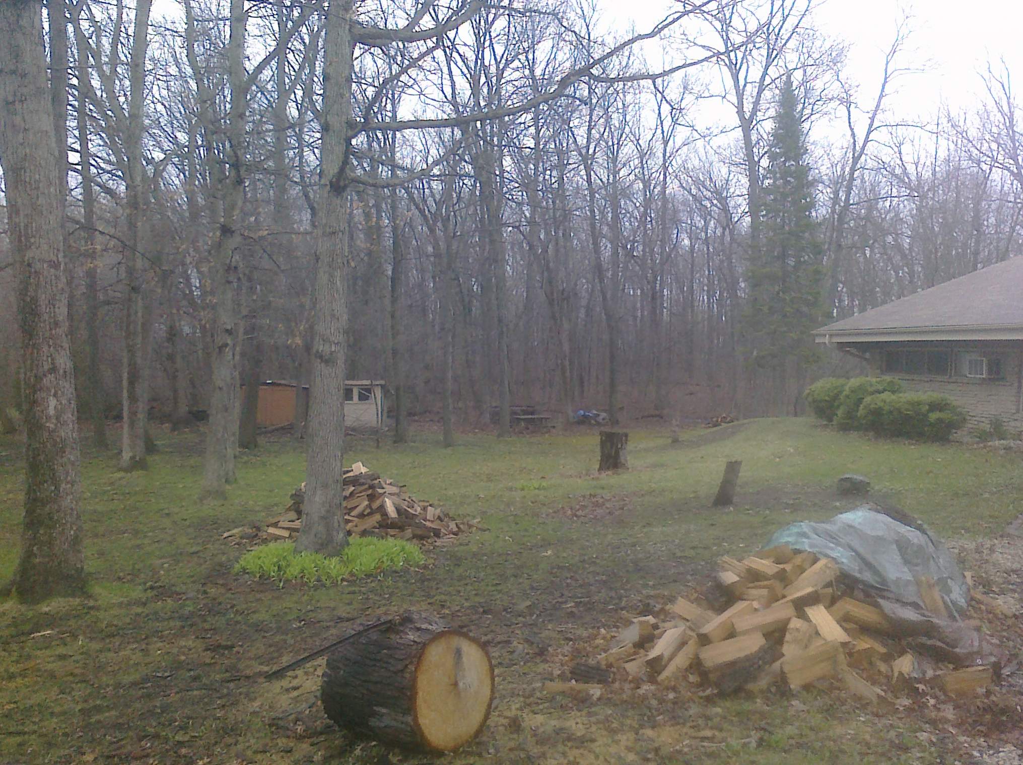

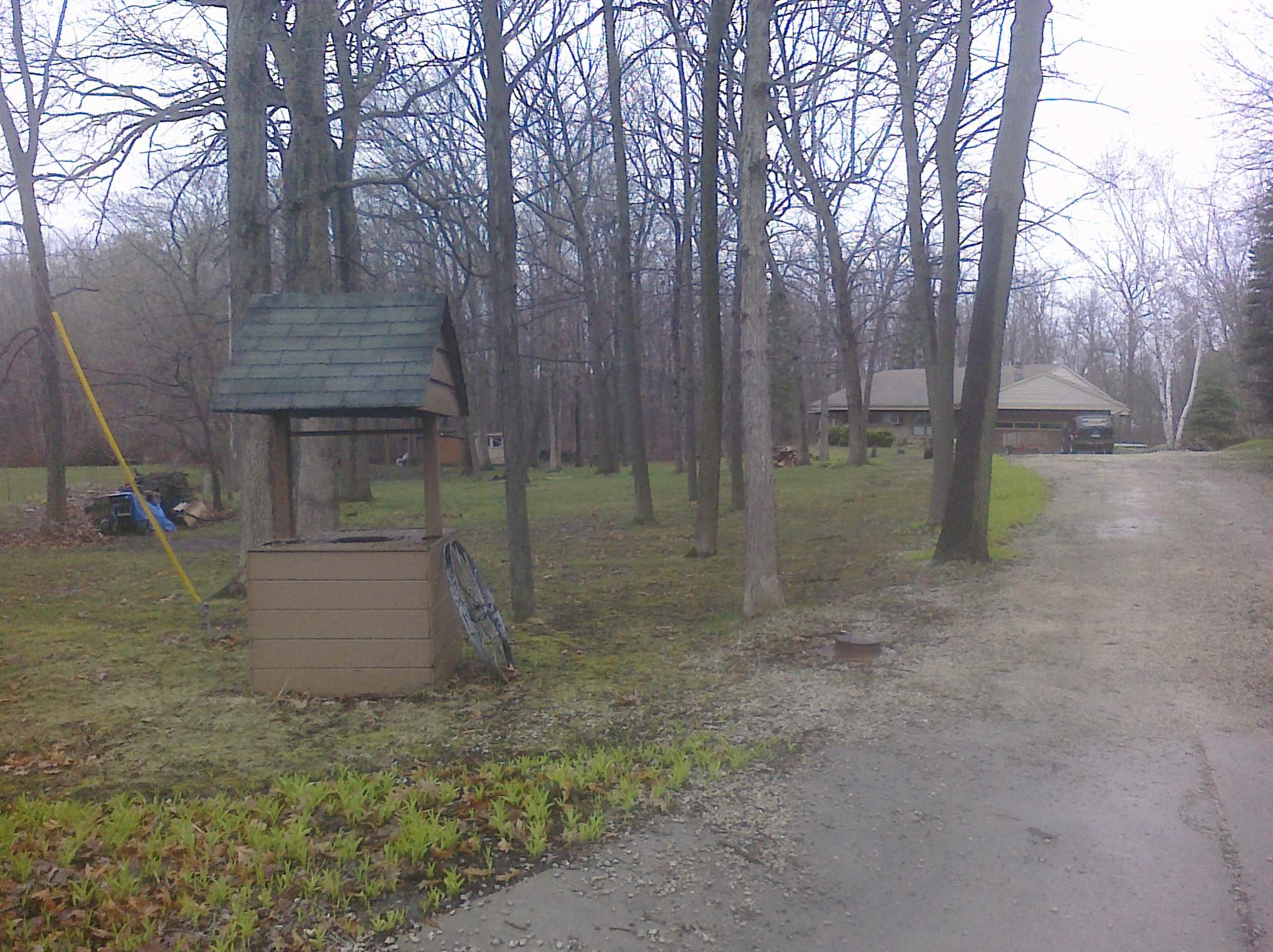

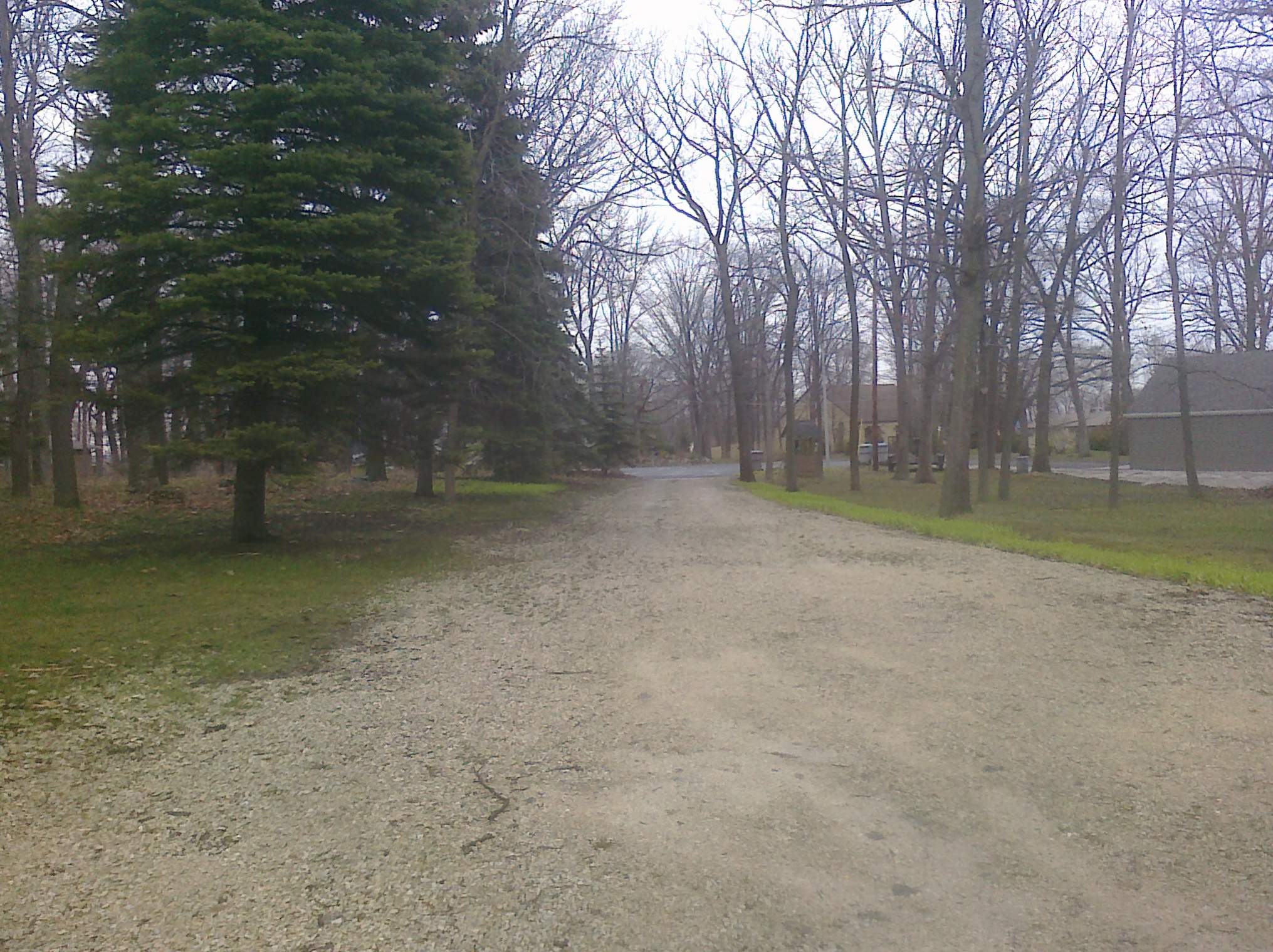

Hello to all,
Hit the wrong button didn't get a chance to write anything:ashamed:...
Here is what I meant to write... I have 2 acres of wooded property which I have alot of landscaping to do and lots of time to do it. I will be adding 200 plus yards of fill, topsoil, seed, etc. I want to push my woodline back which means clearing aprox 1/2 acre of trees mainly 2-6" diameter, clearing site for 24x30 slab, maintaining 200' gravel drive, grading, snow removal (blade). and firewood hauling. I also maintain 60 acres of hunting land with friends in which we brushhog trails and hopefully create a few deer plots next year. We have been borrowing a friend's tractor 6000lbs but it is a chore to arrange this and the vehicle/ trailor to transport this much weight 200 miles one way. He does have every 3 pt implement I could ever need just laying around and even a backhoe for the really big jobs at my property:D. I was looking at the B series for the size around my house but feel they may be too small for the hunting property. I saw the L3800 and it is just a little bigger footprint but 800lbs heavier and may work better for land maintainace and still light enough to tow. Brush hog is 5 ft HD and currently on hunting property. I was wondering if any b3200/ b3030 owners have used them for deer plots, etc and found them too light or underpowered( pto wise):). I believe the L3800 wound do the job but unsure if it would be a hair too big to be productive on my 2 acres. I don't plan to mow with them. The price of the B3030 and L3800 are fairly close to each other. Thanks for reading and any advise on these units. Pictures of my home lot are below

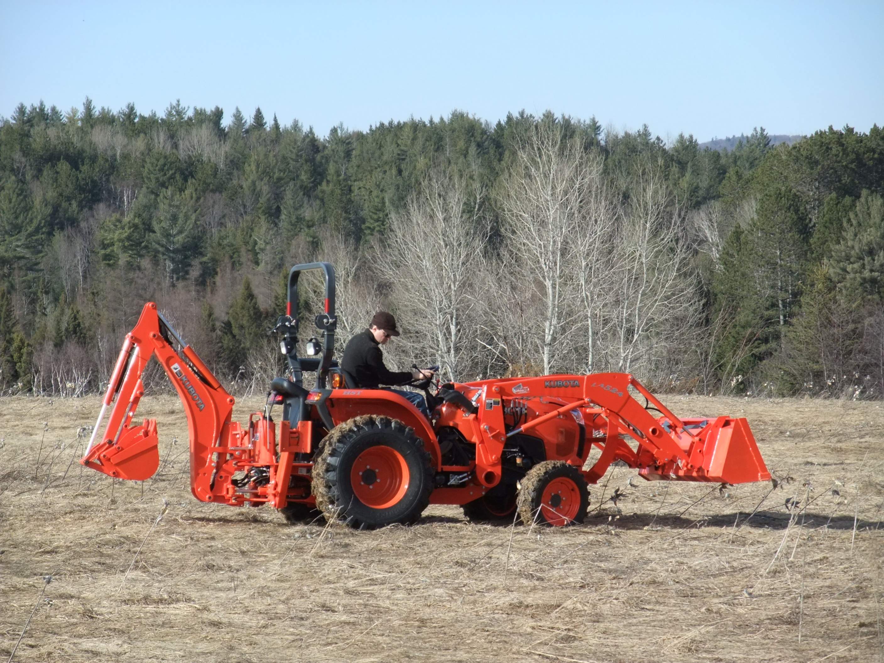

I was facing a similar choice recently, and I opted for the L3800HST. It looked massive in the showroom next to the B models, but in the field it isn't. It's just right for me. And once you start moving dirt with the FEL, it seems pitifully small :laughing:
Go for the bigger model, you won't regret it.
