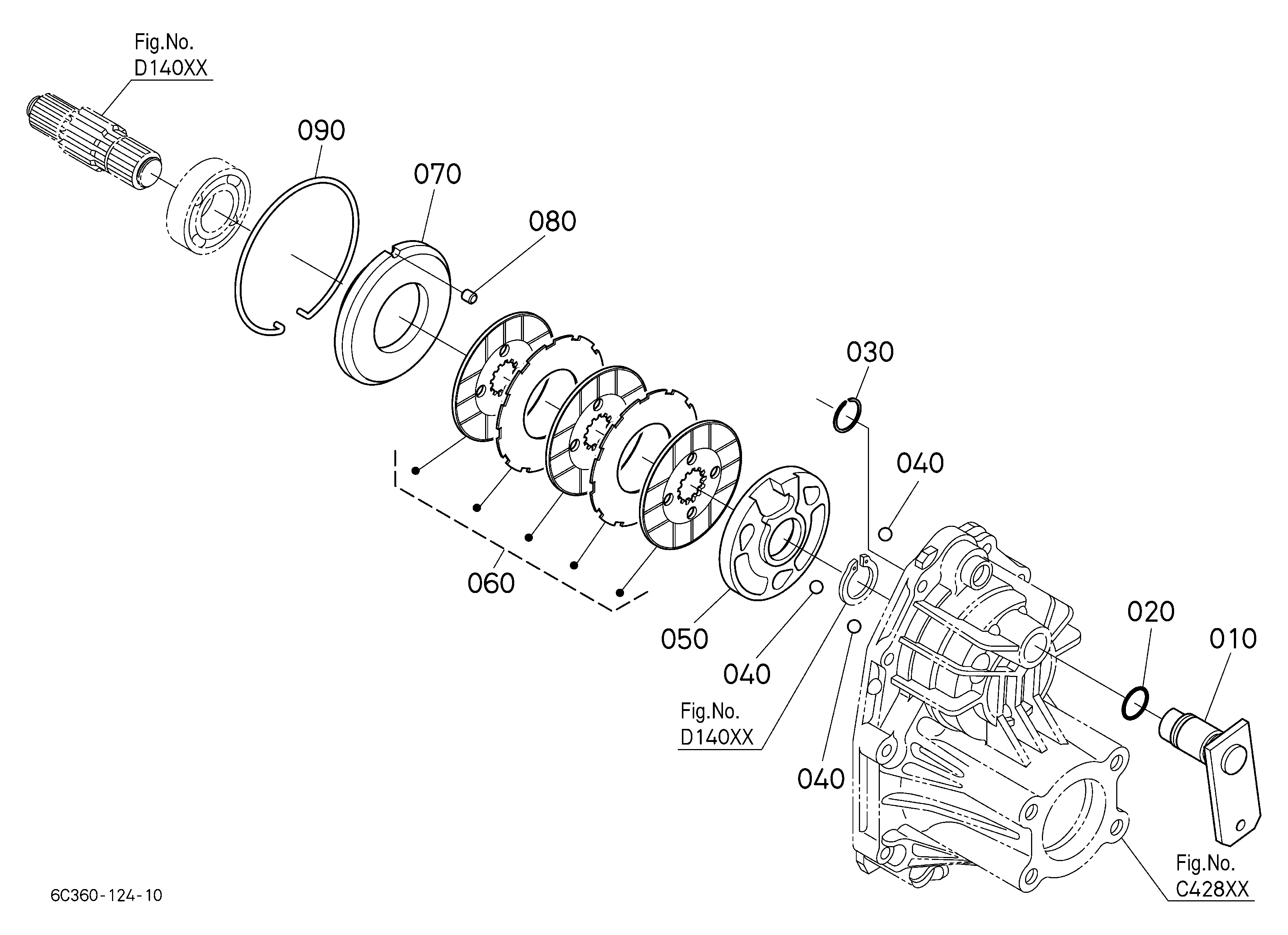

It is just above the pto shield and to the left.
Yellow in color.

Is that picture a B3200? I don't have a dipstick on my unit. I opened the fill port and it was dry. I put a gallon in and looks like it will take even more. Damn.

Yzxxxxx - I confirm that's a picture of a B3200, with the dip stick highlighted.
Probably good to not put in more UDT fluid, until you have established the correct fluid level from a dip stick or sight glass. HST should not be overfilled. Gear transmissions should not be either, but it is less critical with a gear transmission.
