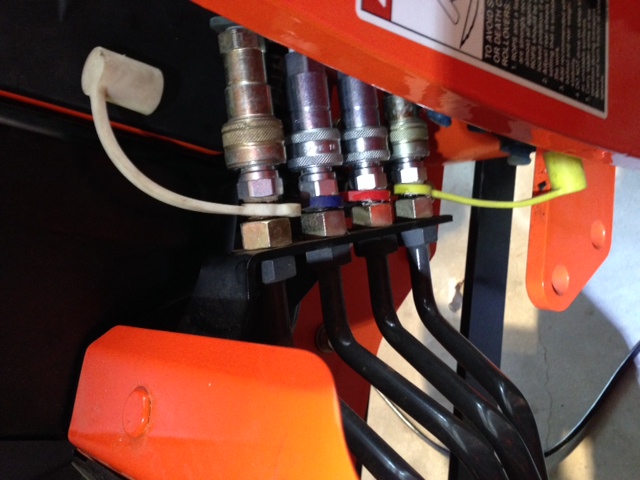

I recently bought a Kubota snowblower (used) for my B3200. I installed the blower and discovered I had no place to hold the handle for the chute, so I decided to install a hydraulic motor to rotate the chute. Kubota wants about $900 for their kit, I decided to buy the pieces separate and put this together myself (saved $500), the idea came from a tread here on TBN!
So here's my question, When I first installed the blower I hooked the hydraulics up to lift and lower the blower like my FEL, pull back on the stick and push the stick forward to lift and lower. When I hooked the motor to rotate the chute I connected it to the other circuit, but I could only get the motor to spin one direction. I thought maybe I bought the wrong motor and it only rotated in on direction, but after calling the company they said no it was bidirectional. I hooked the motor up to the 1st circuit (lift/lower) and to my surprise it worked fine. I hooked the lift/lower lines up to the 2nd circuit and that works. So now I have to move the stick left/right to lift or lower the blower and pull back or push forward to rotate the chute.
Why won't the motor work both directions on the 2nd circuit but works fine on the 1st circuit. So in the picture the motor is connected to the white and yellow line and the blower (lift/lower) is connected to the red and blue and everything works but not in a manner that is very intuitive for using the joystick.
Thanks, wayne
