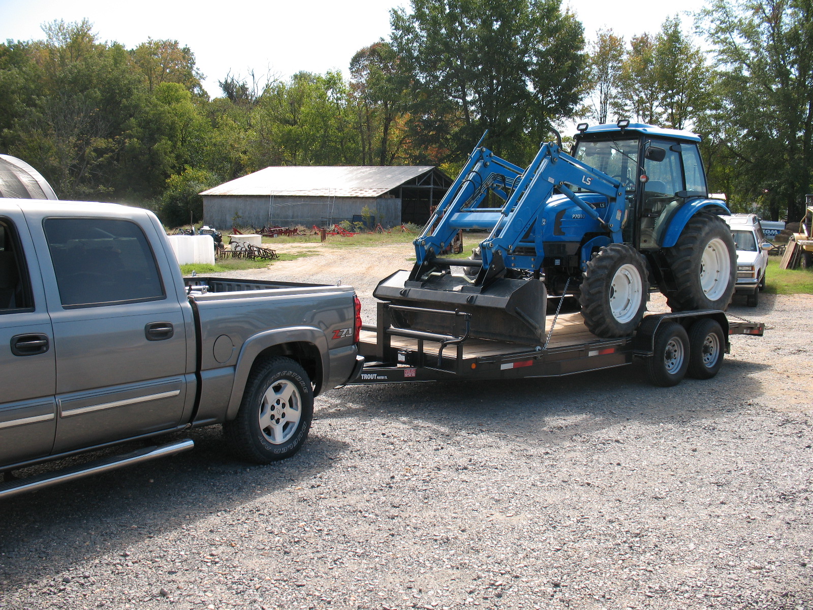

IMG_1135.JPGWell what did you decide to get? I will throw my personal experience in here also. When I went trailer shopping to haul my B26 about 600 miles when I bought it, I looked for something that would also haul my LS P7010. I went with a 18+2 foot dove tail with twin 6K axles with brakes on both axles and a heavy duty center mount jack, 10 ply tires with a spare, rear slide in ramps. It will haul all my truck is rated to pull and then some and not be overloaded. The trailer weighs in at around 2600# and my limiting factor is 960# of tongue weight for the factory hitch without a WDH. I can accomplish this with no problem hauling my LS with FEL on it without a problem and the trailer pulls like a dream loaded or unloaded. I have a photo of it with my LS loaded on it. As you can see, it has plenty of room to balance the load and not overload my hitch. With it positioned as in the photo, everything handles extremely well, just like not having anything on the back except for the extra power needed to start and stop. The electric brakes on both axles mean that I don't need to use my trucks brakes hardly at all to stop. I just set the trailer brakes to do most of the stopping.

View attachment 469332Well what did you decide to get? I will throw my personal experience in here also. When I went trailer shopping to haul my B26 about 600 miles when I bought it, I looked for something that would also haul my LS P7010. I went with a 18+2 foot dove tail with twin 6K axles with brakes on both axles and a heavy duty center mount jack, 10 ply tires with a spare, rear slide in ramps. It will haul all my truck is rated to pull and then some and not be overloaded. The trailer weighs in at around 2600# and my limiting factor is 960# of tongue weight for the factory hitch without a WDH. I can accomplish this with no problem hauling my LS with FEL on it without a problem and the trailer pulls like a dream loaded or unloaded. I have a photo of it with my LS loaded on it. As you can see, it has plenty of room to balance the load and not overload my hitch. With it positioned as in the photo, everything handles extremely well, just like not having anything on the back except for the extra power needed to start and stop. The electric brakes on both axles mean that I don't need to use my trucks brakes hardly at all to stop. I just set the trailer brakes to do most of the stopping.

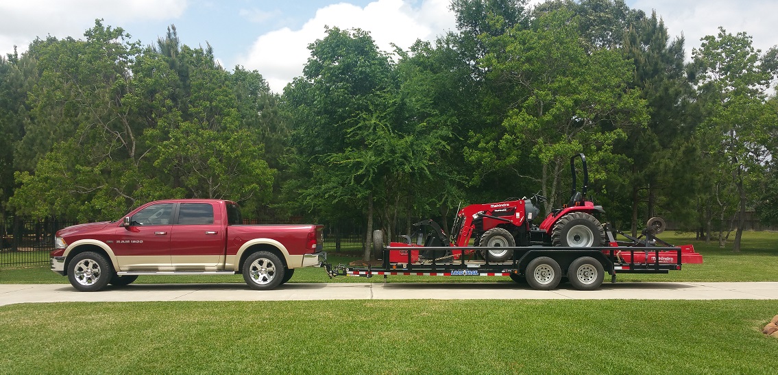

I think that will work well for you. I was in a similar spot on needing the space to move the whole kit around from home base to property, and ended up with a 20' trailer, but I think my spread is a bit longer than yours all, so the comparison still works. (The 2538 has a compact wheelbase, but it is a 6' cutter and when I'm in beast mode the box blade occupies the first bit of trailer deck space.) You can have a few feet of well secured load/implement off the back off a trailer in Texas at least, and by pulling up the tail wheel you'll have lots of flexibility. That is exactly what I do as in the pic below.
Enjoy your new rig! If you get pictures of your spread loaded, please do put them here and in the hauling rigs thread. It might help others looking to decide on the best haul rig and trailer combo! http://www.tractorbynet.com/forums/trailers-transportation/104218-your-towing-rigs-trailers.html
