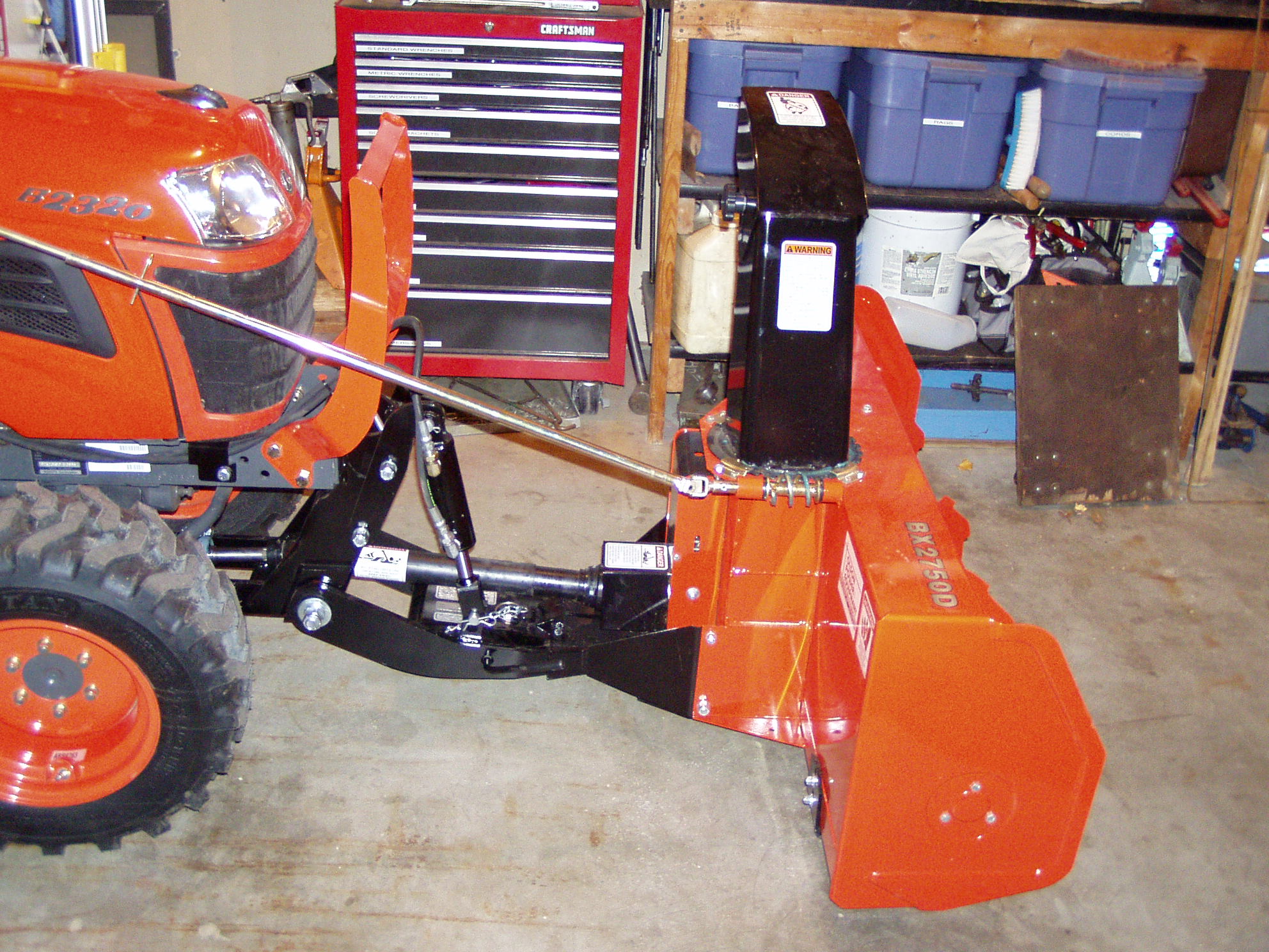

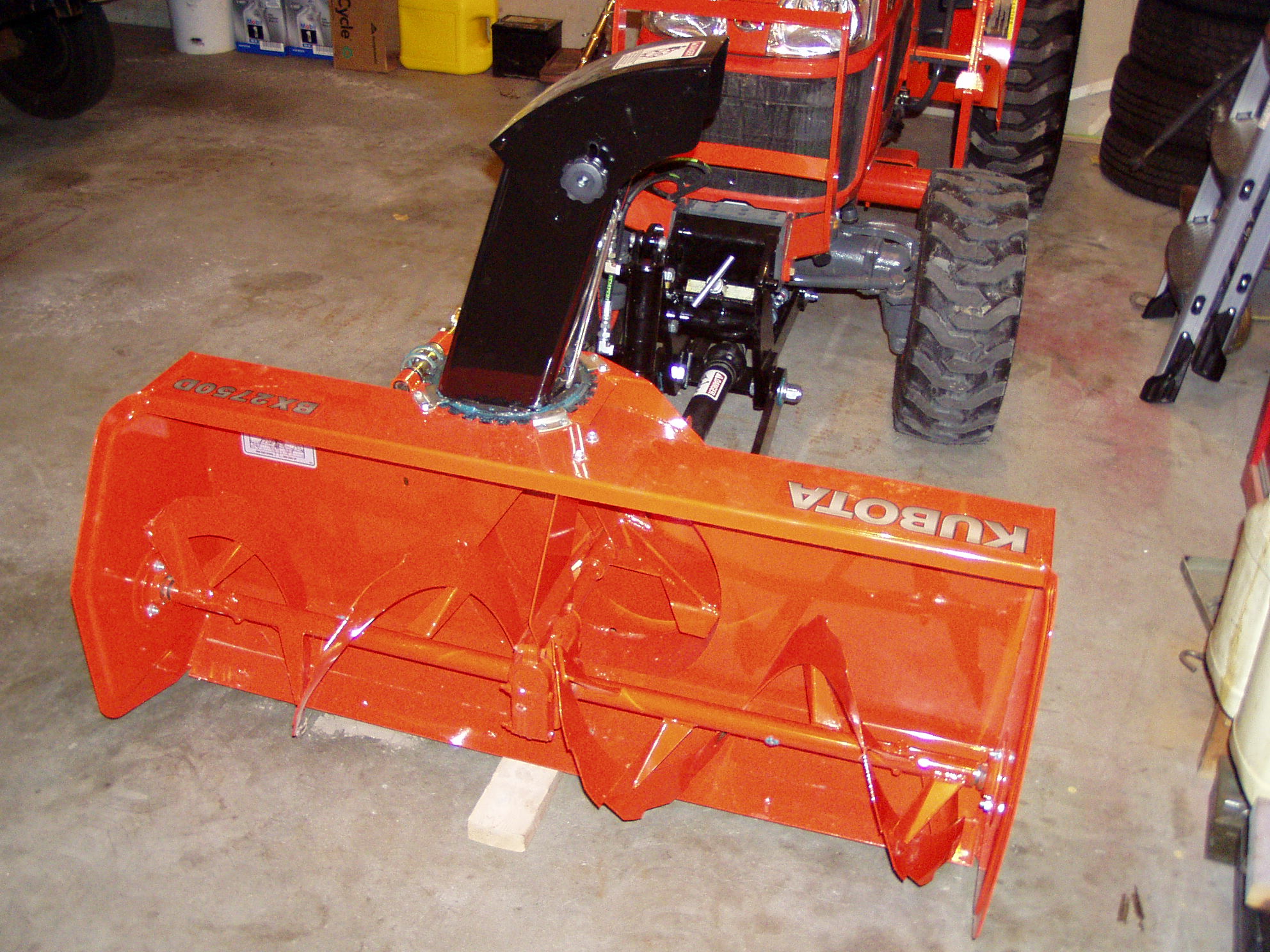

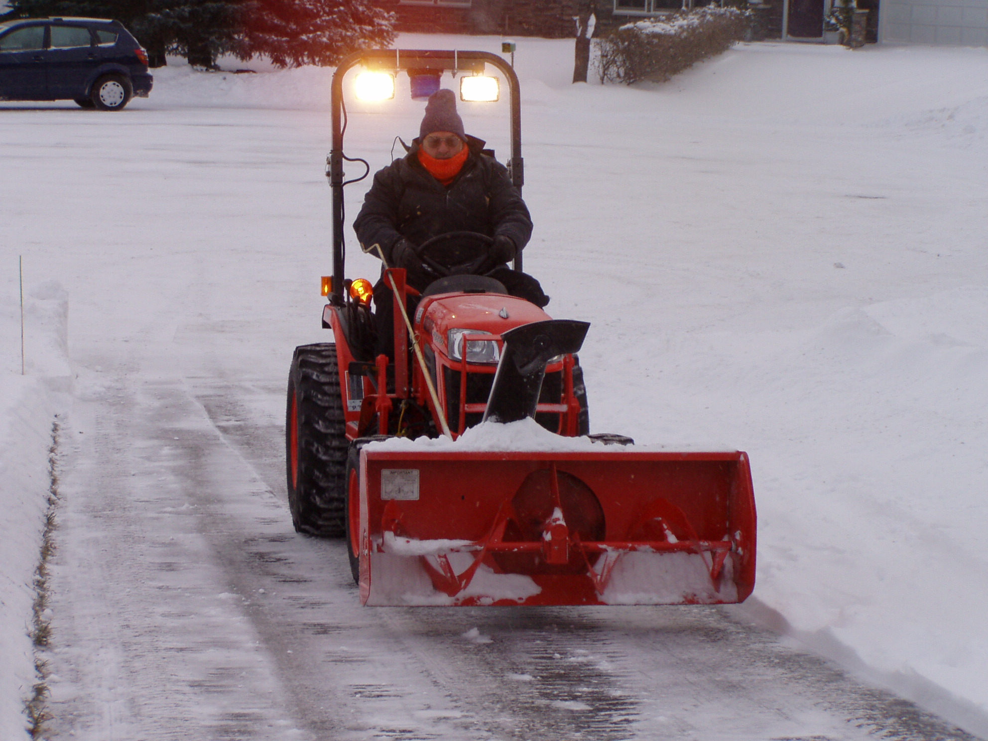

The blower on my B2320 works great. It is the best thing that I have bought for my tractor. I also have a front blade too. The blower works good for snow, you can move pretty quick and get the snow moved away so you don't have to worry about running out of places to put the snow. The blade works good for scraping the paved driveway when there is a sunny day or when there is some heavy slush or almost liquid to mov e out of the way. The entire quick hitch and blower blade come on and off really easily.

If you're dealing with slush, the blade is your best bet. The snowblower is either going to clog or not blow it out of your way. If you don't have to snowblow often, a rear blower will save you some money and allow you to keep your loader mounted for dealing with occasional slush. The front mounts are really expensive when you add everything up (4-5K). Good luck to you.
   / B3230, can it use or is it worth getting a snowblower? #7
The blower works ok for the wet snow. I have cleared the wet slush stuff that you get at the street from the plow. You will need to have the chute deflector tillted up to avoid clogging. I ussually have the delfector all the way down when blowing snow and it still blows it pretty far. I have even blown back the snow banks and plow piles will little effort. The front quick hitch setup it great. I can take the loader off, put the quick hitch on and attach a blower or blade in minutes. I can send more photos of this if you would like. I got front mount implements becasue I did not want to look backwards all the time and because the total length was less that a rear blower and made the tractor easier to manuver and better traction. The rear blower will take weigth off the front end when I is raised. A loader will mitigate this some.
Here is what my snow equipment cost;
B2733A Quick Hitch $821.51
B2734 Mid PTO $360.64
BX2735 Front PTO $150.88
BX2750D Blower $1628.40
B2733A Blade $1128.00
BX2762 Skid Shoes $115.92
Be aware some of this snow equipment may be a little hard to get right now. I would not compromise and get something to get by though, I would wait and get what I wanted.
