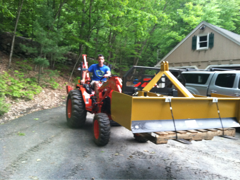

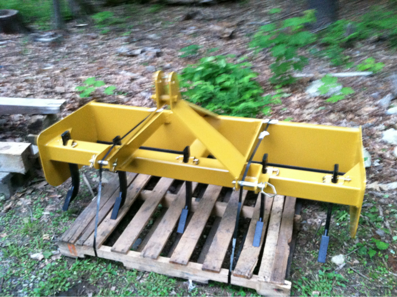

Just got my EA 66" box blade!! Gotta try it our soon!
