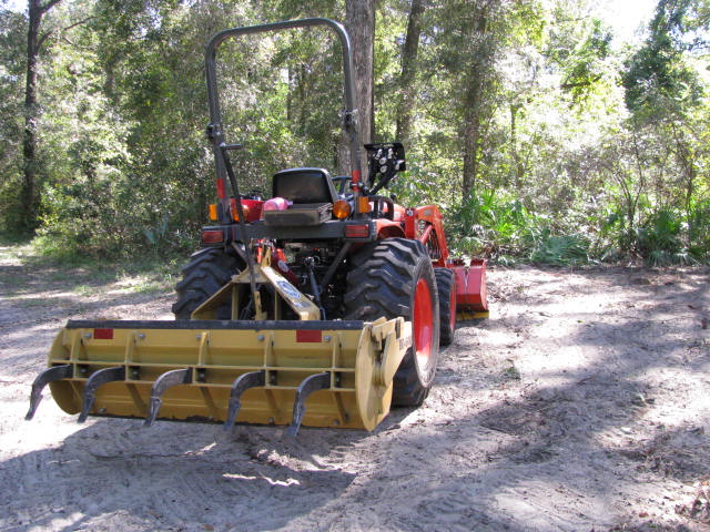

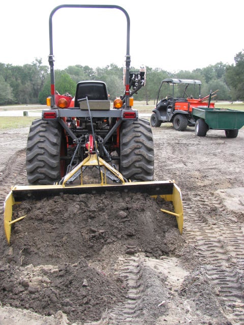

As you surely know, the three point hitch applies NO downward hydraulic pressure, so the weight of the box blade is a key factor in how well it will cut. Buy a box blade from 550 - 650 pounds if you can afford it. Ag tires will pull somewhat more than industrial tires but 650 pounds is still max.
Be cautious when pushing LOOSE dirt in reverse. ( Believe me; I have experience. ) Pushing it is easy to bend the factory check chains/turnbuckles which weigh 3.7 pounds. As Kubota is metric, you cannot go down to the local hardware store to buy replacement bits out of hardware parts bins. Consider aftermarket rigid check chains/stabilizers from Stabilworks. Stabilworks mech really simplifies mounting attachments. Mine weigh 14.4 pounds. Two rigid bars serve to reinforce the bottom links too.
I temporarily replace Kubota factory Top Link with a "Hydraulink" when I am going to use the box blade. Hydraulink works better with some implements than others; it is BEST with a box blade. It is not as good as a hydraulically controlled top link, but it may be 80% as good with a box blade. Use search function on T-B-N for "Hydraulink". Lots of posts.
Restrain yourself on width. You have to maneuver that ponderous thing back there. Stay with 60" (+/-). You will lose traction before you can fill a 72" box blade.
Once you purchase a box blade it takes 5-15 hours to learn to use it with some proficiency. Be patient. To get a smooth path when finishing, take SMALL bites with the box blade.
