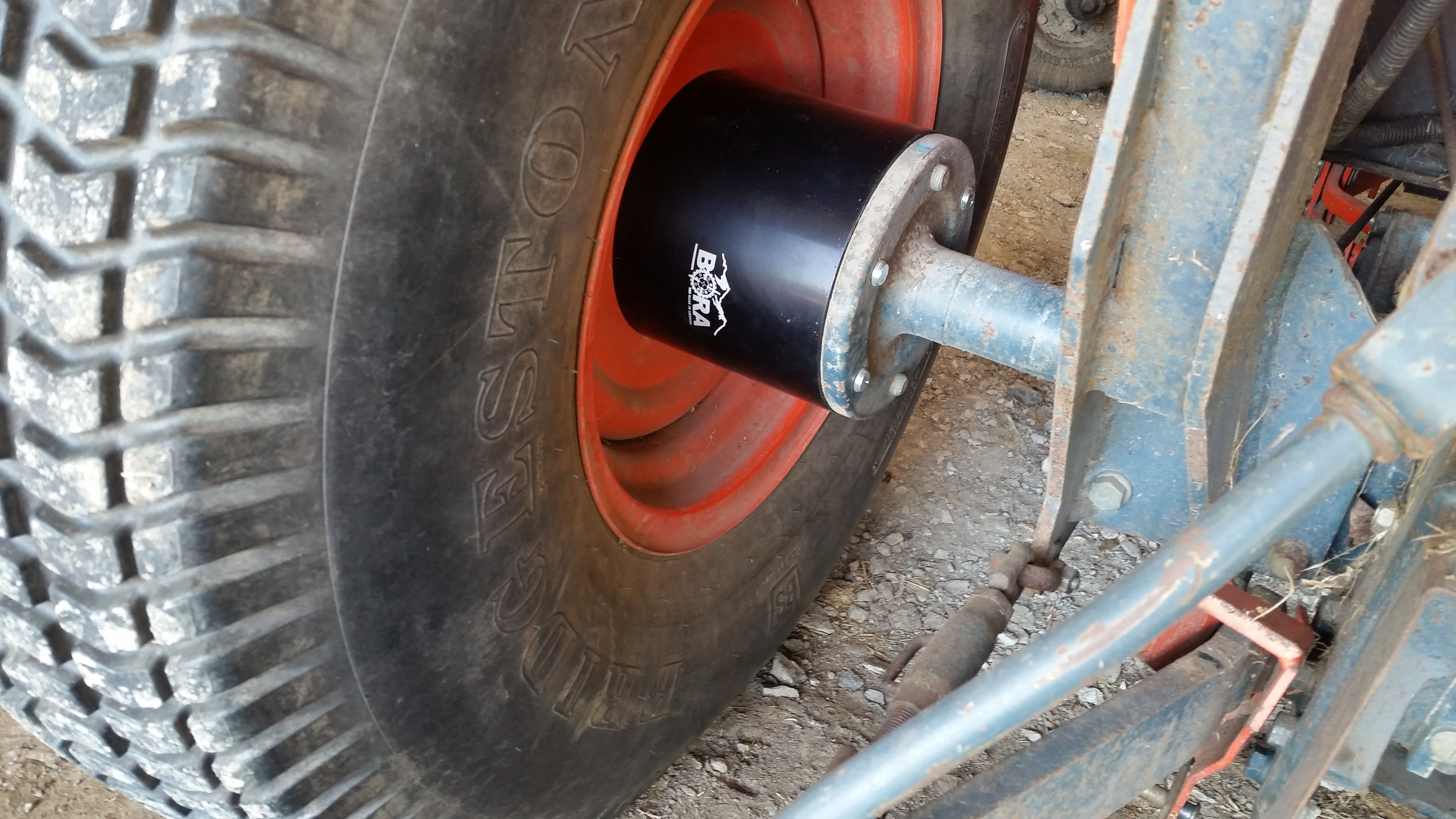

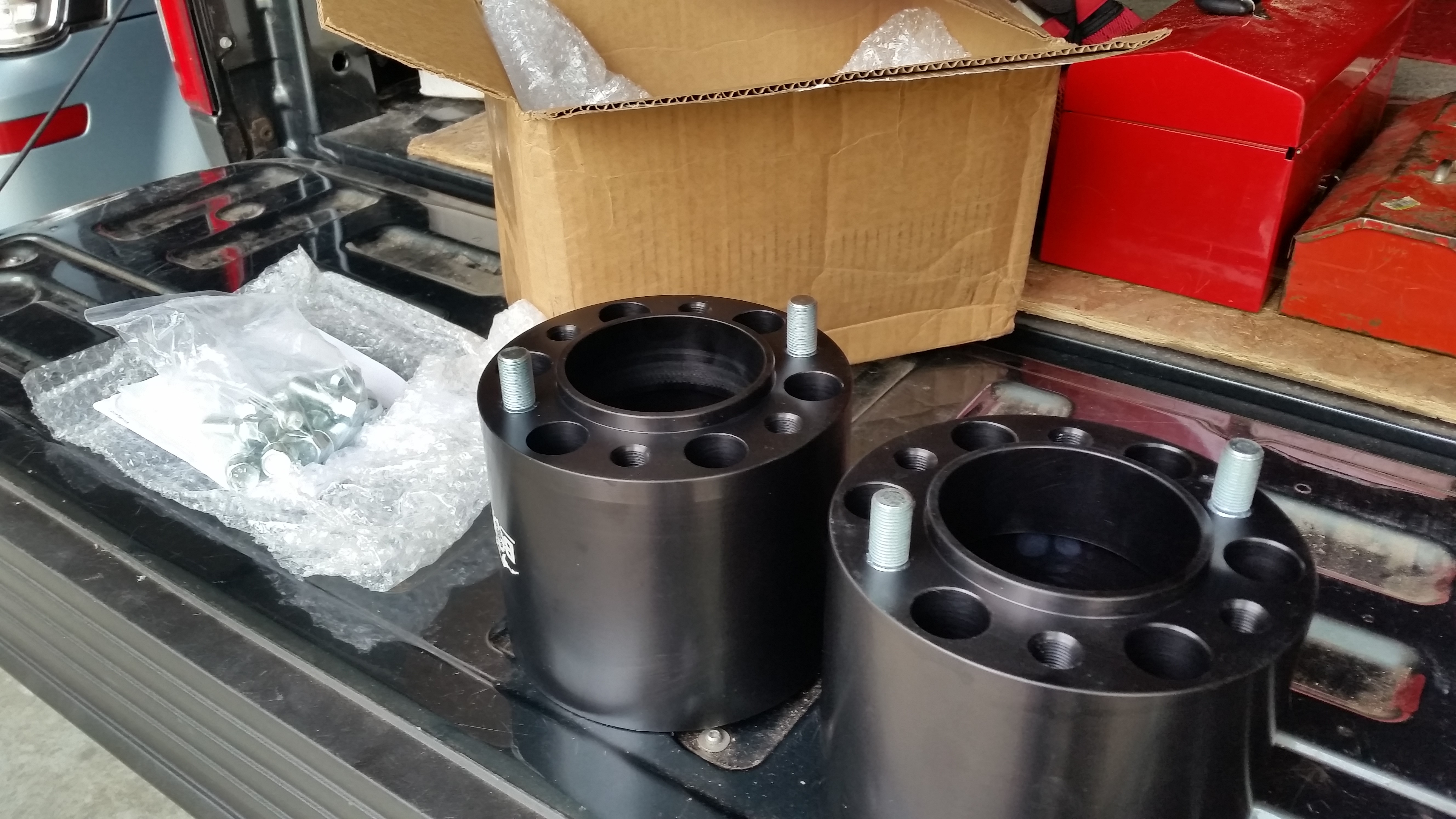

The B2150 is plenty heavy and powered well for that duty. Both the B2150 and the B3350 are 4cyl which I claim does matter in many subtle ways. BETTER power. Your B3350 has more power (partly robbed by the HSD but still plenty) and is heavier. I think you will have zero problems and would in fact be robust for the application you describe. That said, especially compared to the good old 8N, you will find any Kubota unstable on steep ground without wider rear wheel separation. I strongly recommend wheel spacers.
The ones I bought are Bora brand ( and I recommend them highly) but I also hear good things about other brands including Bro-Tek and Hansen. All of these are machined from solid chunks of aluminum. Other brands are welded construction with plates separated by tubes (and friends of mine have those on a Kubota 3400 which work quite well. Mine are 6 inches per side for a total added wheel spacing of a foot (so are my friends units) and I find that works well. In my view it is not worth it to add just a few inches.

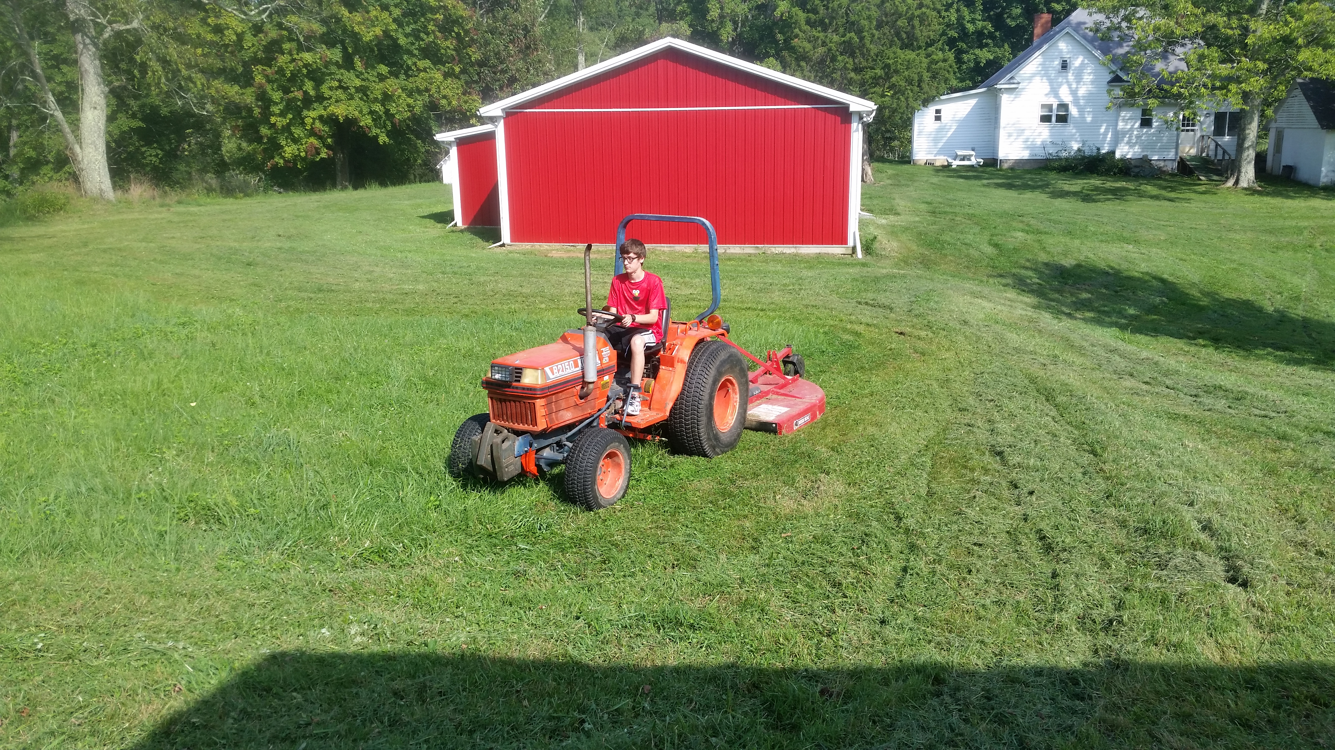

If you get a loader the front weight situation is thoroughly taken care of. I do not have a loader on my B2150 that uses the 5ft hog. I do have 3 suitcase weights on the front but they are only 55lb each and not stuck very far forward. My 2150 is lighter than the 3350, the hogs are about the same weight. Nothing seems at all marginal or out of balance on mine. You just will not have a problem. BY THE WAY --- my goodness, if you are seriously considering buying one, put a 700lb hog on it and go test drive it first !!
Here is a picture (grandson driving) before I put the wheel spacers on. You can see the weights up front.20160819_164707.jpg
Here is another pic after the wheel spacers were installed and the hog is lifted. 20160831_183920.jpg
