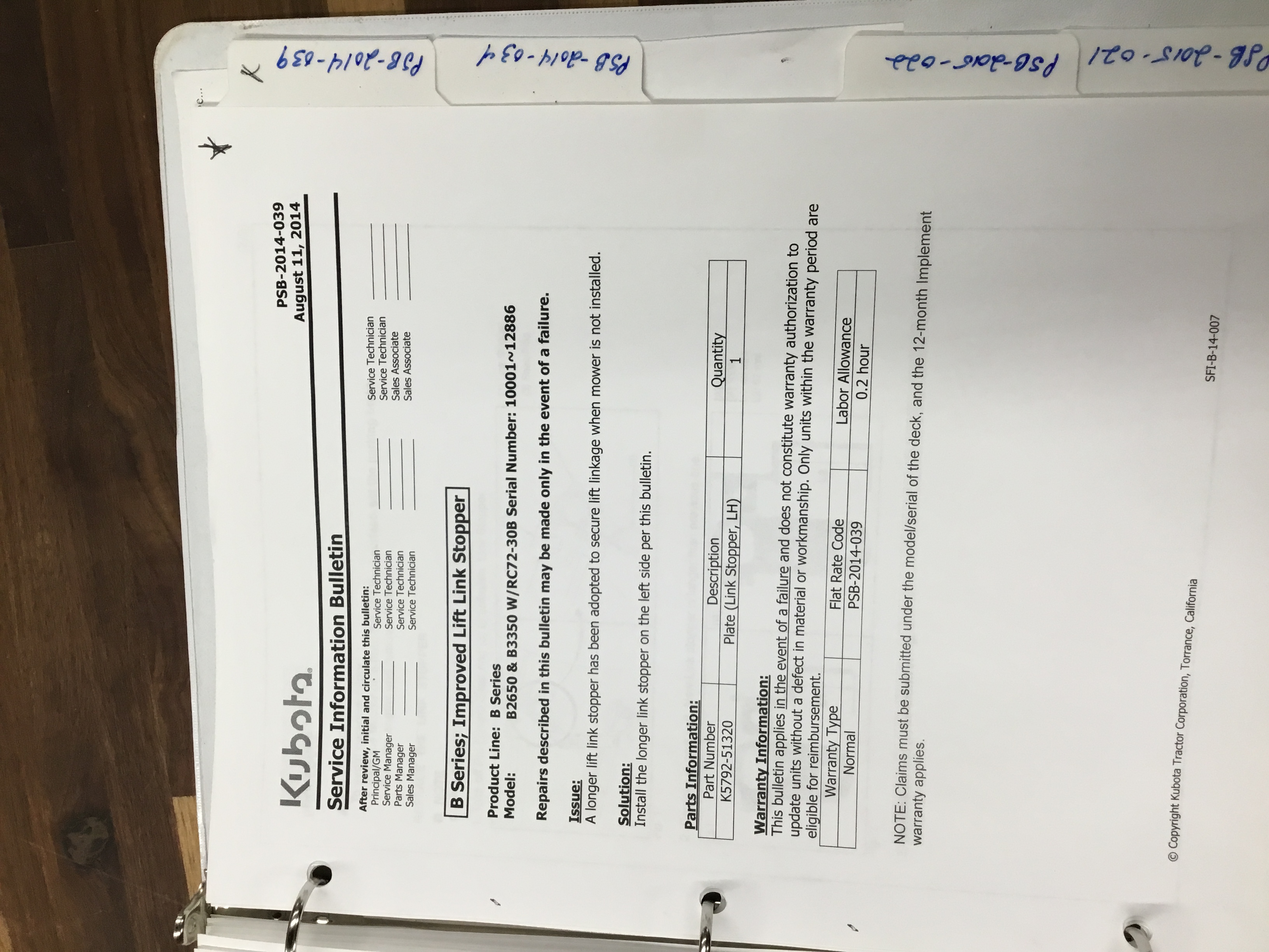

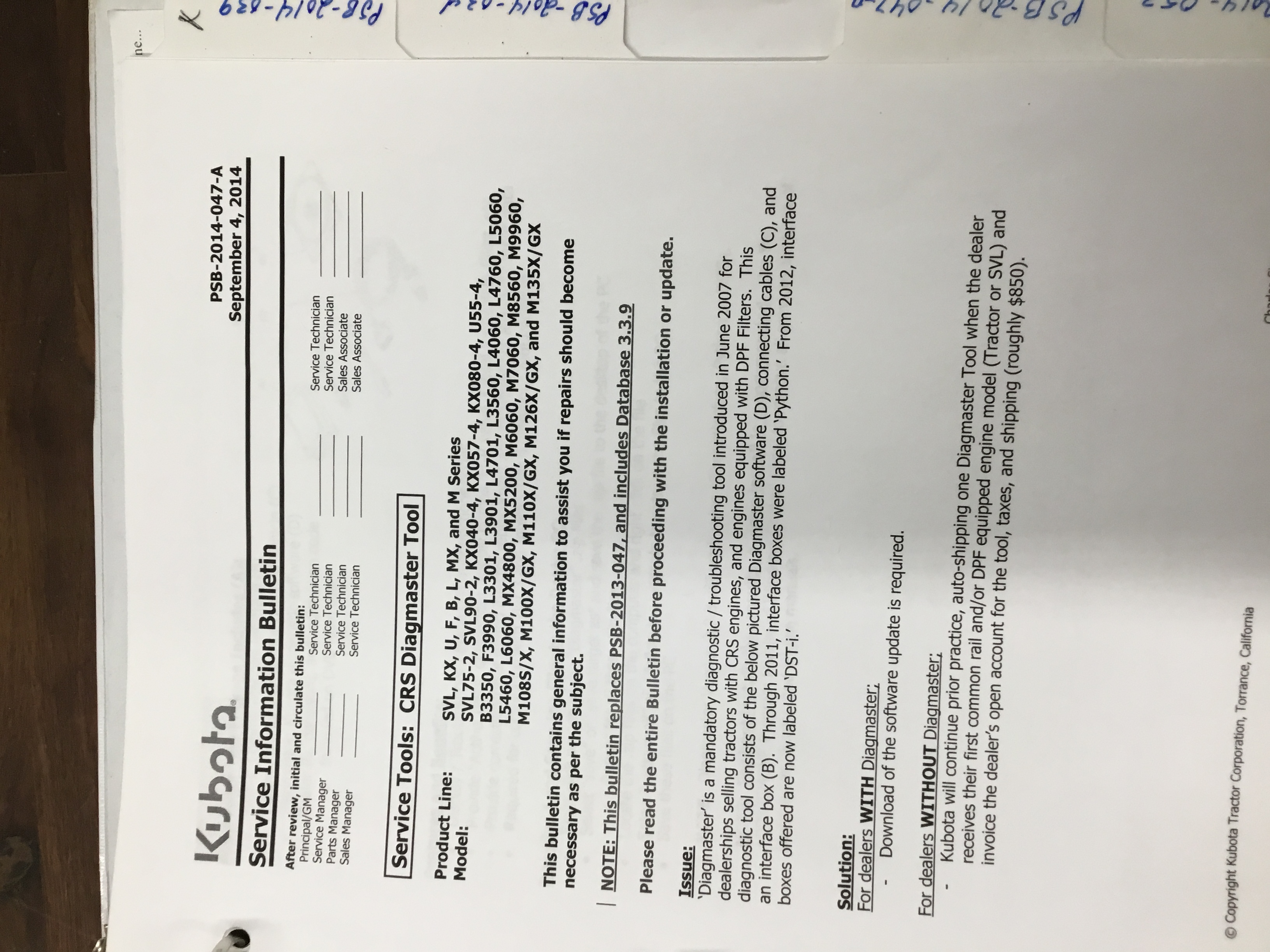

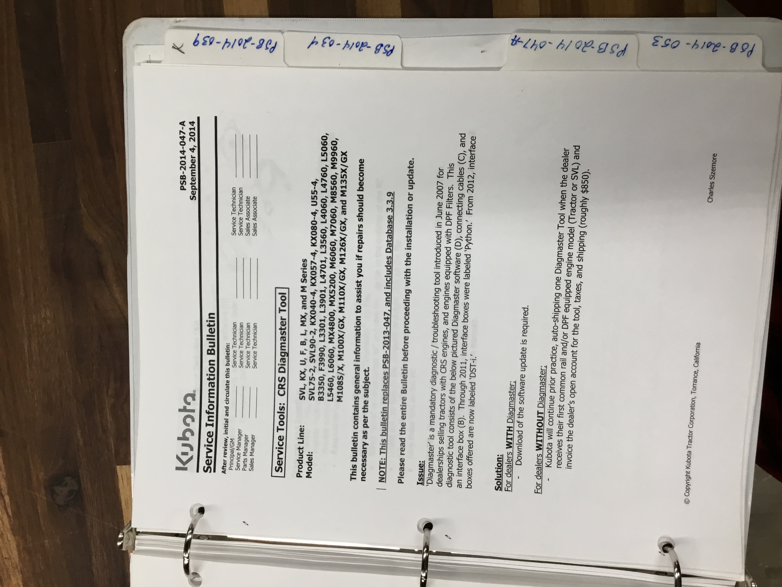

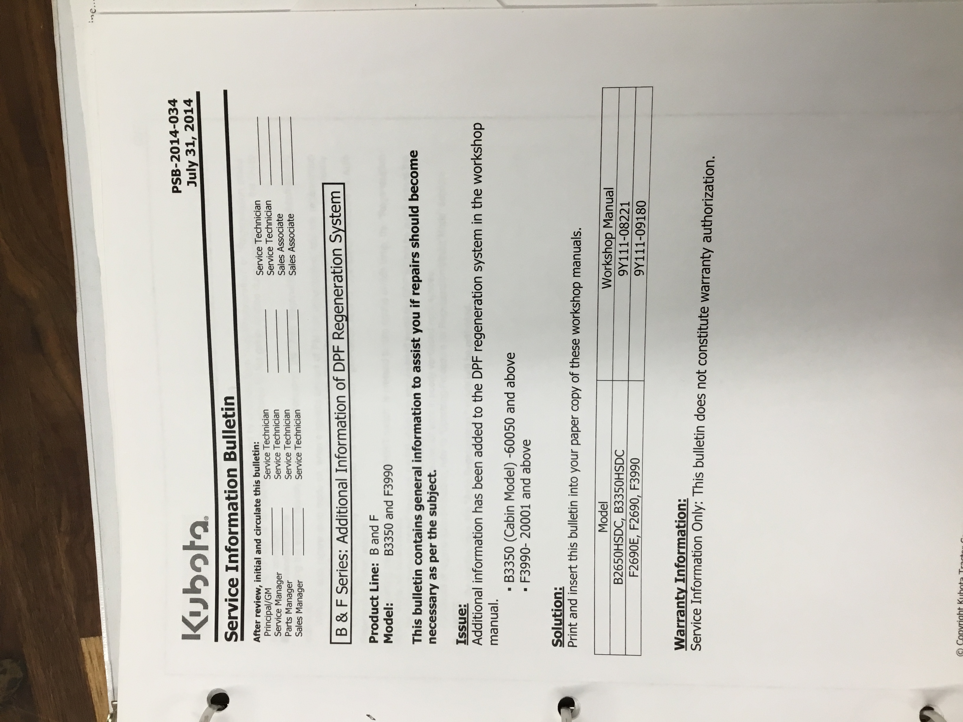

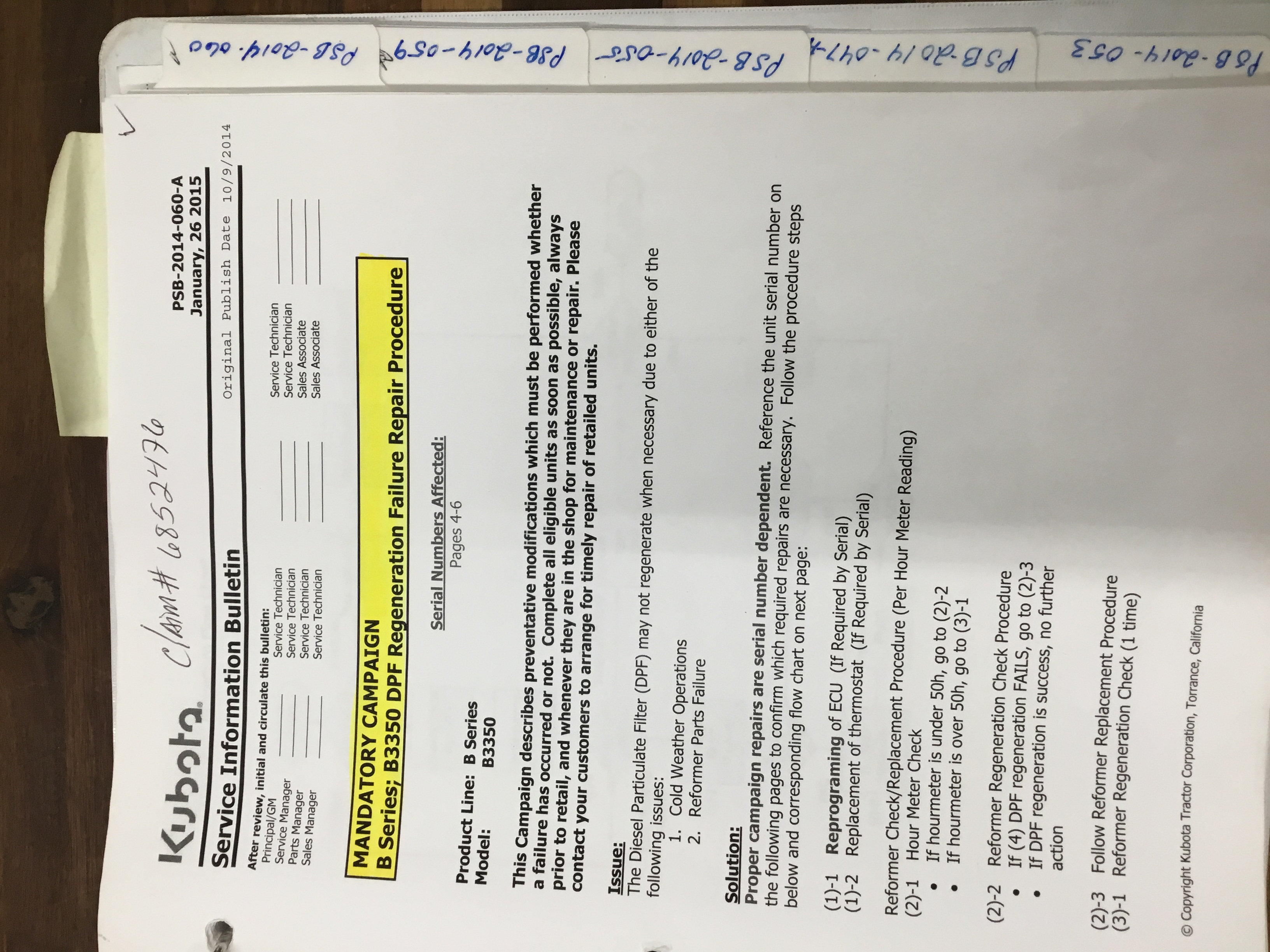

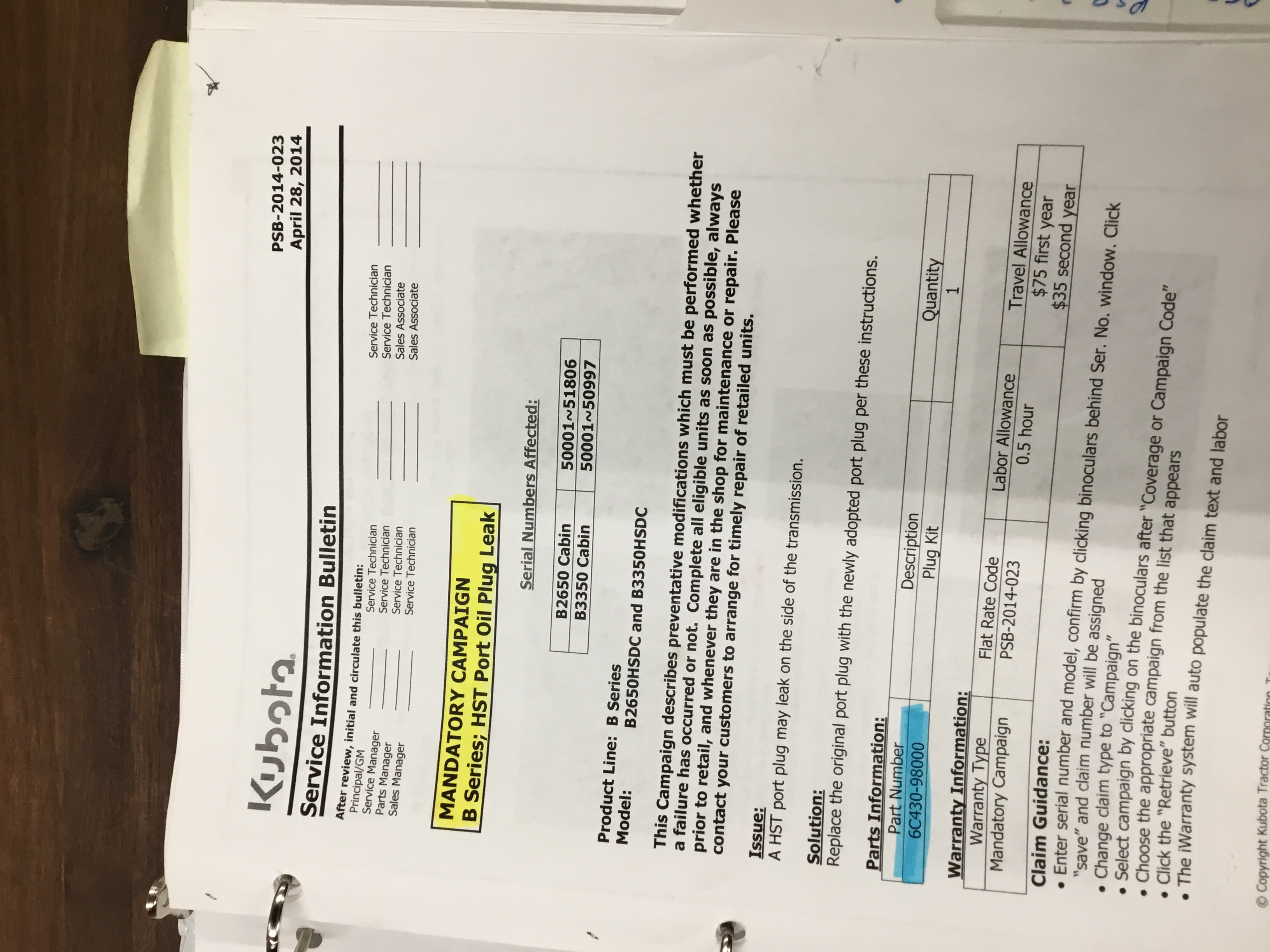

I stopped by my dealer and photoed my service bulletins. The most recent sb is about the rear axle leaking. My serial number is 50512. 4106C559-98D9-492D-9A3A-CADBA74D6AAD.jpegDB63F457-E054-43A7-B44A-5F5772D39A4C.jpeg0267A6D0-93F5-44F3-ABDC-B330182ED7A4.jpegF9AB86AC-E63E-4935-9DFB-D1486DF3F902.jpeg503A4562-943B-4B36-A270-BD4C9EC179D8.jpeg1FB745B2-A6AB-4810-ACDA-4FBE20829169.jpegBEBE15FE-4964-4D01-8A68-234F865BA50B.jpeg8208A65C-4ABF-4736-B025-D0438F7D7DE5.jpegCD119146-640C-4937-BCAB-C40395D01AAF.jpeg49674734-A51A-4B0E-8BE5-E42833E08D46.jpeg
/ B3350SU Regen issues continue #11
Of the 10, 4 refer specifically to new service information and diagnostic tools, not machine shortcomings. One refers to the removal of protective plastic film placed over the instrument panel prior to shipment. Two are specific to cab units. There are more recent bulletins regarding regen issues that you don’t have images of.

Rickb, can you get images or numbers of the more recent sb on regen?
Not until Monday. Typically updated info on a particular issue or concern retains the original bulletin number but has a suffix indicating the revision number. A search for updated info for a known bulletin number would simply include the base bulletin number. The search function would locate the latest version.

Rb,
Thanks for all this effort. I did see that some don't apply, but one that might. I'll print a couple of them and see of they can at least attempt a re-program if my serial number matches. Its VERY helpful to have a piece of paper to show them.
Thanks Again!
Randy
