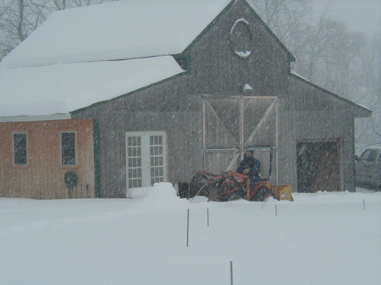

I Have a B6100 also - 1978 vintage. I use it for EVERYTHING. I have the B219 FEL that runs off of a hydraulic pump mounted to the front PTO.
I modified the 4' front blade I had for my old Craftsman GT to attach to the FEL and I use that to plow snow.
This is the only pic I have on my PC here at work - I'll post more later.
GREAT little tractor!!

Cool thanks. I never thought about the garden tractor plow blade. I have one of those as well that I could use. It is larger one that Sears sells as the dozer blade. Good idea!

Thank you for the pics! That is an impressive little rig. I did not know that you could mount a back hoe on the B6100. Is that a B670 BH? How much trouble is it to take off the BH and FEL? I am hoping to go look at the tractor tomorrow after I land back in Maine. If I do get it where are the best places to look for loaders and back hoes? Now I am excited I could dig holes everywhere around the yard!!!LOL
