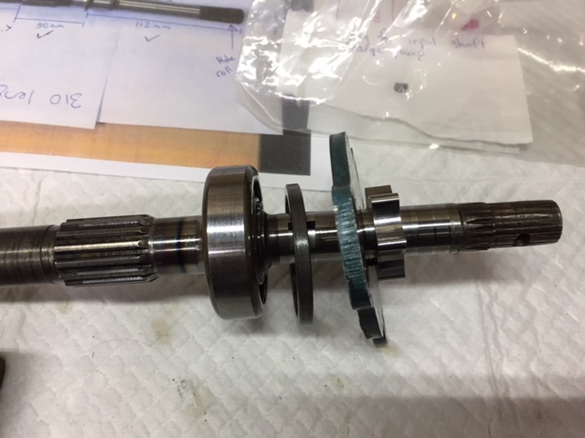

Input Shaft replacement
As I said, you do not have to disassemble the entire HST to replace the input shaft.
Here are the steps to remove the input shaft, but first set up a spotlessly clean work area. You must not get any contamination into the HST. If the system will allow I will post some photos of the following steps.

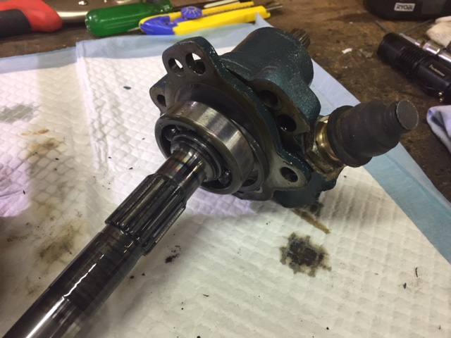

1. Remove the circlip, gear, bearing and 2nd circlip at the rear of the input shaft.
2. Undo the 3 hex head cap screws that hold the charge pump onto the HST. The charge pump is the housing thing that the input shaft goes into on the front of the HST.
3. With a plastic mallet carefully tap the rear of the input shaft and the input shaft with charge pump and a bearing will come out the front of the HST.

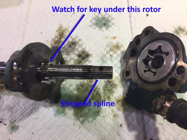

4. As you do the next step to take the shaft out of the charge pump I recommend you take pictures as you get it part way out, then again when fully out. You should work over a flat, clean work area as a keyway can fall out.
5. Make sure there are no burs or protrusions on the front of the input shaft.
6. You might need two people to do this step. Hold the charge pump housing with the shaft horizontal (very important) and tap the front of the input shaft. The shaft, bearing, spacer, plate, pump rotor, key and maybe some other parts off the pump will come out. If you are careful as you pull it apart you will see how the parts all go together. Hopefully you will not end up with a pile of bits on the bench/floor.
7. You can now slide most of the bits off the shaft. Watch out for the half moon key under the pump rotor.
Also watch out that the other bits inside the pump don't fall out. I tied and taped groups of parts together in the order they came off, then sealed them into clean ziplock plastic bags.
8. I replaced the input shaft and the bearing. The bearing is a standard 6304 (no seals) that presses onto the shaft easily and is also located in place with a circlip.
9. I also replaced the oil seal at the front of the charge pump and the oil seal at the rear of the HST. They are standard size seals. I didn't replace the o-rings where the charge pump joins the HST.

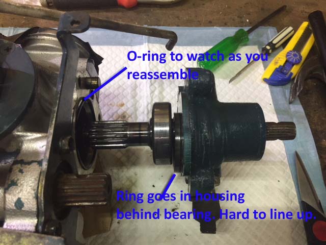

10. Assembly is the reverse but the first trick is to get the shaft and all its bits back into the charge pump without the key falling out of the pump rotor. It took me about 5 tries to get it right.
Most important that you do not force anything together. It is all precision machined and should slide in by hand.
11. The second trick is to get the charge pump and shaft back into the HST without the shaft/pump assembly sliding apart and bits falling out especially the key.
12. When you get the shaft back into the HST there is two things to watch for
a/ the spacer next to the 6304 bearing must be lined up with the hole the bearing went into. It easily gets out of line
b/ the large diameter o-ring between the HST and charge pump housing are easily knocked out of place.

Searching the internet it seems stripping this spline has happened to quite a few others.
It is a pathetically small shaft - the spline is about 19mm (3/4 in) OD
The tractor was running a 1 meter (3ft) wide rotary hoe when it failed. We had only recently bought the tractor. We had driven it around the farm a bit, but this was the first time we put the machine under any real load. We found that someone had put a bolt in place of the roll pin so suspect the spline had stripped for a previous owner and they had put the bolt in as a crude repair. :thumbdown: That's the risk we take buying older used equipment - but even after adding the parts costs in it was still cheaper than buying from the used tractor dealers.
The stripped spline was on the HST input shaft where the coupler joins from the clutch/engine end. According to an engineer who looked at the possibility of re-splining it, it almost certainly failed due to lack of lubrication on the spline, and subsequent wear. There is no easy way to lube any of the splines in this area.

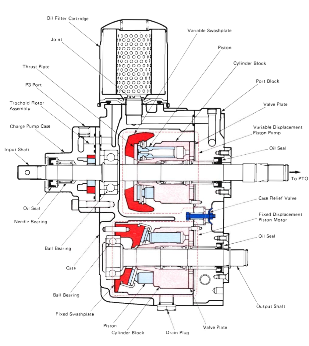

Hey rockyroadnz,
Just in the off chance that you see this, I wanted to say thanks. Your instructions have been a big help.
I'm just having some issues removing the input shaft. I've disconnected the bolts holding the Charge Pump Case on, and can pull the shaft out an inch or two, but that's as far as it goes peacefully.
From what I understand your instructions are saying, it's just supposed to come out the front. Do I just need to pry it out?
Looking at the manual, it looks like there are gears and things attached that should prevent it slipping straight out, so I'm a bit cautious.
And here's the diagram image I'm referring too. Any help/advice would be much appreciated.
