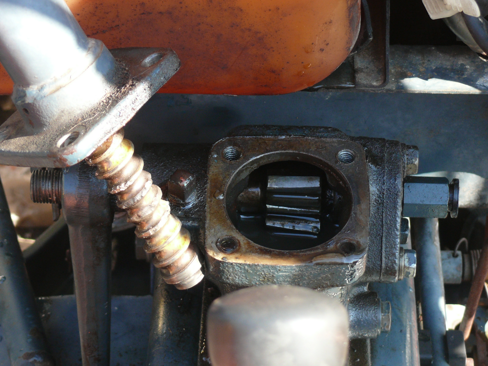

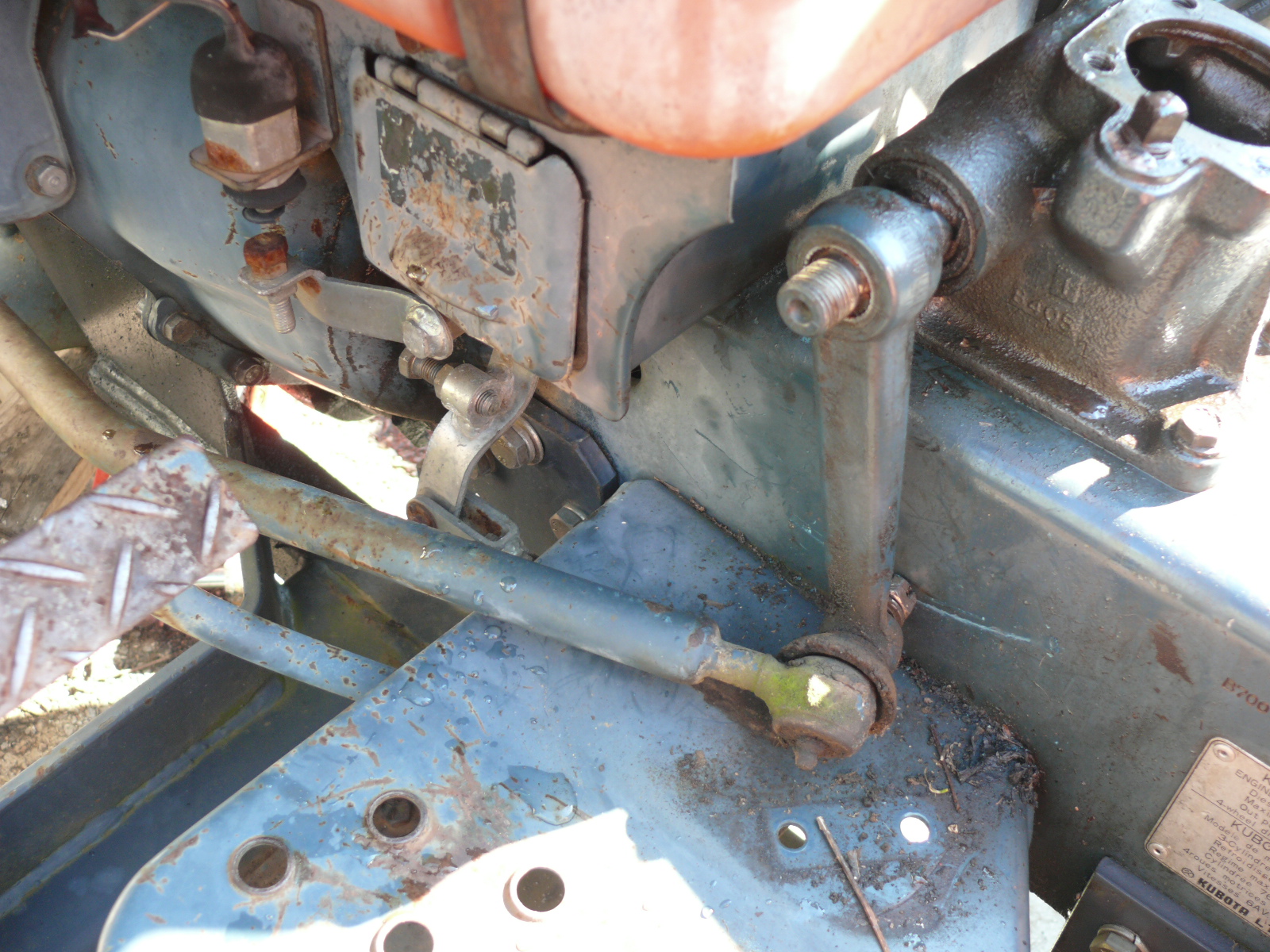

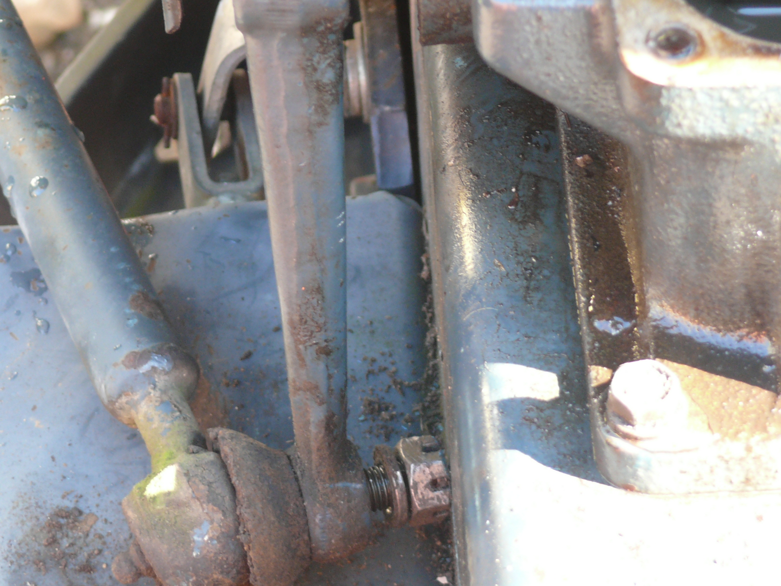

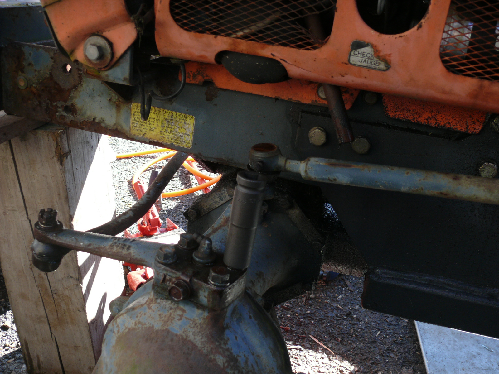

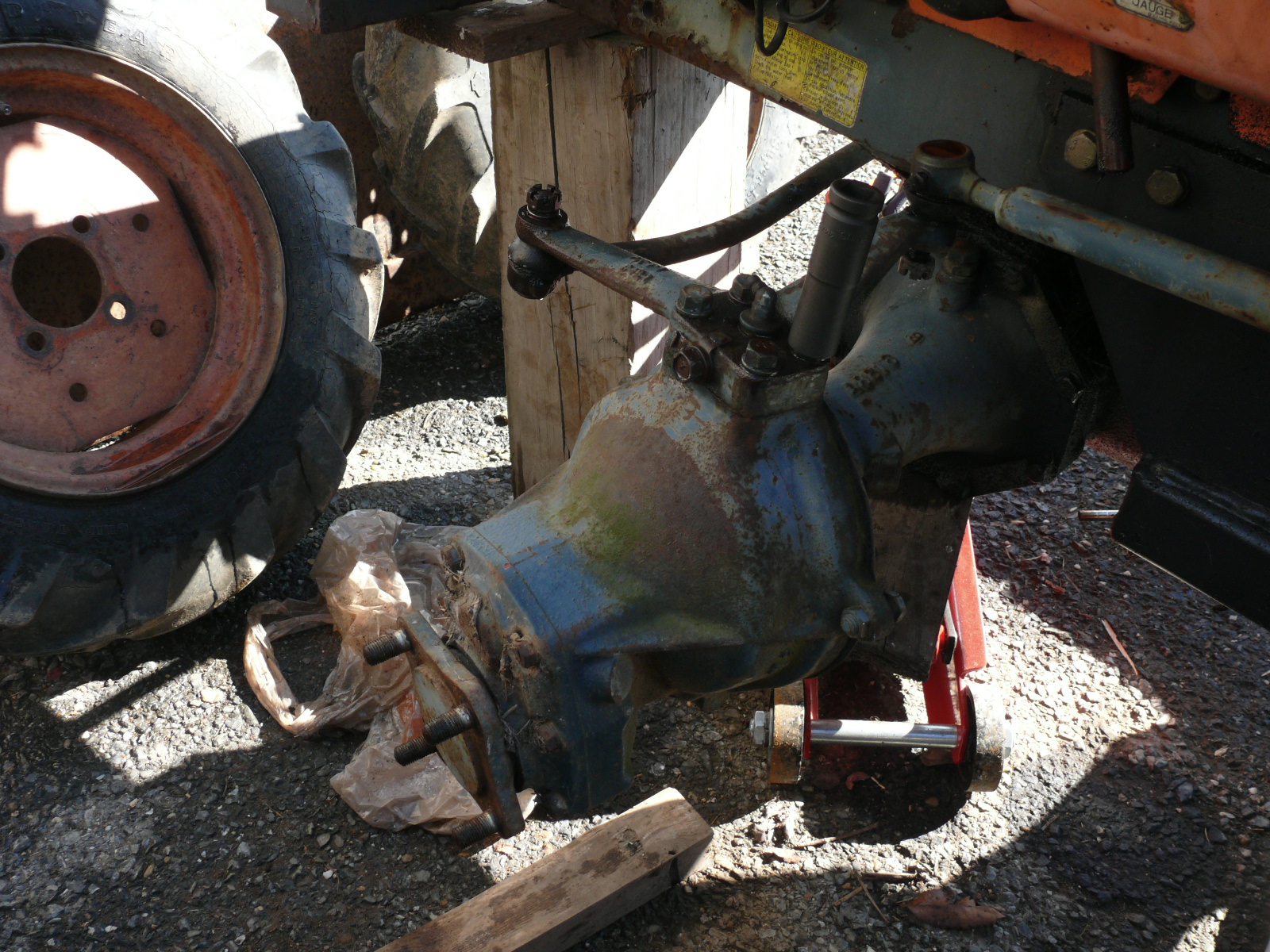

I hit a snag....
I can not get the assembly to go down far enough in the steering box to bolt it in. Been trying to figure it out for 3 hours! Every new part I have is the exact kubota replacement
I put the bearings in bottom of steering case they fit right in the hole in the bottom then I put the race
Next put the other bearing on the top with race on top of that slides down shaft and fits into groove but I can't get it to go down all the way
Gotta give up for the night:... Maybe someone knows the trick to getting it back together or can give me some good advice
Thnks
