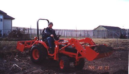

   / B7500 or B2410 for me? #15
I was thinking about this today when I was stuffed under the panel of a Citation jet and took a moment to day dream. I thought perhaps Kubmechanic could answer whether the 302 is suitable for the 7500. Yes, I am told it fits but is it "to" strong? If the loaders are matched to the tractor and designed so as not to over stress the machine then perhaps is this why the 302 is not recommended for the 7500? It might exceed the limits of the 7500?, this is just a question--may be way off base--is not a call to arms for 7500 owners. If the 302 is a suitable match for heavy work on the 7500 future 7500 purchasers may wish to take advantage but if it might overstress the tractor or bend it's frame or other damage!! also, will it void Kubotas warranty to use the 302? You see, being upside down under a panel causes blood to flow to the brain and thus these brilliant flashes /w3tcompact/icons/wink.gif . Curious minds wish to know.
J

   / B7500 or B2410 for me? #17
The 302 is suitable for the 7500; it's what I have. It doesn't void the Kubota warrant.
Fits and works fine; put alot of hours on it last summer
