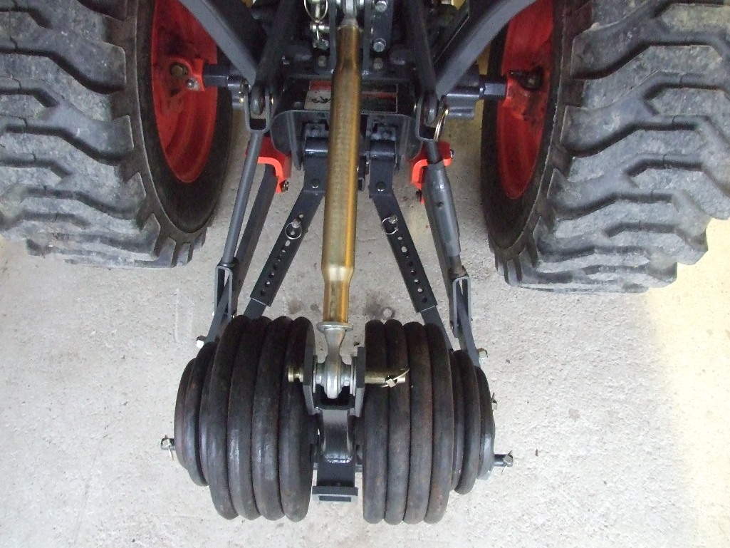

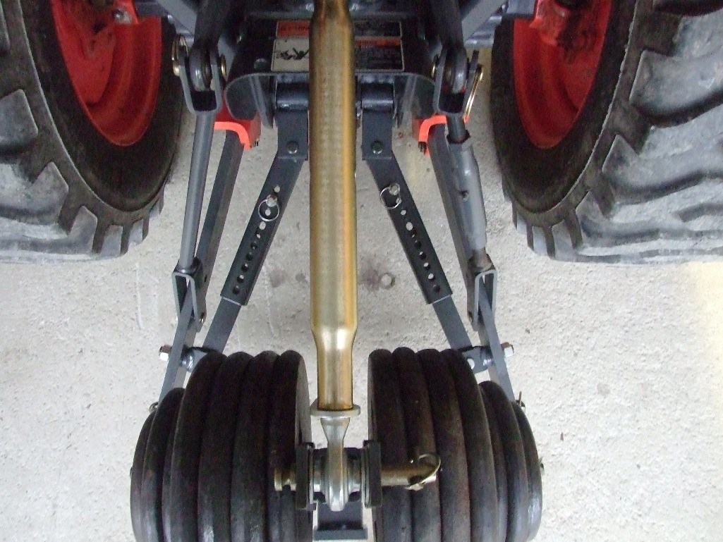

This weekend I installed the 2nd best part mod on my B7610 next to my Markham toothbar. I installed an extendable 3-point link arms / telescoping stabilizers kit from TractorSmart. It's all the parts from the B2910 IPL in a easy to install kit. I read the threads below a while back and had saved them for reference. I've wanted to do this for about a year and finally got tired of the turn buckles and wanted link arms that work in tension and compression.
3-Point Hitch B7800 Extendable 3-point link arms
B7800/B29xx Telescoping stabilizers
Ordered this kit from Tractorsmart.com. The kit shipped fast with all the necessary parts.
Telescoping Stabilizers for B series

So did you actually get the entire lower 3pt hitch arms that have the extendable links (like the B3030)? Couldn't tell from the pics, but I'd be interested to know more if you did. I've been considering doing that to my B3200 but the parts are about $500-600 as I recall.
