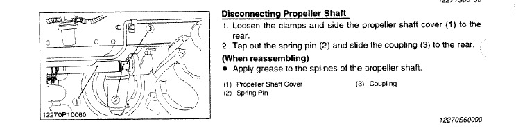

From the B7800 service manual.

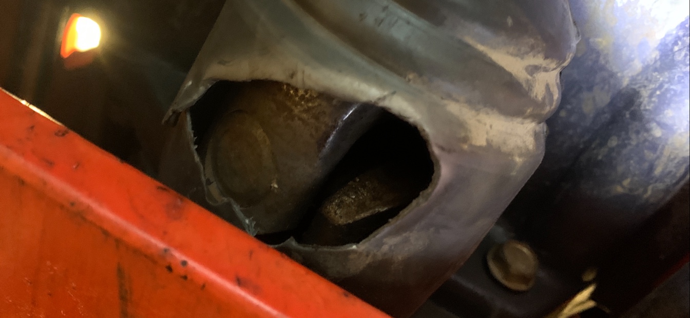

I just finished replacing a drive front drive shaft on a B7800. The dealer says you have to pull the tranny and the loader frame (at least 12 hrs labor) to access the u-joints in the drive shaft.
I took off the fender deck rubber hoping for an access panel but there wasn't one. At that point I was resigned to splitting the tractor until I remembered a 2 1/8" carbide holesaw I had which cut a beautiful access hole.
When you cut it, beware of the hydraulic line that's dead center on the point of the trans, so stay to the right and you'll be good.

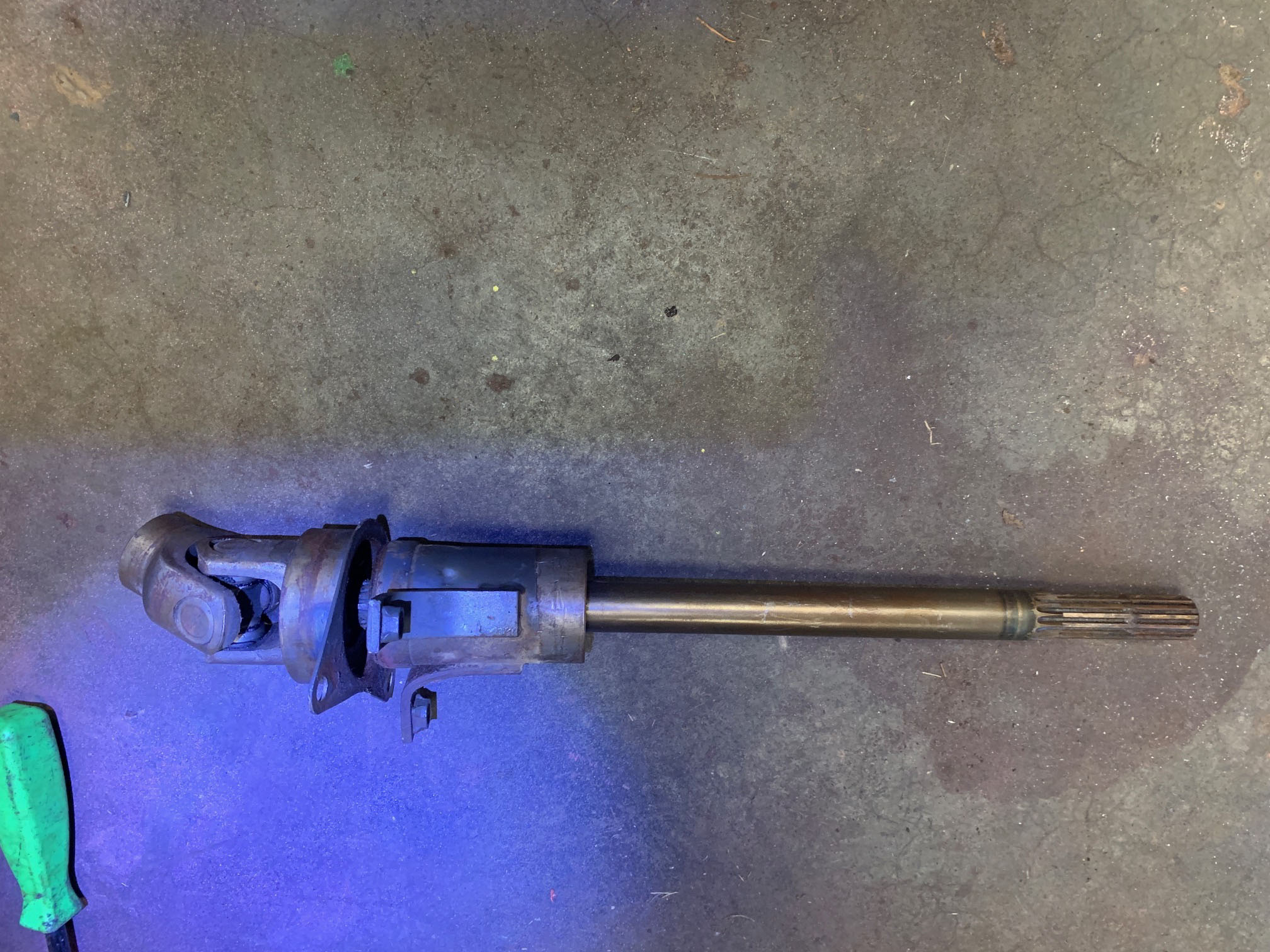

Actually I did that for my own benefit. Will post it here and save you the trouble...
B7800 front U-Joint Replacement
These U-Joints use double roll pins, drive the inner pin out and then the outer. Slide the U joint off.
Remove the entire front axle and drain it.
Remove the two 12mm center support bolts and other clamps to remove the lower shaft and snake it out the front.
Pull out the upper shaft and remove the U-Joint . I found my u-joints were still tight but their splines were worn, the upper shaft had at least an 1/8" of slop and the center U Joint ate the plastic cover. Now it's tight, no slop.
Use plenty of grease or never seize on the splines.

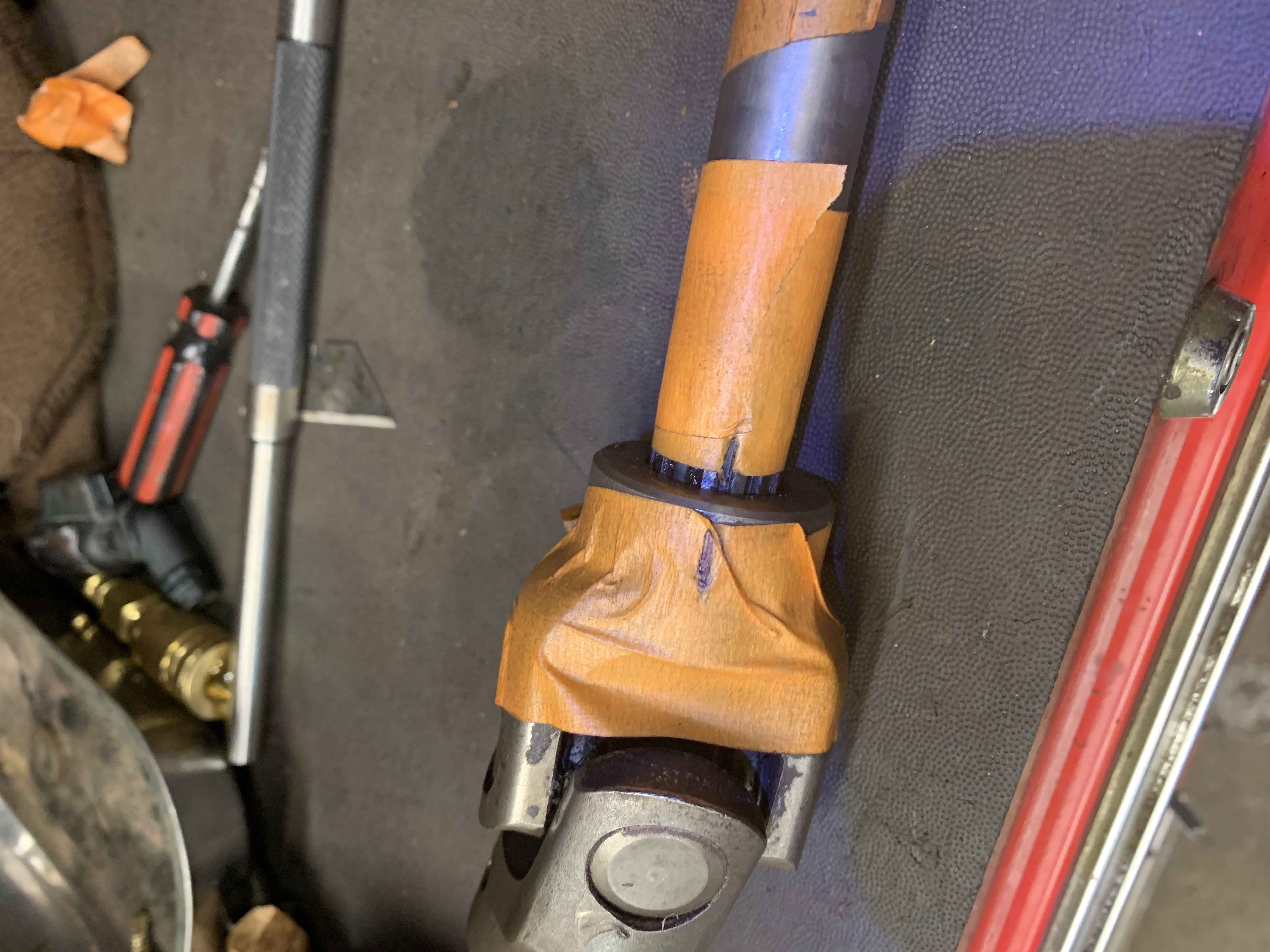

One thing that will save you massive frustration is that the sliding side of the center U-Joint is INDEXED!!!!!! Even though there is no indication on the shaft there is in the female spline It will only fit one way.
Put the new upper U-joint on and slide it up into place. Connect the sliding joint and get the support ready to go back.
Move the whole thing back and connect the trans.
Install the two carrier bolts and put the rest back together.

Thanks for the edit. I'll try and post some pics. It says they'll accept PNG files (it's a genius apple thing). Anyway I have some pics.
   / B7800 4x4 2007 how to remove front drive shaft #8
No luck with photos, I can email them to you and you can try to post them.

I see you figured out the picture thing. :thumbsup:
The pictures showing the position of the hole you cut will be very useful to someone trying to do the same thing in the future.
What is going on in the last picture with the vise?
