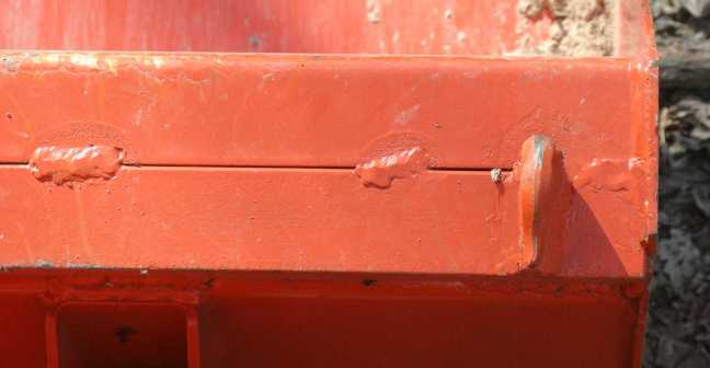

Is there any good way to mount a hook on top of the bucket for a B7800?
I have had them on my other tractors and used them all the time pulling fence posts etc.
Thanks!
   / B7800 54" bucket / 60" bucket ?? #6
I always recommend the hooks being in the center and with some type of reinforcement across the top of the bucket to keep it from bending.
   / B7800 54" bucket / 60" bucket ?? #7
Here's how I put hooks on the bucket of my B7800. Steel angle reinforcement across the entire width, a grab hook on each side and a slip hook in the centre. Other folks have different setups. And you're right, they sure are handy.:D

Can you possibly post more pics of the way you reinforced it?
The HD bucket on my Grand ‘L’ was never an issue but the B7800 bucket is 1/2 the strength and weight. Reinforcement will be critical.

I have the 60" bucket and have used it a lot in the past 10 days to clear the 40" (6" last night) of snow that has fallen. I am happy that I have the extra 6" of width for clearing all the snow.
I had hooks welded onto an L beam at each end of bucket top. I didn't want one in the middle of the bucket as I plan on having a grapple installed there in the spring.

   / B7800 54" bucket / 60" bucket ?? #11
I reinforced the whole top lip of my FEL bucket. A piece of 2 x 3 angle iron...1/4" thick. Hooks and such welded to the angle iron instead of the bucket material itself.

   / B7800 54" bucket / 60" bucket ?? #12
Buster57 - I don't have any more detailed pics of how I reinforced the bucket, but I think it's the same as Sully2 did it. Wushaw did a real sturdy mod using the drill pipe; the angle brackets for his 3 hooks are mounted in the same position as my full width angle. I used 2" x 2" x 1/8" angle, because I had it on hand. In hindsight, I sometimes think I should have used a heavier section, maybe 3/16" or 1/4" thick (although I've done some pretty serious lifting and haven't bent anything yet).

It meets my expectations-high vibration and all. I will wear thick socks...
As for the bucket reinforcement, I like your solution better then Kubota. I have a friend who is a master welder . I will pay him to look at your pics and be creative. I only want one center hook but I want it to be REAL strong.
