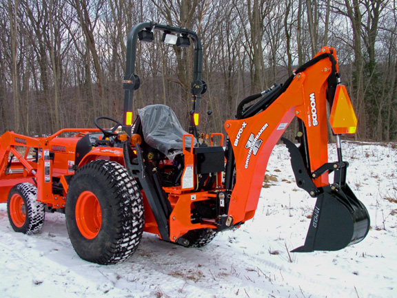

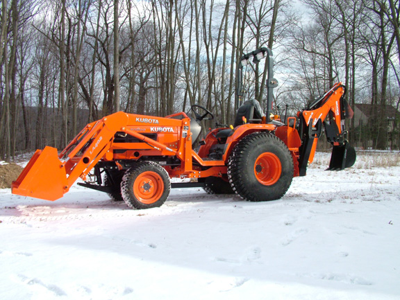

The BH-70X is nicely balanced on the B-7800 and it does the job very well. I had to dig down to 6 feet a couple of times and it did the job with the bolders we grow here in CT. Also go for the mechanical thumb, it makes the BH that much more versitile.
See the attached displaying the Woods BH-70X with the 4 point subframe attachment vs the 3 pt hitch.

Thanks for the pictures nice set-up. What size bucket do you suggest for digging stumps,planting shrubs and cleaning out ditches?
Thanks,Doug
/ B7800 Backhoe #7
Thanks,Doug
I have the 12" bucket, however, most people on this site prefer the 16" bucket. My limited use the 12" has served me well.
