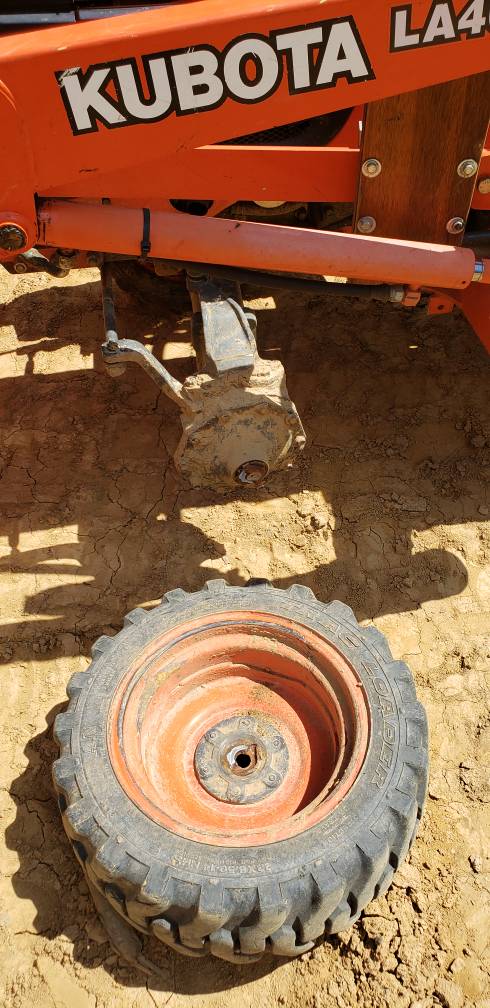

   / B7800 - Busted Axle at 441 hours #119
The rear tires were filled by my dealership when I bought it new, so I don't consider the rear ballast inadequate.
I'm not going through this entire thread but I have to say that rear ballast is for Traction and is useless for offsetting FEL loads. To do that you need weight BEHIND the rear axle, something heavy on the three point. I'm not surprised that if you were lifting any considerable weight and moving about with the tractor, crack go the axles.
   / B7800 - Busted Axle at 441 hours #120
Just saw this post. Happen to me as well. View attachment 612575
Now isn't it interesting that the photo shows a near match for the failure in the original post. That is, over half the failure happened some time ago as witnessed by the rusting pattern.
That suggests that the real failure happened and was not regarded as a significant event. Then, when the wheels fall off, the owner is puzzled by the seemingly innocent circumstances. The fact that the other side stub axle is cracked also furthers the point.
I'm with crazyal in his post #69 of this thread. It's not a casting, the break could have happened under much different circumstances than the ultimate failure. Also, I don't hold the maker at fault. **** happens.
And to the dealer's suggestion to just run loaded rears, that shows how infrequently such failures actually occur. But the internet being what it is, every failure gets LOTS of exposure.
At $300 for parts to put it back to right, I say the issue is out of proportion to this thread length ;-)
