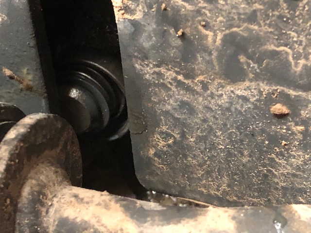

/ B7800 neutral centering problem
I replaced the bearing a year or so ago and I well see if I can find the wright up tonight. I think I had some pictures too.
This is what I am dealing with. Access is almost impossible.
/ B7800 neutral centering problem #5
After looking at you picture I went and looked at mine. I took a die grinder with a burr cutter and made that slot bigger at the bottom and was able to get off and on real easy. I think you have to move the foot lever back or fwd.
I found your previous write up and it looks like what I will do.
/ B7800 neutral centering problem #10
I should posted before but forgot, you can kick me in the a== for not doing it. The the 6801 is only $1.95 from big bearing.
