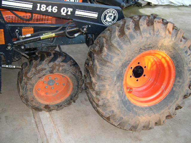

Yes, I switched to R4's a while back. I had turfs. The back rims were too wide for R4 or R1(which use the same rim). So, I got the back tires on rims form my local Kubota dealer.
For the fronts, the turf rims were the correct width to work with R4's.
It has Goodyears on the back, and Titans on the front.
