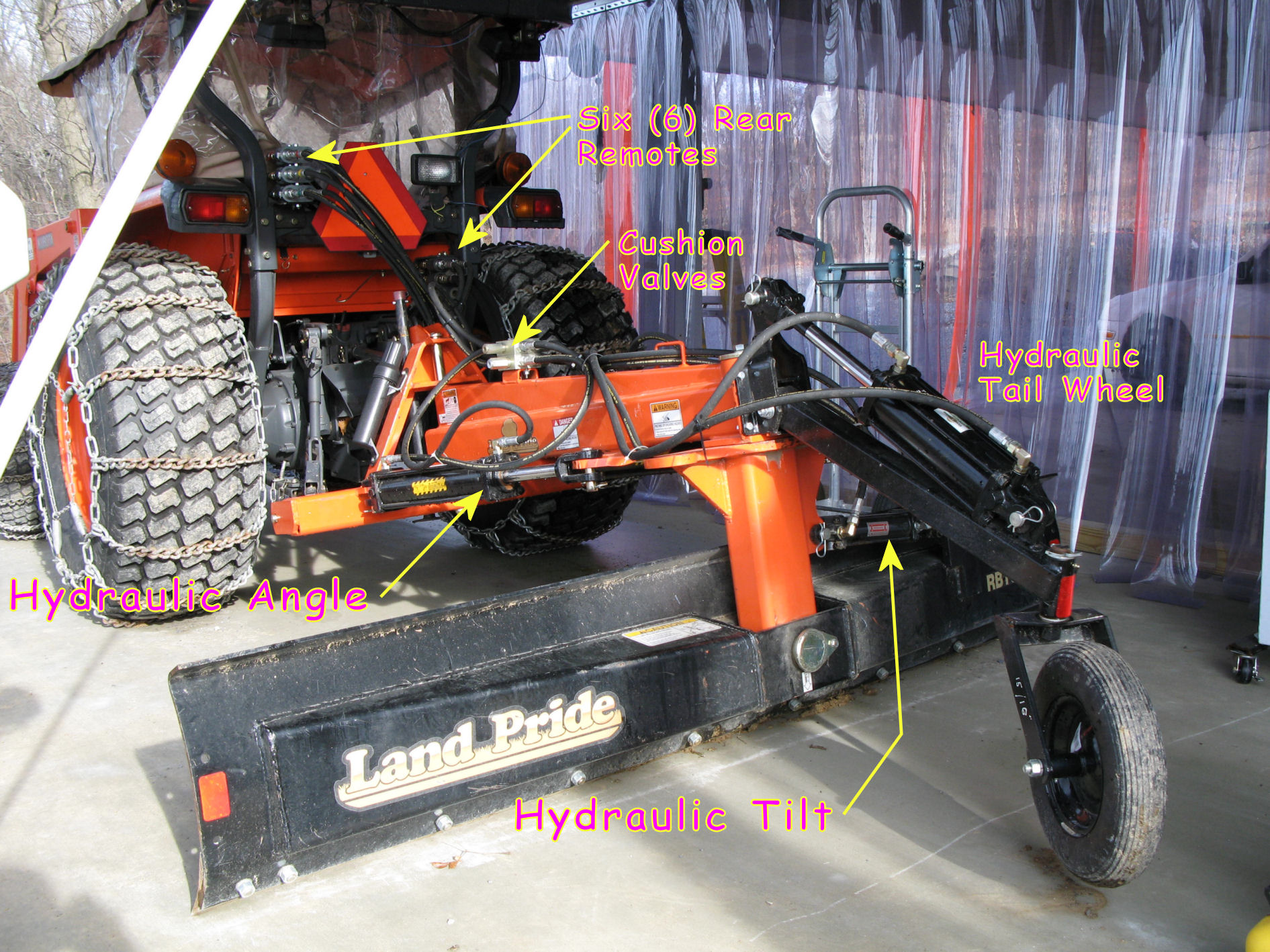

Landpride RBT35 series, 8ft. ...the pic says it all

Incidentally, on the landpride blade, above, I have the toplink set up with a swinging toplink (HF) to permit the blade to respond to the "commands" of the tail wheel more easily.

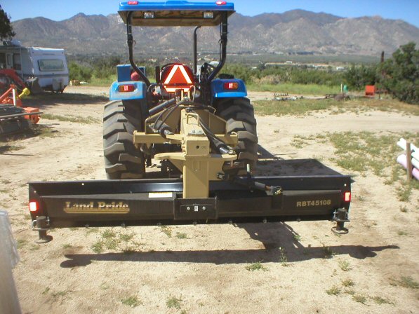

Someday I would like to get an RBT3584 for my smaller tractor. I am a cheap skate though and will stay with the skid shoes like I have on my RBT45108 instead of the tail wheel.
Have you found that you use both the "TnT" tilt along with the blade tilt?

do I use the two tilts (3ph and blade tilt) together? ...only for serious ditching
