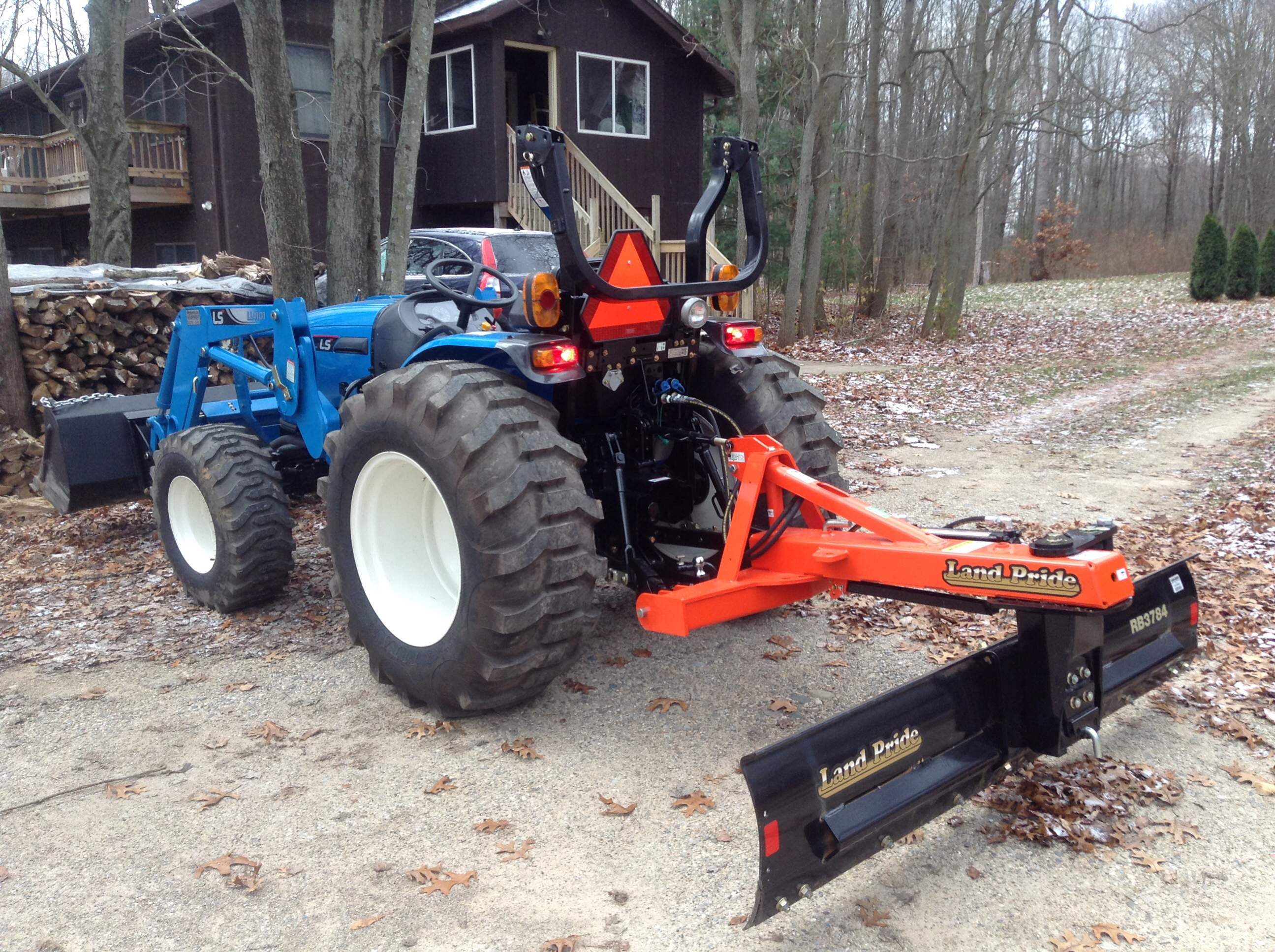

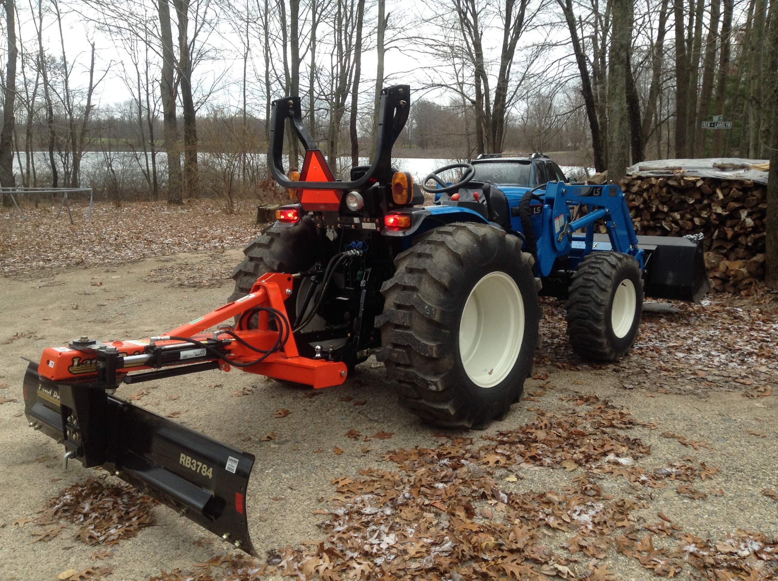

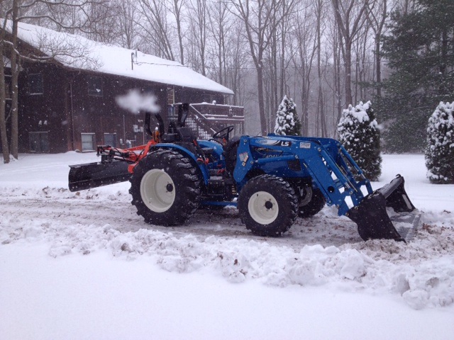

I bought a Land Pride RB3784 rear blade with the hydraulic angle kit ($275) this fall and i really like it for plowing snow. I haven't plowed any dirt with it yet but I'm sure it will be good. It is a 7' and if you want to reverse the blade u have to pop the cylinder off and lift it over to the other side, (not a big deal) I haven't had the need to do it yet. It is a nice heavy blade (630#)

LP's economical RB that you can get hydraulic angle on is the 37 series. Bad design though, you have to move the cylinder from side-side whenever you reverse the blade. :thumbdown:

Is that just a 37 series thing? I'm pretty sure on my 40 series it has a mounting hole for the cylinder on both sides, so you can disconnect the rod end, turn the blade, and reconnect using the other hole.

Look at post #23. You will see what I mean and he even mentioned it. Yes I believe that it is a 37 series thing only.
