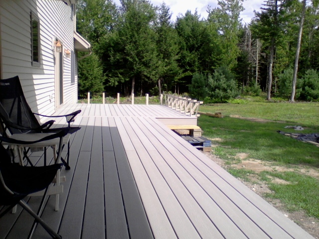

Deck Boards finished!

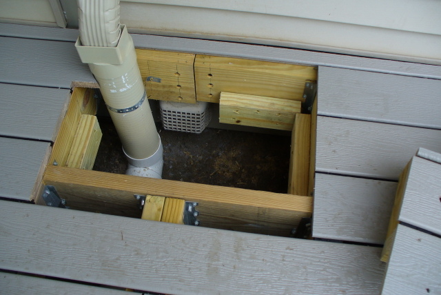

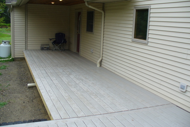

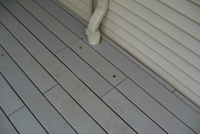

Today, I finished the last of the deck boarding.:) The first photo shows the 8' x 28' portion, which was the last completed. The second photo is a close-up of my hatch, for access to the dryer vent. The third photo shows the opening with the hatch removed. The fourth photo shows the framing of the hatch.
Due to a miscalculation (mentioned in an earlier post), my boarding came out a little different than I had planned when I framed the hatch. It came out usable anyway. It should serve its purpose.

   / Back Deck #32
DennisFolsom said:
My 8 year old grandson asked me if I was doing something to keep the bugs from coming up through the cracks in the floor. I had thought of it already, but I was impressed that he thought of that on his own.
What are you using to keep the bugs from coming up through the decking and will it affect snow drainage?
Asking because I have a front deck project looming.
Thanks

   / Back Deck
#35
Thanks
I bought some grey fiberglass screening in a 48" wide roll. I stapled it to the joists with a hammer tacker before laying the deck boards over it. I only put the screening on the section that's under the roof. I will be building a short wall, so my screen "windows" will not extend floor to ceiling. Also, the "screened porch" portion is in the corner between the house and garage, so it's somewhat sheltered from wind and blowing snow. Time will tell how much snow we get in there. If we get much, I'll be shoveling it out through the storm door that will be installed between the screened section and the open section.
The gaps between the deck boards are about 3/16". I think it should drain well enough.
