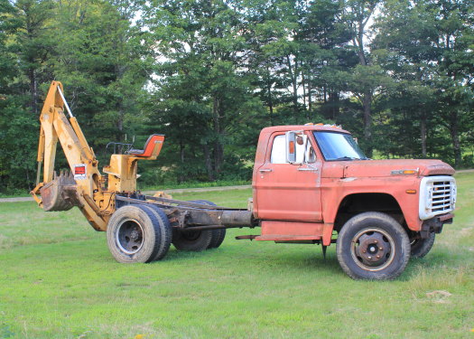

When I was a kid, I remember seeing several truck mounted backhoes... they were almost always in cemeteries. Similar to this...
I like mine ;)
Though it's arguably "tractor" mounted, truck in appearance.
Get's to and from the neighbors at up to 84km/h though, pretty fast for a backhoe: 1977 Unimog 46 "Bagger" drive-by - YouTube
Mount/dismount in about 10min if you've done it once or twice, to mount, just backup to the backhoe, plug in the hydraulic hoses, use the stabilizer legs to adjust height, the bucket arm to adjust depth and fine tune into the Unimogs rear implement mount brackets, install the upper pins (or upper and lower if you want to use it right away), and fold it into the box. Get to the job site, unhook the two stablizer bars (for high speed transport), fold down, put in rear pins, and get digging.
Also makes a great anchor to hold the Unimog in place if you use the front winch to recovery a very large truck out of the ditch :)
