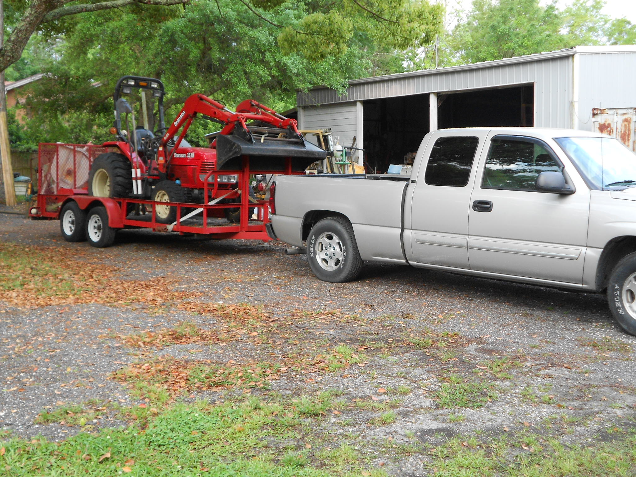

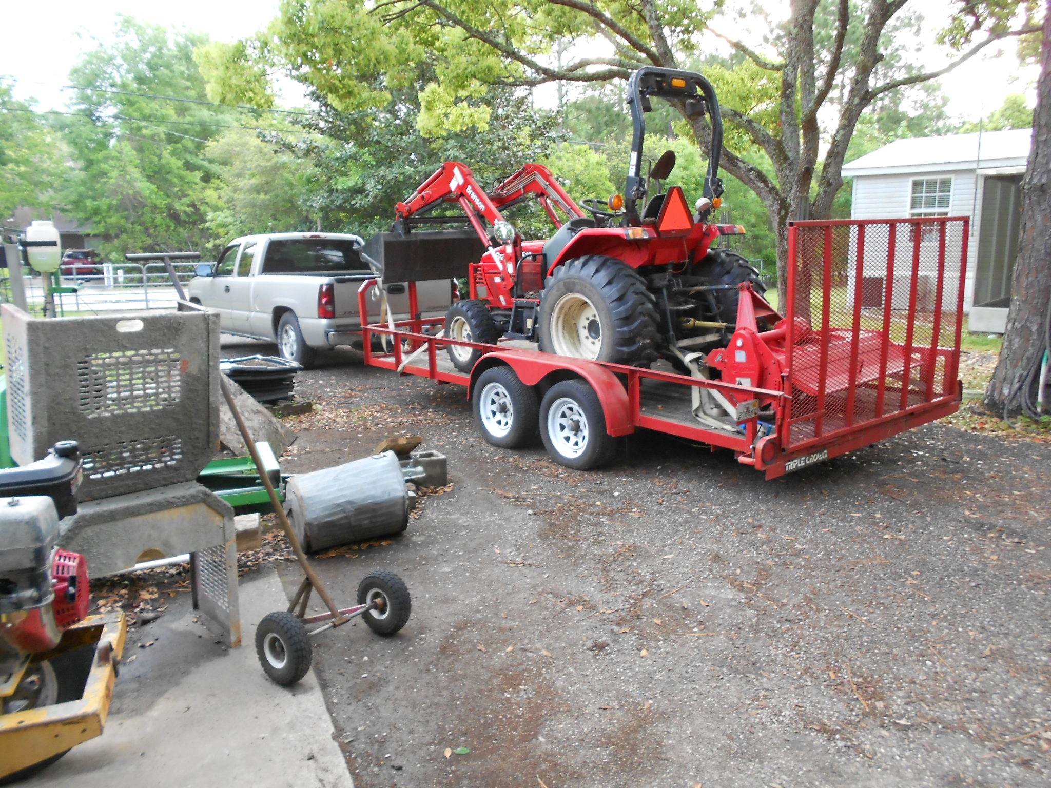

I just load for proper tongue weight.
Here are pics loaded for a 50 mile trip to my property.
