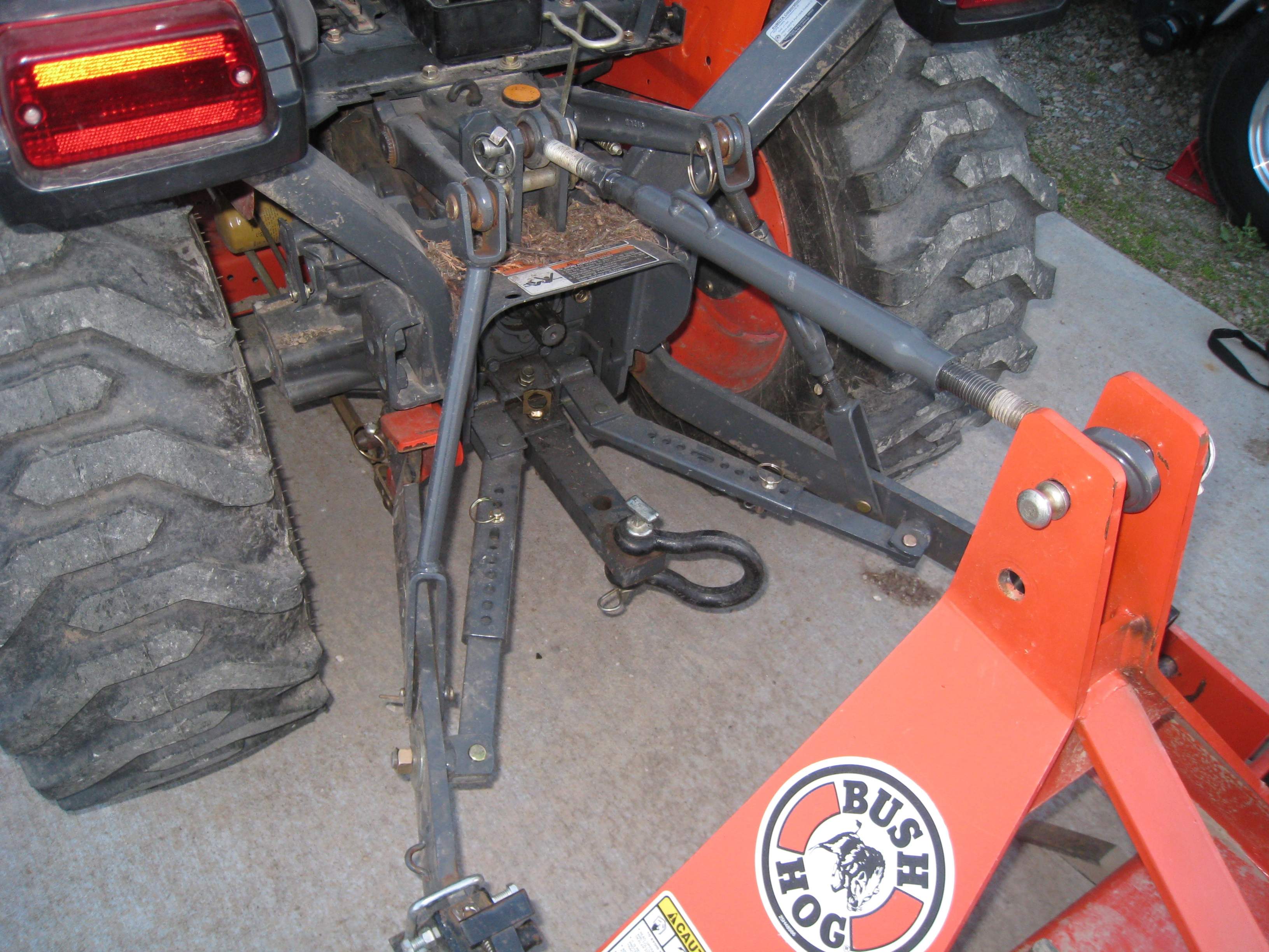

Below is a picture of telescopic stabilizers like what rus_geek is referring to. I recently switched my turnbuckles out for these. This is the system used on the more upscale Kubota than mine, so was a direct replacement. They adjust easier which makes for easier replacement of implements and I like them because they hold the lower lift arms at a set spacing even with no implement on. Before mine would swing in as soon as the implement was removed. In the picture you can also see I use the Pat's quick system which makes the switching of implements a very easy task.

Those look pretty cool and a lot better than what I currently have.
Where can I get that? How much is it?
   / Backblade problem #19
I ordered them through tractorsmart, but as I mentioned they are Kubota specific and I'm not sure if they would fit yours. They were $200 delivered, so more than I would want to take a chance on. You might try checking on the Yanmar forum section to see if anybody has ideas. Or do a web search. The reason I posted the picture of mine was so you would know what Rus_geek was talking about by telescopic stabilizers. If you can find them that will fit yours and you have to replace what you have anyway, even if they are more, they are an improvement in my opinion.
