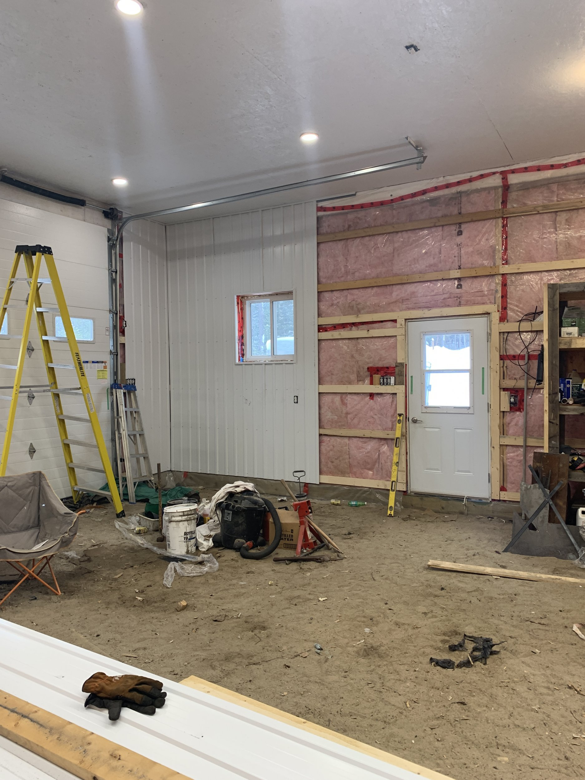

Drew, I’m getting ready to pour a slab inside my pole building as well and had some of the same bought you’ve had.
Sorry not a great pic but you can see I ‘boxed’ (3sided) around the bottom of the posts with pwf. The top of the lumber will be top of the slab. The pocket between the skirts as you fall them is insulated with foam, to insulate the slab edge with about R20. Outside i did like you and used metal flashing. It’s nailed on with roofing nails and goes below the skirt board a few inches into my sandy soil/fill.
I’ll insulate the slab with 4” of eps foam. I’m in a cold zone.
Gotta figure out how to insulate the 12’ wide door opening edge of the slab yet, lots of info and debating with a google search.

I used angle iron to form a threshold for my garage door, I then insulated the inside of the threshold with foam. I could only do inch thick foam there, but am hoping it is enough of a thermal break to keep most of the heat in.

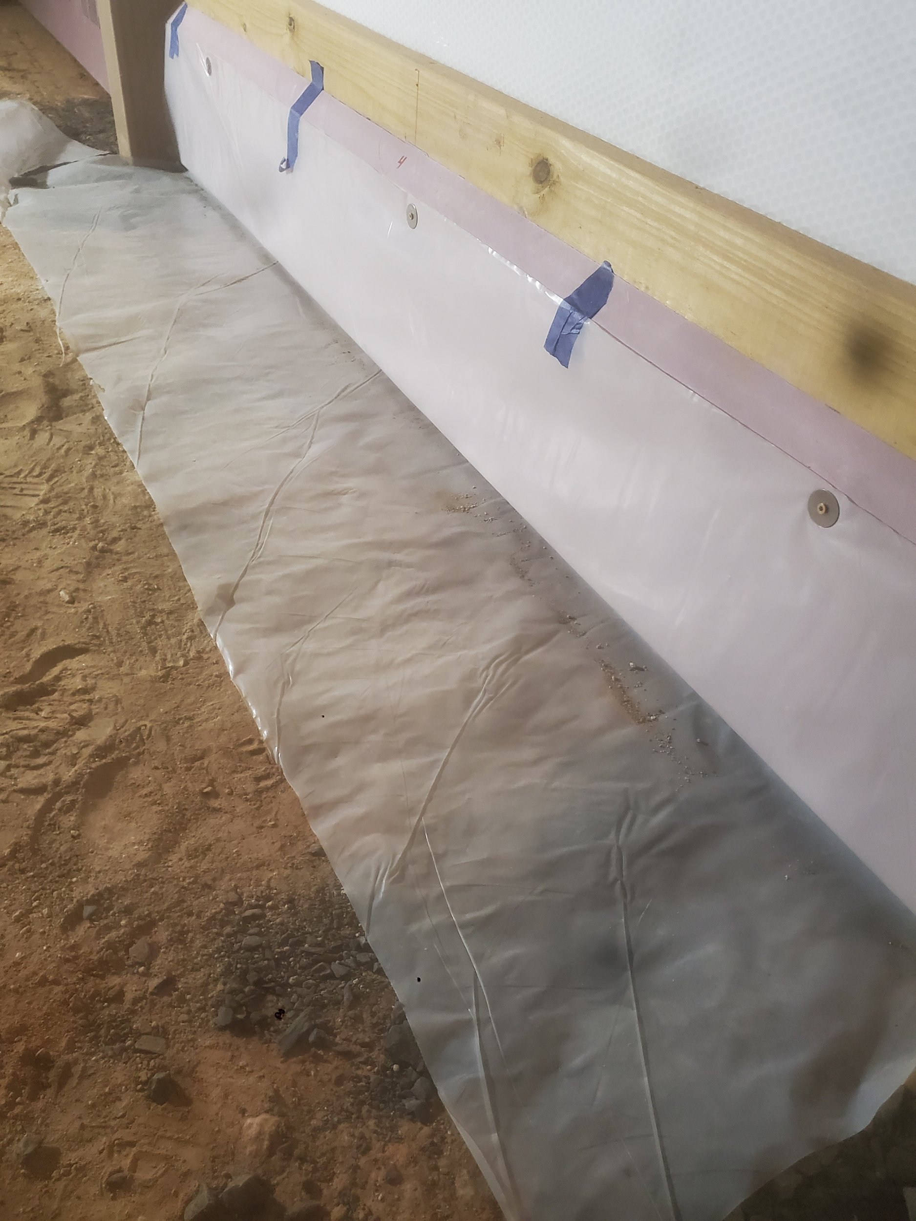

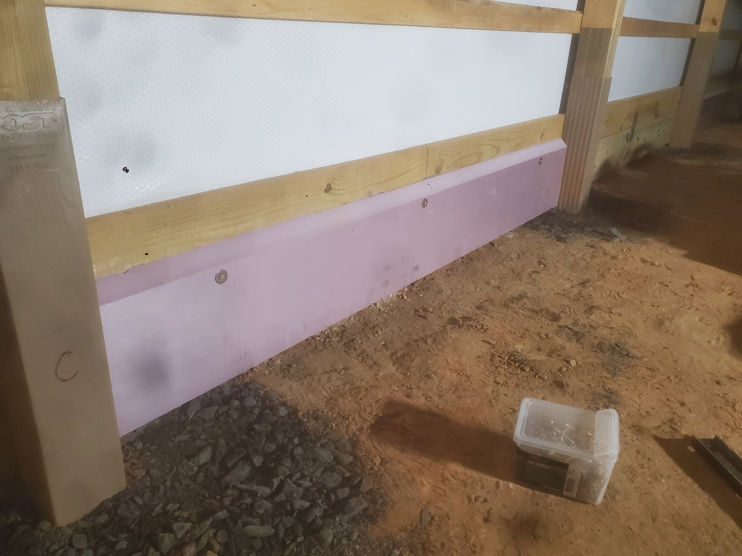

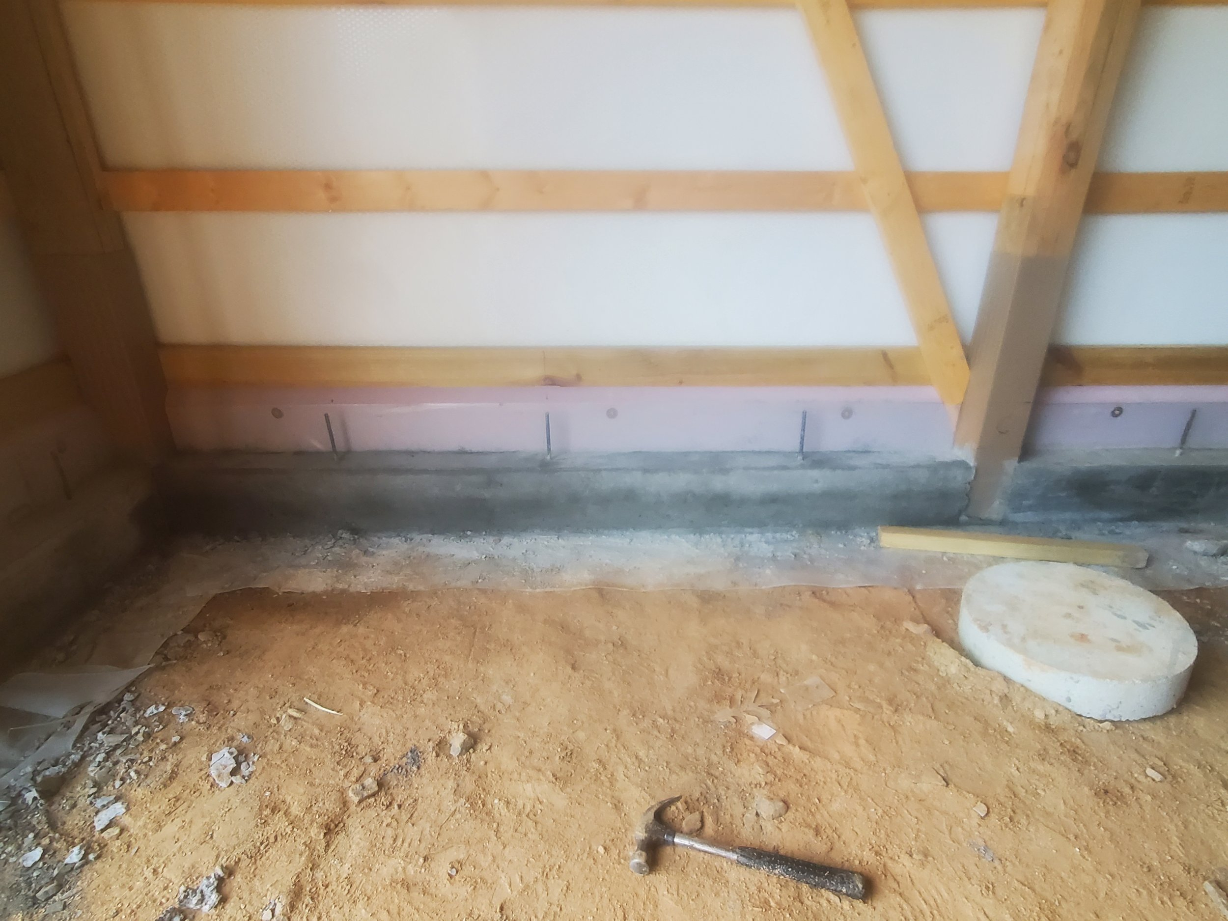

Long story short I have been blown off by 4 or so dirt guys to help me with the fill work. Had 100 tons of crusher delivered and another 20 of #57. Also had 4 quad axle loads of cheap dirt for outside of barn dumped off. You guys are gonna roll your eyes at this but I decided to move forward pouring the rat walls I previously talked about, haha. My wife said it was a sign that these guys kept blowing me off and just knock it out. We had a warm spell last week and I have all walls finished except five but plan to be done this week. 21 bays total in this barn. Each bay took a little more than (3) 80lb bags and its been pretty exhausting prepping and mixing and pouring and troweling and all that jazz by myself but its almost done!
Here is what I did:
- Set up my rotary laser to mark the top of the future concrete
- Measured down 5" and marked a line on post since I plan on going with 5" concrete.
- Measured down 2 more inches and made another mark on post since I'm going with 2" of foam or at least allow option to
- Recompacted and smoothed sandrock between each post with hand tamper
- Ripped 1.5" thick foam with 45 degree beveled top and attached to skirt using deck screw and fender washers
- Cut 6mil plastic and laid up against the foam and down and out
- Cut a **** ton of 3/8" rebar @ 16" and 18" inch length and pounded down 3 per bay with tops ~1.5" below future concrete surface
- Used 2x8 or 2x10 ripped down for form boards.
I apologize for the horrible pics (phone camera is barely working) but shows the sort of work I'm finishing up.
